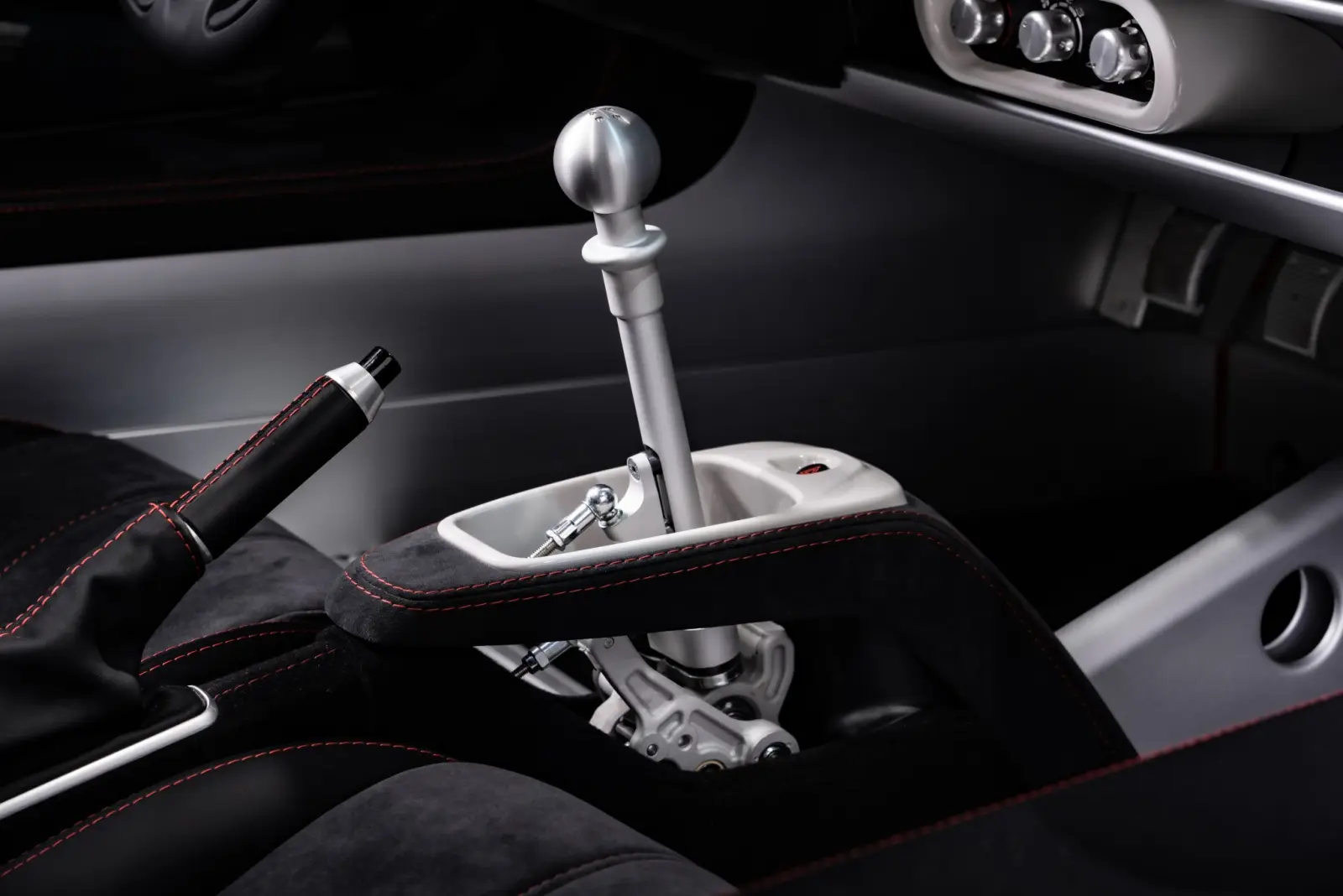

I had @Aerie looking at a solution to open it up like the later Exiges, but the shape under the gaiter doesn't lend itself to a clean solution. The entire shifter surround would need to be redone. It would be truly awesome to open it like that, or to put a minimal shift gate over the opening, but I'm not sure how it could be accomplished. The gate would be easier anyway. Just measure the path of the shifter through the gears

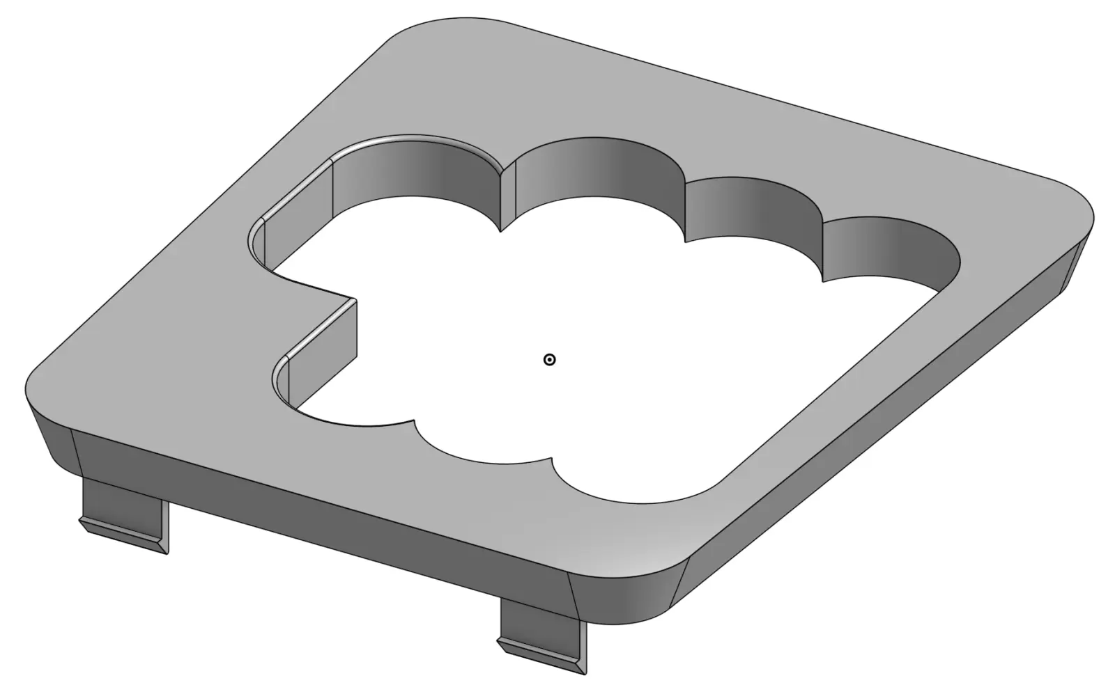

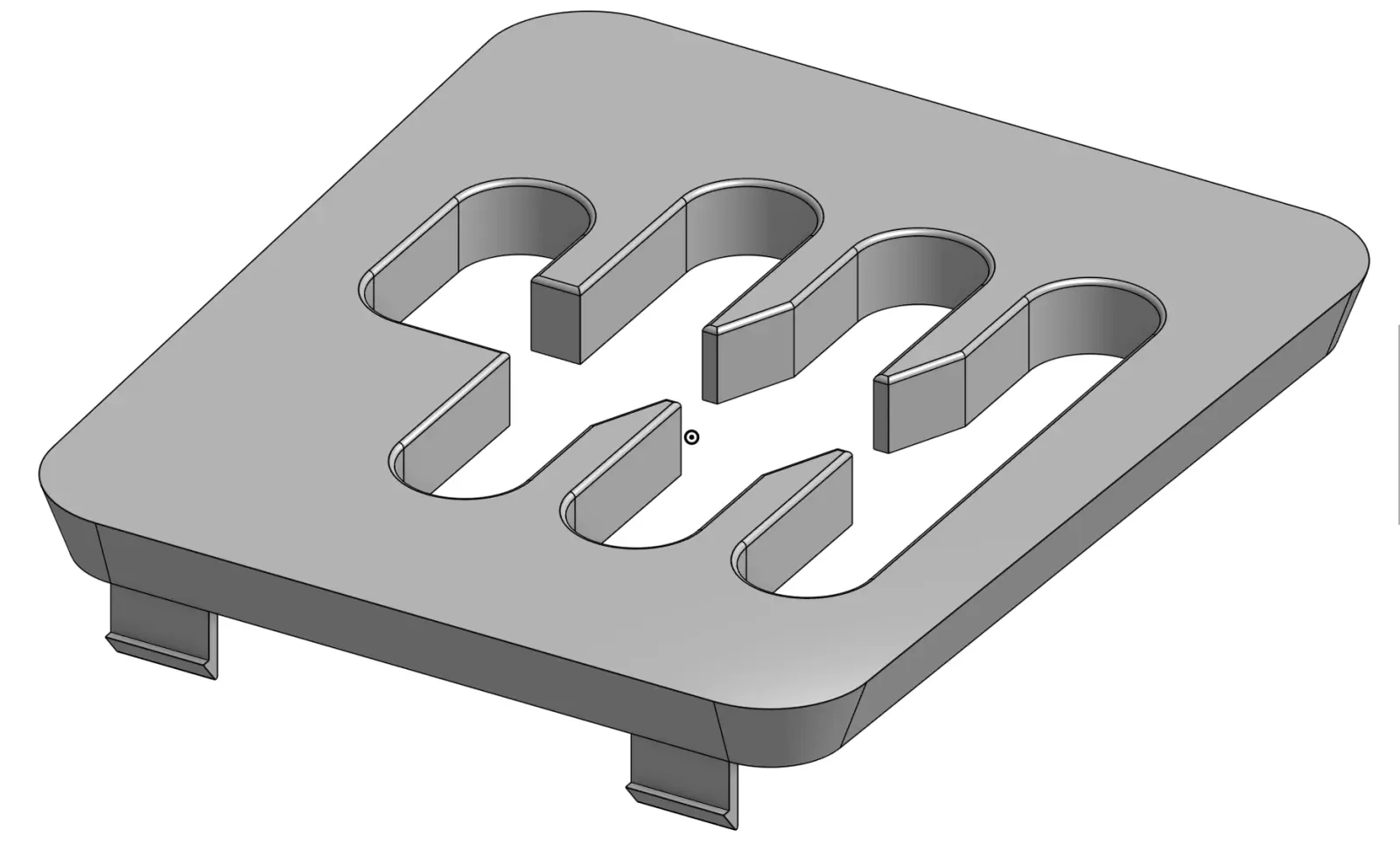

To help visualize why this would be so difficult just have a look at the shaft thickness, there's an inner shifter and an outer reverse tube that thickens it.
Instead of a shift plate that could clip into the existing top like this:
You'd be left with something like this:
Mockup I modeled here are dimensions that just theoretical to explain and not representative of the Emira.
