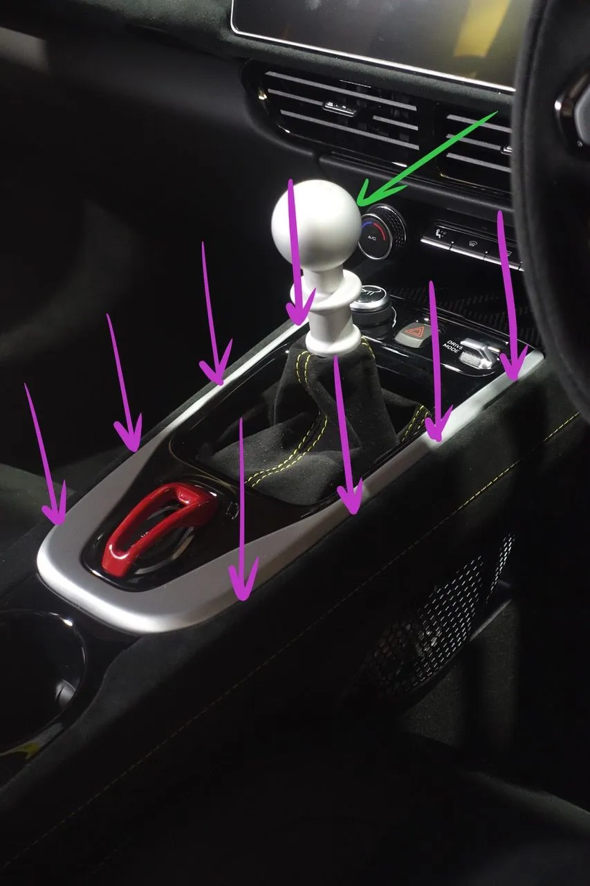

Can you (any of you) take a picture once you have it out, and put the trim ring back? Really interested to see what it looks like without the leather boot in place.
The picture above is from @JonFuller's car and can be seen without the arrows in his DV journal.
