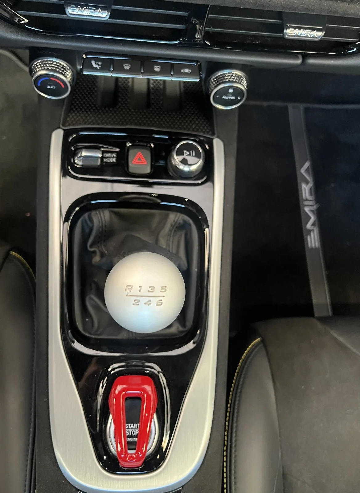

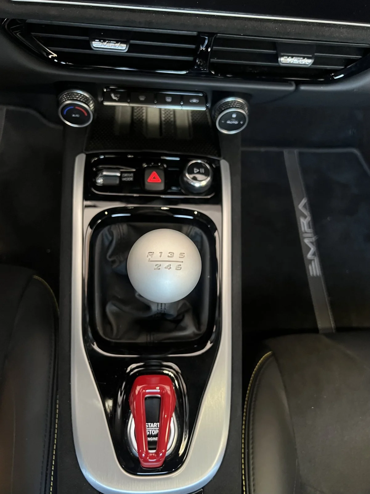

Yep I moved my neutral position when i did the install too. Here is the before and after
After adjustment

My neutral position definitely moved. I figured that was normal. So where do I need to make the adjustment? Is it the position of those two nuts that get snugged together?

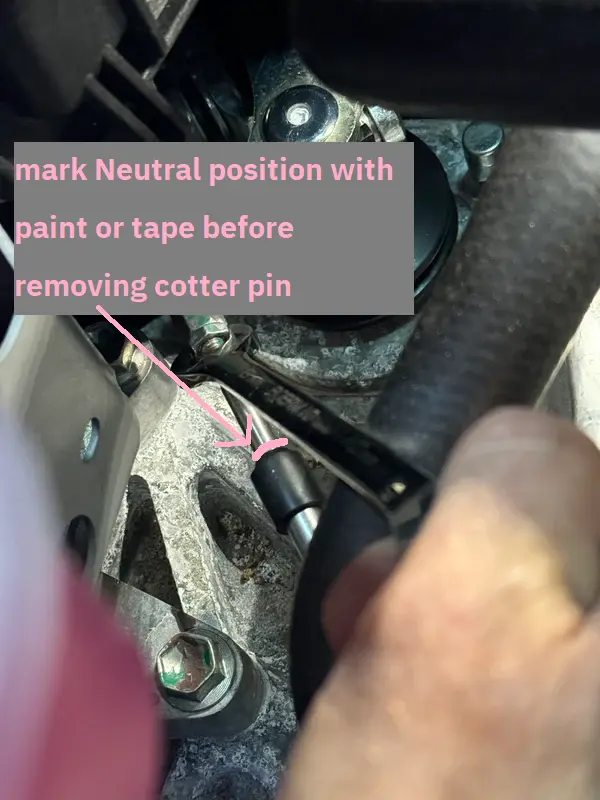

Because mine sat too low, I had to unscrew the nut that is on the rod end, remove the bell housing and then move that rod forward and you will visually see the shifter moving (through the glass in the middle of the car). Once it’s in the right spot reconnect the housing making sure you don’t move the rod backward

So, for anyone attempting the install, would this be a good way to ensure the rod hasn't moved? And don't forget to remove the tape (and paint?) when done.

I mean when I started to play around with the gears I kept screwing up what gear I was in. Was not used to neutral being that far down so I figured something was off. Not sure if it has any mechanical disadvantages though. Maybe @kitkat does

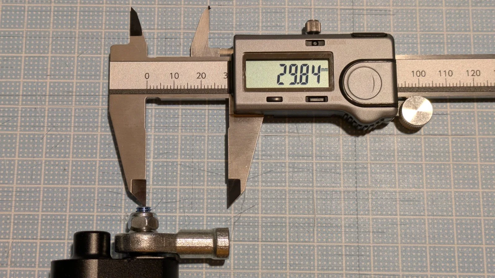

My thought was that the length of the center of the eyelet to to end of the threaded part (where you lock it with the squish nut) is shorter than the OEM eyelet. I don't have them side by side to compare at this moment, but if true, you would need to make sure to thread the new eyelet onto the cable just right (maybe not thread it in all the way?).
Anyone have measurements of the OEM eyelet? The GRP one is around 30mm.
It's not just the length of the eyelet, right? It's also how far the cable threads in.
Yes. It's the combined length from the eyelet center to the marking that I am going to put on the cable before removing anything.
