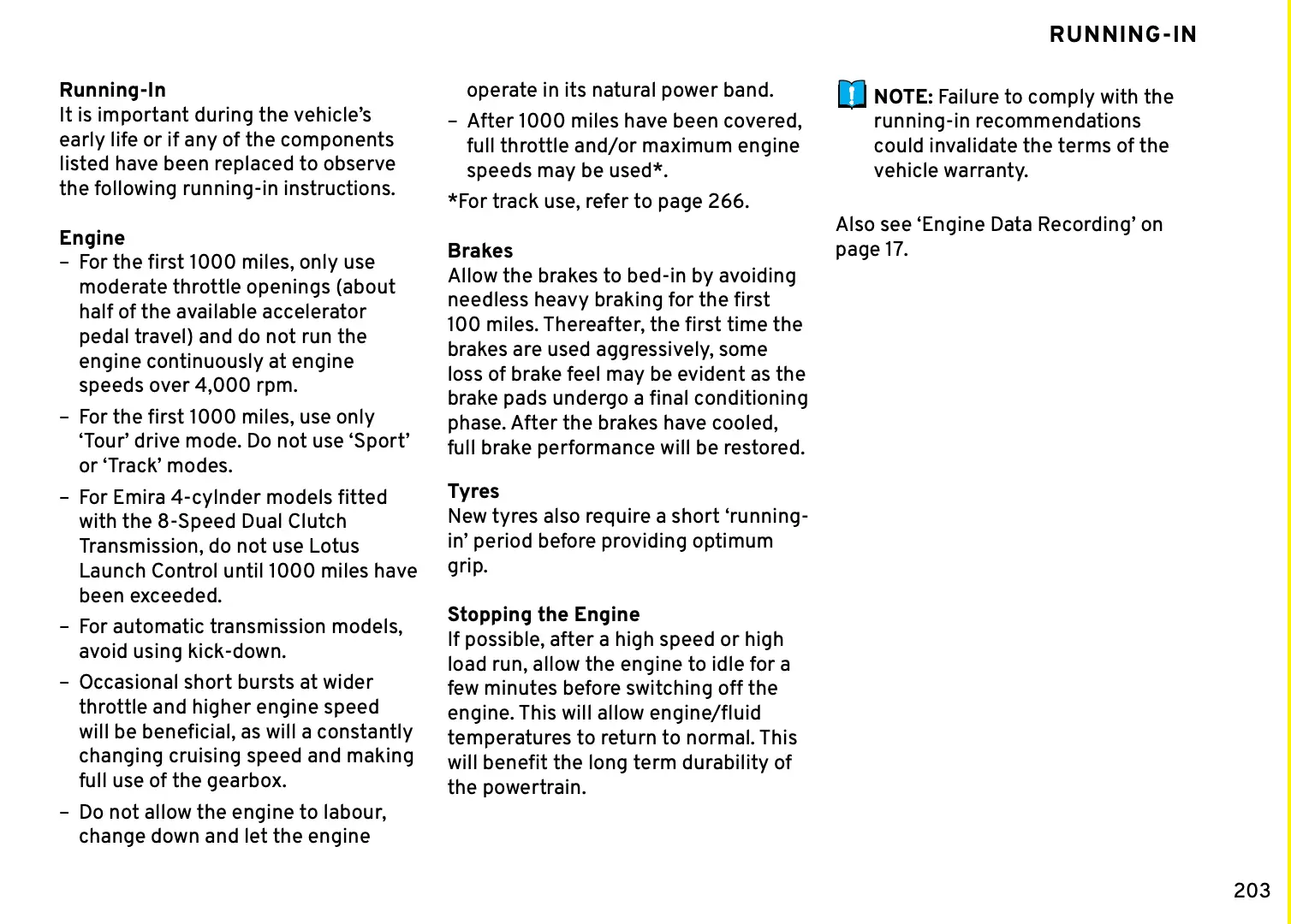

The dealer only mentioned the 4K RPM limit. They made no mention at all of driving modes and TBH this is the first I've heard of it. Where did this information come from? I went through the quick start guide just now and don't see it anywhere.
EDIT: Found it on page 203 of the owner handbook (which only seems to be found online and not actually in the car itself):
The dealer demos are certainly not limited to Tour for their break-in, and I doubt Lotus would void warranty on ex-demo cars, plus the fact that info is only found hundreds of pages in on an online document, then I won't be sticking to Tour only (although will be staying away from track mode).
I saw 2 things.
1. Occasional bursts are healthy. Just not sustained RPM over 4k
2. Idle engine after hot laps.
After break in- I’m a firm believer that redlining your car occasionally once at operating temp is healthy and keeps your car used to operating on full tilt. I never understood those used car buyers that didn’t want their cars redlined. Over revs are bad but redline? That’s what the car is supposed to do. In fact bogging the engine and always being in too high a gear I think is way worse for a drivetrain.
Also the idle rec makes me think of turbo cars. You definitely want to cool those down after hot laps. I guess the same goes for superchargers? I never actually thought about that.

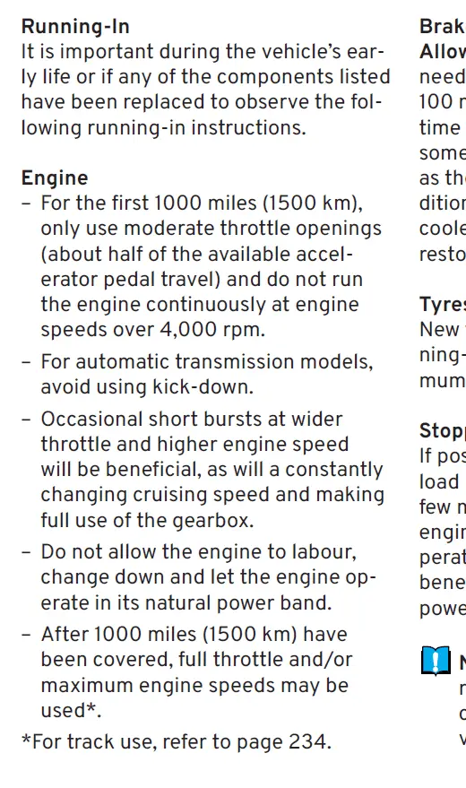

Older versions of the Handbook, and translations based on them, did not have that bullet.

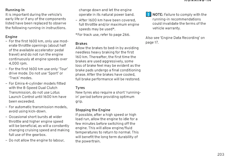

Exactly this is what we got last year as guidelines, the one´s I followed.
Actually mine (AUTO) I had it most of the time in Sport during break-in and in Manual Mode to have better control myself over the engine/throttle and avoid auto change by surprise, therefore the closer to you guys with Manual Trans
this was the version of the manual I got last year:
