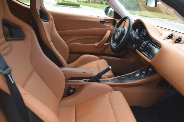

If not, the older Evora seats in Cognac might be a reasonable match for the Emira tan leather.

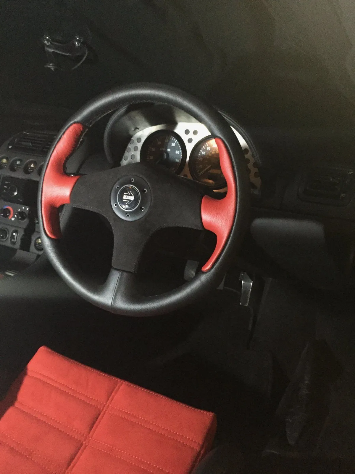

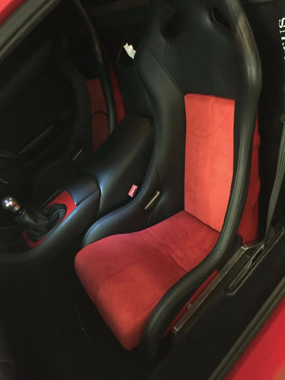

When i got the Esprit GT3 it had leather V8 Seats. If one was 24 stone with an arse the size of the moon then they might be ok but I was literally sliding side to side between the bolsters. They were so hopeless I had some clones of the Esprit Sport 300 seats made from scratch. Cost about £2200 for the pair 7-8 years ago (and a long drive to devon to collect em). They are similar to the lightweight ones offered as standard on the GT3 when new, painted back body colour.
Now these are completely the opposite direction and are a bit tight if one 'nuts' are not positioned correctly. Really comfy though and with a fixed back I have been on a big trip around Europe in it with no bother at all.

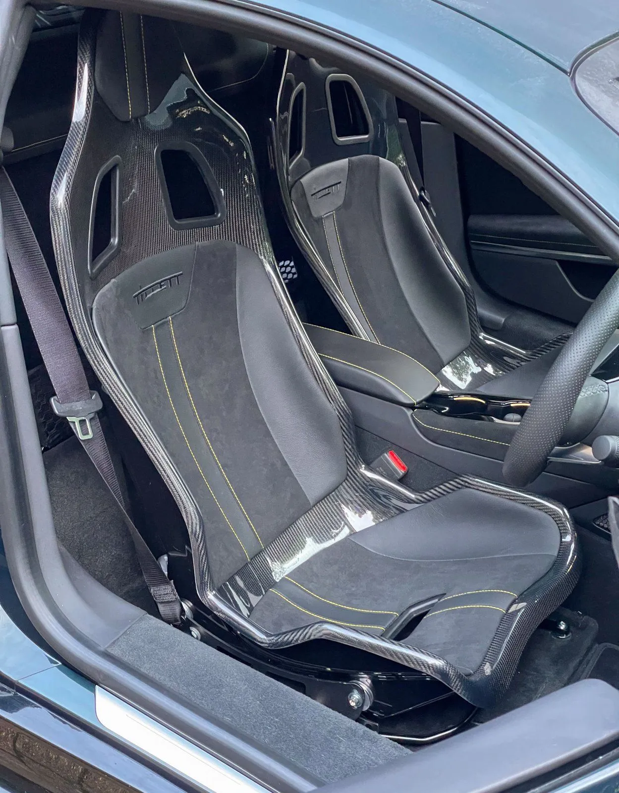

After much worrying about the electrics I finally just went for it and put a pair of my B10 seats in it. Other than a few lights on the dash no issues.
What a change, the car now feels more Lotus and less popping down the shops.

That looks so much better and I'm sure the lights can be coded out. I get why lotus went the 'comfy daily' route but they really should have offered an option for something 'more'.
The only concern I'd have is that I'd probably still need some element of adjustment for height and back angle for when the GF uses it. It doesnt need to be electric but just available so not sure a fixed bucket would work for me, unless I can convince her she never needs to use it😂

That looks superb, especially as it looks like the pads are a perfect match with the alcantara and yellow stitching.

Wow, these look great!! Nice work.

Are you the head of Tillet Racing Seats Ltd. ?

Can you say if the seats sit you noticeably lower in the car?
