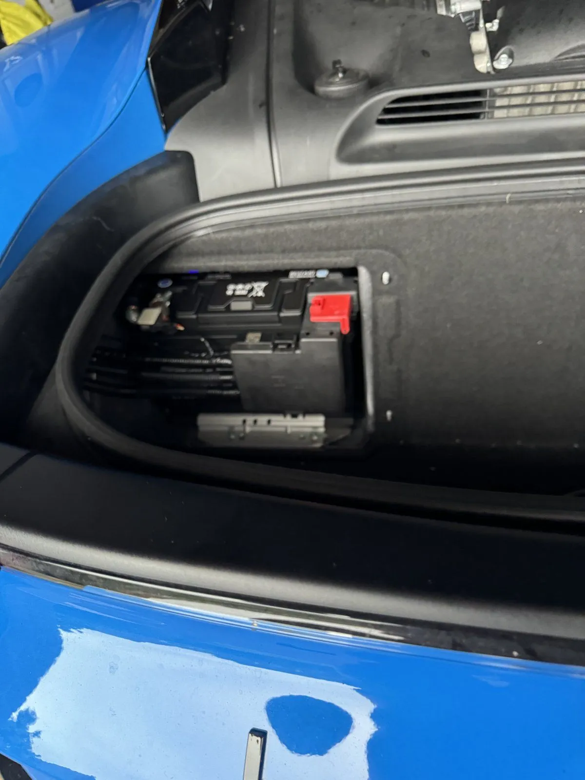

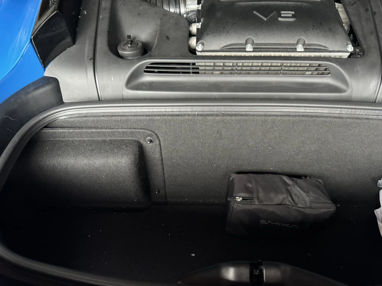

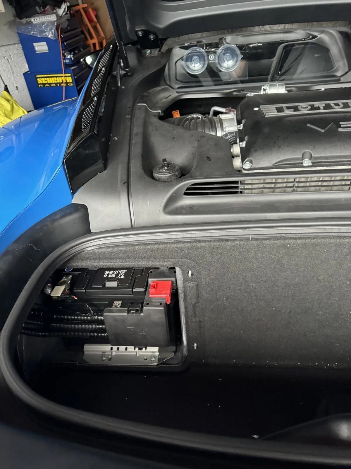

Can't tell from the blury pic, but does the lightweight battery allow for the battery bump in the truck to be flush with the rest of the compartment?
The “bump” goes fully back in place
