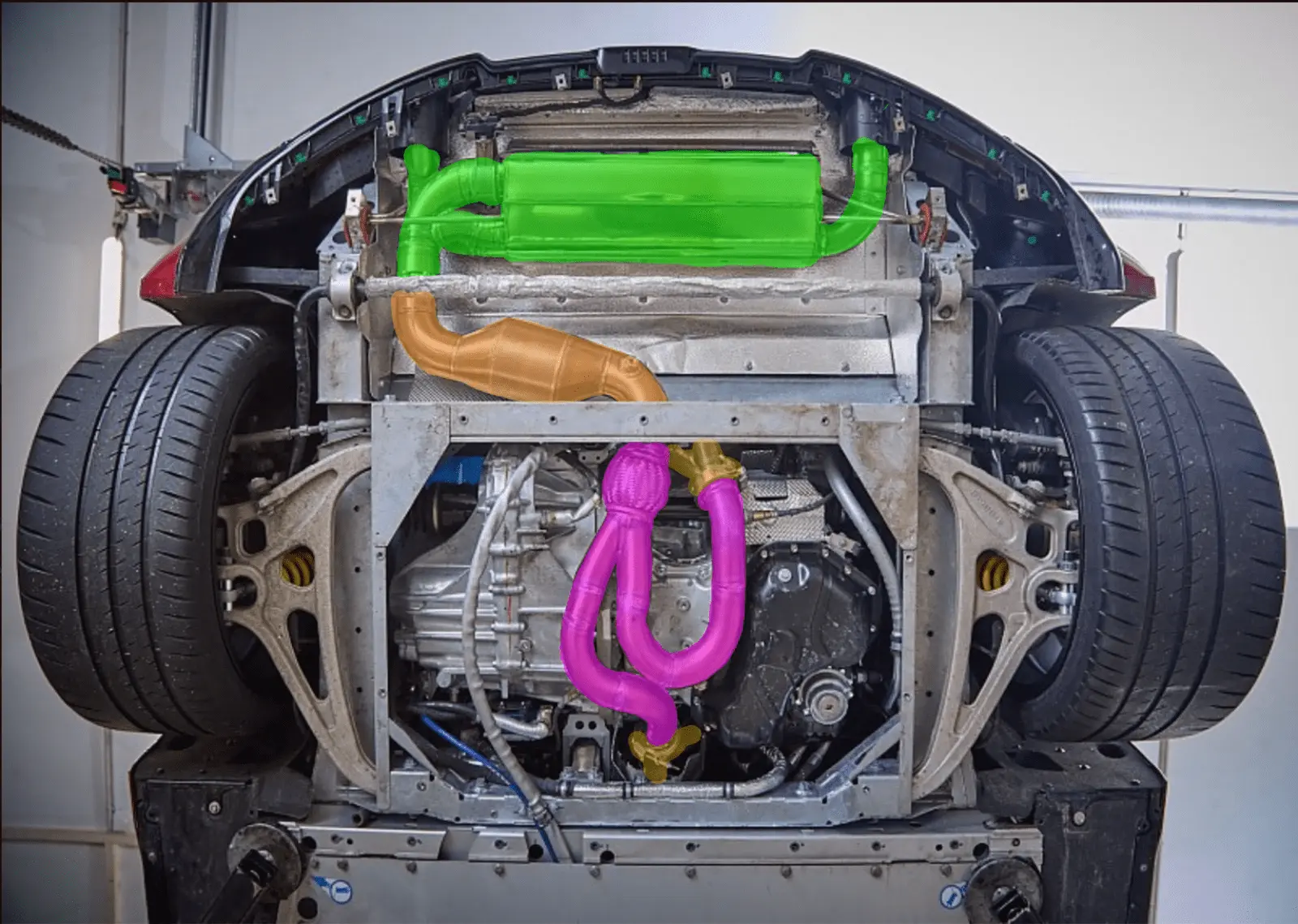

They are attached to the exhaust manifold. Most aftermarket headers for the emira I have seen don't have cats. You either run without or add a single cat where the 3rd goes.
Evora setup which should be the same/similar to Emira:
I am trying to understand where the 2 main cats go because on the picture the cat look like they are part of the manifold and the uprated manifold for the Emira don’t have a cat on them.
After driving mine for the last 2 days I think the Miltek exhaust with the gpf delete is loud enough and may be too loud with performance cats as well as getting th Y pipe and manifolds in the future.
Yellow: Aftermarket headers. OEM manifold with cats attached would go here.
Pink: Y Pipe
Orange: Aftermarket cat. This is where the OEM 3rd cat would go (often referred to incorrectly as OPF/GPF)
Green: Silencer.
That’s great and makes total sense. So moving forward and for gains over 340hp ish it looks like the headers and a Y pipe are needed. This gets us to the issue of how we can modify the V6 and stay legal. On my last car I didn’t have a gpf and I was able to swap the cat for a 200 cell sports cat and still pass the MOT.
With the Emira we would need t see if a sports cat in place of the gpf would be enough to pass the emissions test. Even if it is acceptable there is still the issue of whether or not it would go through an MOT without it.

Yeah I took that pic from JUBU’s site and added color.
