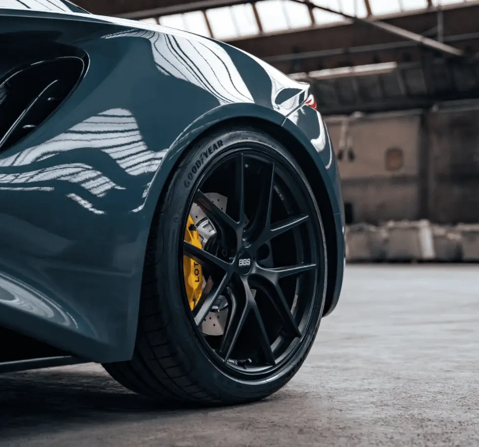

Claimed spec 20x9.0 front and 20x11.0 rear. Apparently these new "Unlimited" series wheels from BBS have integral adapters to vary the offset, so they can be matched to a wide range of cars and bolt patterns. Great idea, if it works and doesn't break under serious load. I trust these more than a "sandwich" bolt-through spacer though.

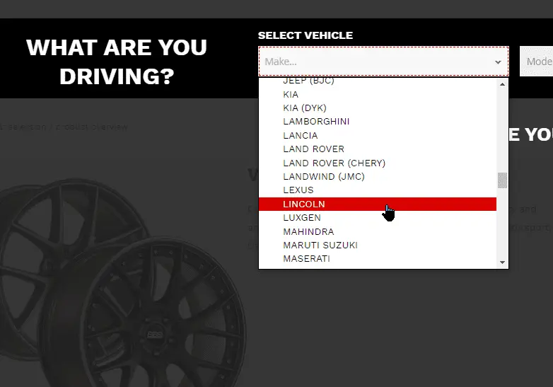

There seem to be a few barriers to configuring an appropriate set on the BBS website for an Emira, though... bit of a head-scratcher considering they've clearly built at least one set. Hopefully they get this updated.

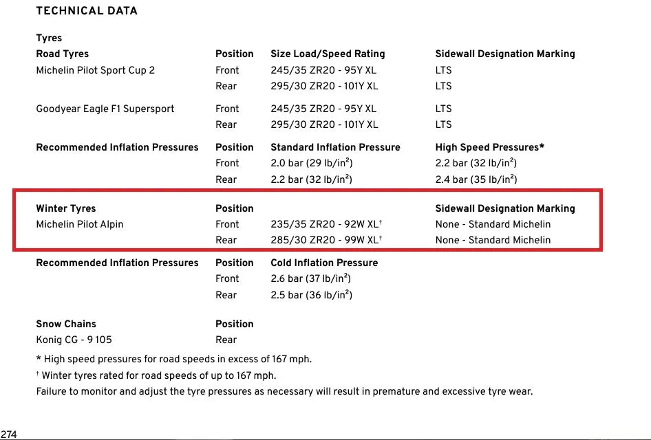

If you need (or are obliged to fit by law in your territory/state) "true" winter tyres then the Lotus recommendation (excerpt from the user manual) is these :
