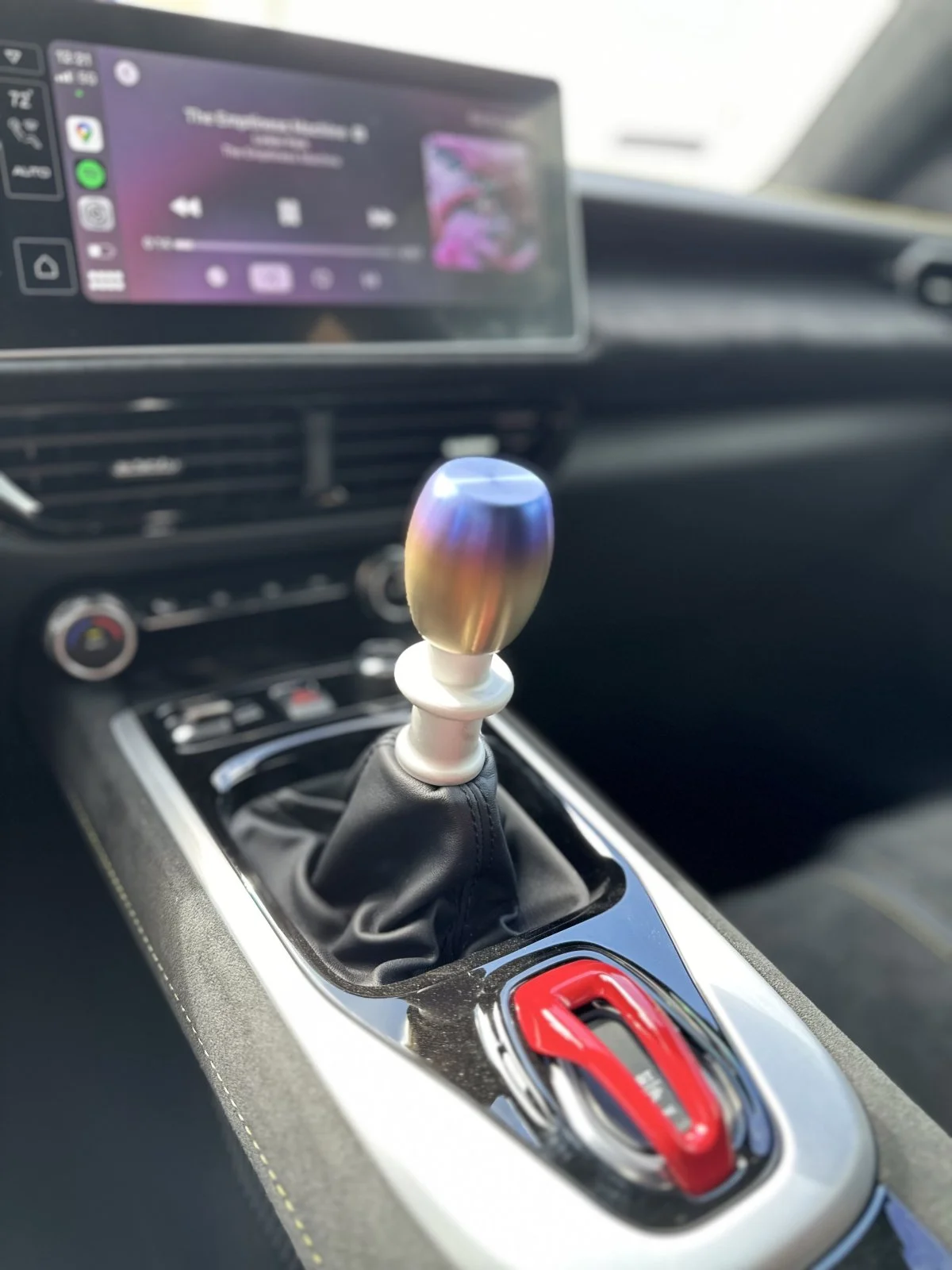

I switched to a heavier shift knob for a slight improvement in feel.
Coming from an s2000 I know exactly what you mean. Especially the “staccato” feeling now. I imagine I’ll learn to drive around it, but the shifting and power proved difficult to drive the Emira smoothly around track.
I switched to a heavier shift knob for a slight improvement in feel. View attachment 52190
this makes sense as one physical option to counter balance the shifting resistance. problem is I am one of the few that like the stock shift knob! maybe if I can find a weighted one that looks OEM.

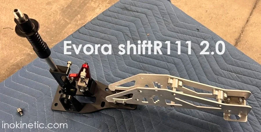

There's not a lot out for emiras but searching for evoras I found this company who replaces the whole linkage assembly. It looks pretty involved and a bit sparse on details for how it feels at the end but worth a call/email to them to find out and see if they can make an Emira version.
That looks pretty expensive without 100% clear results. I did poke around the site and that led me to thinking about the clutch delay valve. Apparently the Evora GT has a CDV and some have eliminated it to enable faster/smoother shifting. Again, not 100% clear if this makes a real difference or not.
Apparently Lotus fixed some kind of rev hang issue with the Emira that allows us to rev match MUCH better than in the Evora GT. That fix tells me there could be something about the setup holding the Emira back from shifting more quickly. Not the shifting action itself, but more about gear engagement/clutch/mechanical related. Maybe it is the native synchro setup mentioned above.
So far ideas for improvement are weighted shift knob, eliminate CDV, change transmission fluid. Not really considering the wholesale replacement of the shifting unit. for my purposes, I don't think a short shift kit improves anything.
I have their shiftR111 2.0 upgrade on my Elise and it is a huge improvement. I would not hesitate to get one for my Emira if they could offer a similar upgrade. The company (InoKinetic) worked on my Elise quite extensively and they do great work.
