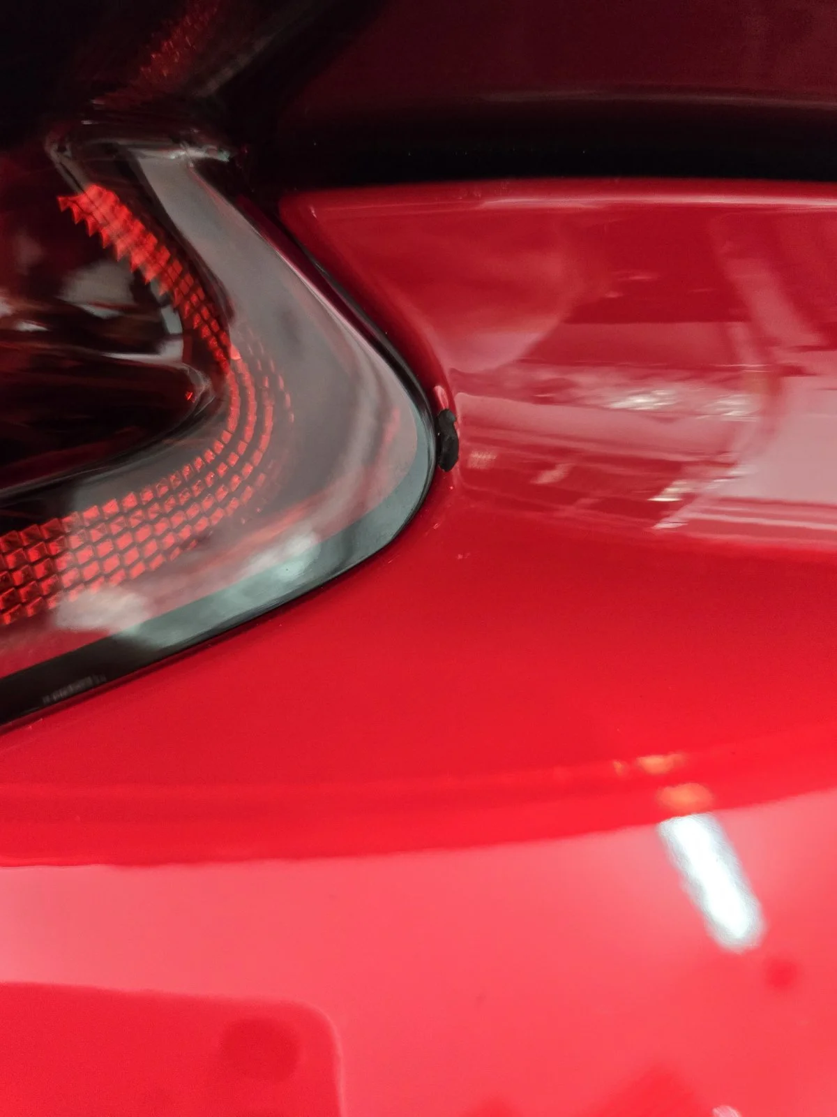

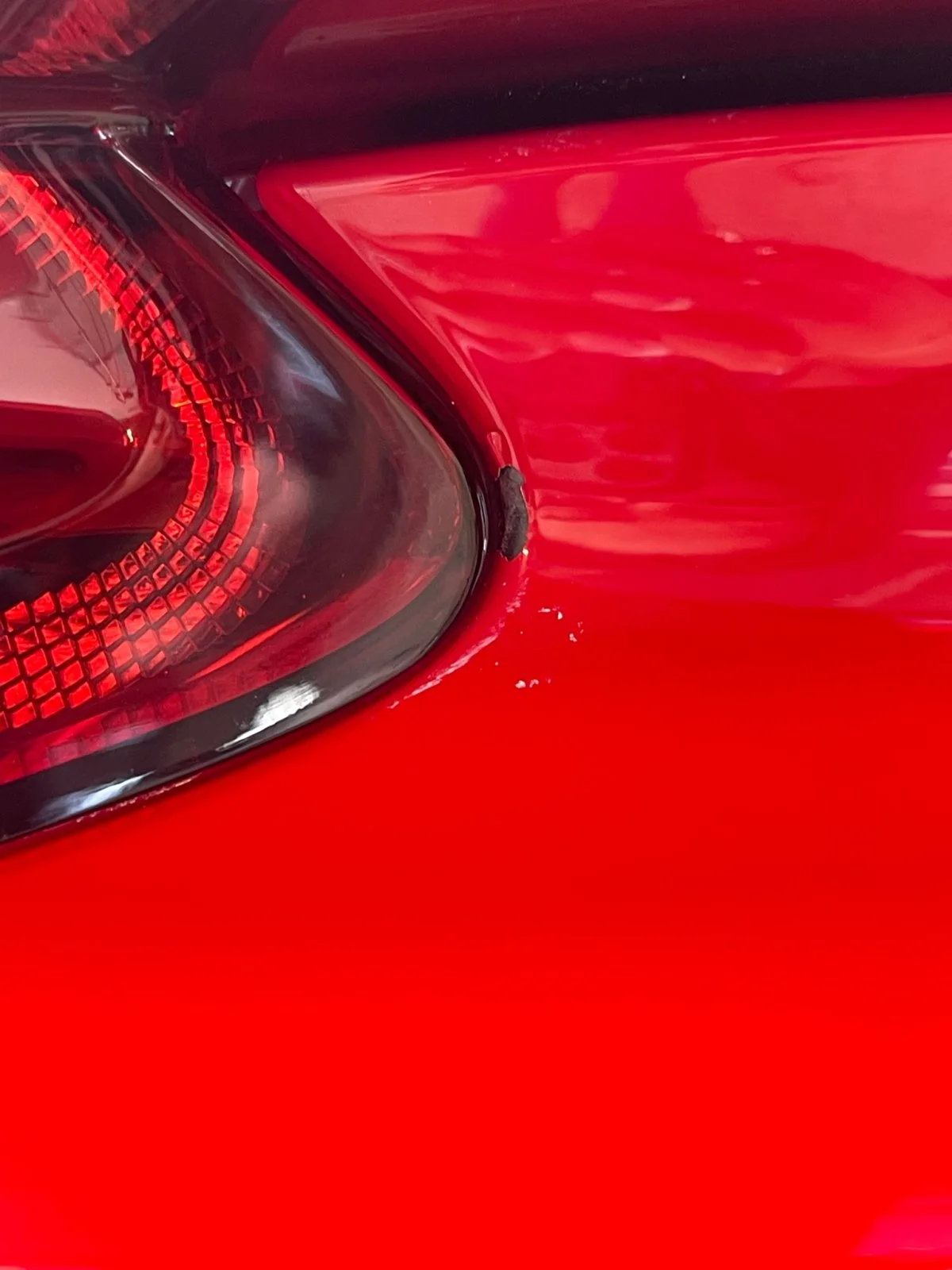

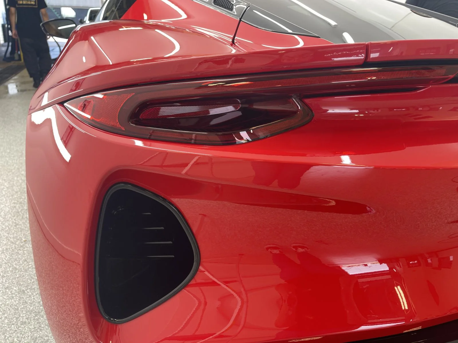

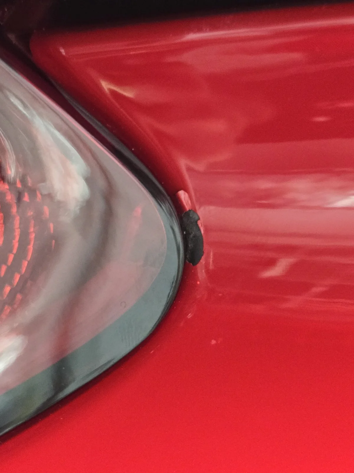

I picked up my car on 6/18/24 and unfortunately didn't notice a bubble near the rear driver side taillight. Two days later I dropped the car off for PPF/tinting and less than 15 minutes later the shop called me to let me know they discovered a bubble.
Dealer says they'll take care of things, but need more pics and or to see the car in person before proposing the next steps.
Vivid red too, so not fixed with newer / 2.0 models. This does look like a QC issue though and maybe not the same thing as the paint blistering others are seeing?
According to their website, Teijin Automotive Technologies only makes the doors, rear fenders and rear hatch on the Emira. The material of the rear bumper is probably something else. From the photos it certainly looks like the base material is degraded and moisture has compromised the finish
Thank you for pointing that out, so maybe I'm "lucky" and this is some other defect that isn't as bad as the blistering documented on this thread. Most manufactures use plastics for the front and rear bumper covers, so it makes sense that this may be a different material than the doors/fenders/hatch. Regardless of the material, a deformity leading to bubbling paint means I will push for a replacement of the entire rear cover.
I'm back in town on Monday and will report what I see in person in greater detail later that day!
I'm back in town and was able to see things for myself and take my own higher resolution pictures. Good news is that after looking VERY closely this appears to be the only defect on the car. My eyes aren't what they used to be, but zoomed in there appears to be an indentation/deformity at the spot.
So for the sake of others I hope this FE2 issue is a one off and indeed different than the bubbling issue.
