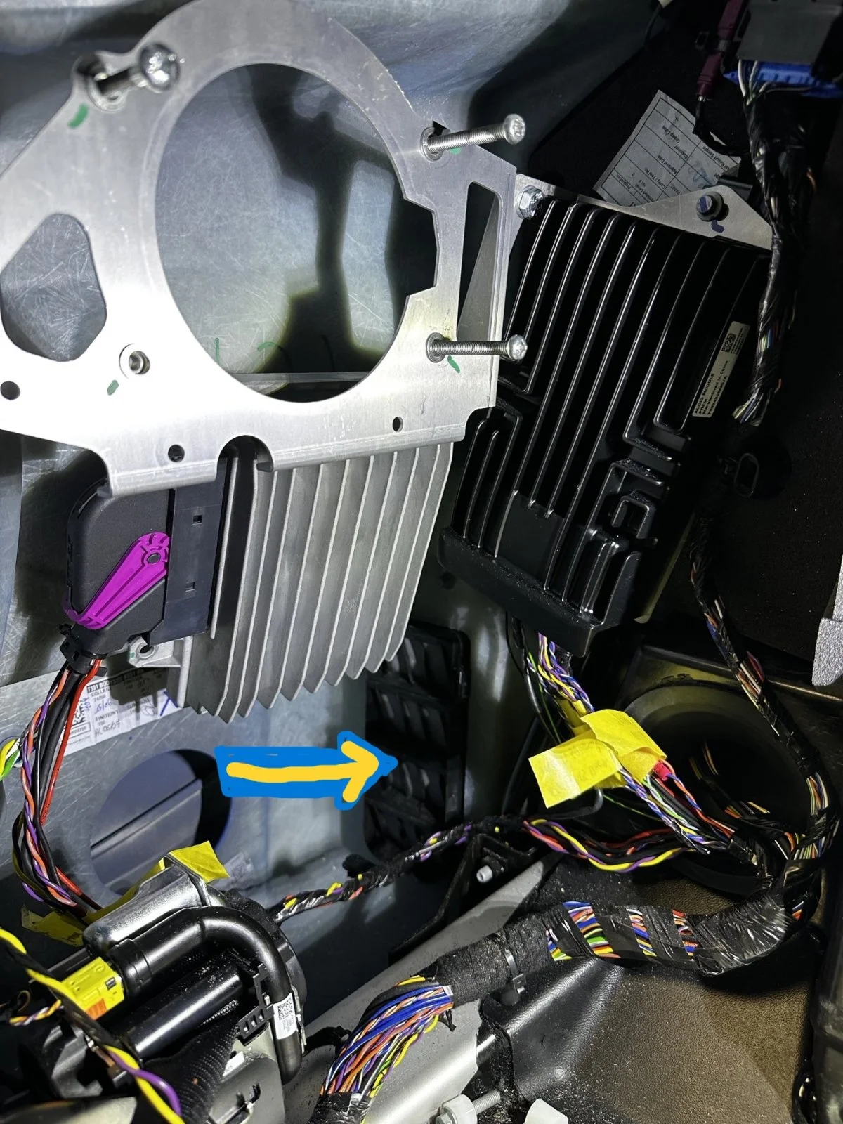

Hi CoryC
Sorry to call you out on this but it's definitely not the air pressure relief flap causing this.
The Flap (located in the right rear of the car, next to the sub) is designed only to release air when closing the doors, the flap cannot move in the opposite direction - Have a look at the below - this is the relief flap you're referring to.
Trust me, I've had my car in bits & ripped out all the KEF speakers, including the Sub, and replaced it with high end equipment. My car doesn't make this sound anymore, plus the audio now sounds as good as the car looks. ;)👍

I welcome the call out! I had simply assumed that's what it had to be... having narrowed it down to the stock sub, do we think that "popping" sound had to do with the air pressure at all? Possibly causing the sub to flex? It doesn't sound like an audio noise to me... more of a physical one. Could it be the open air sub system allows the atmosphere changes in the cabin to distort the cone slightly making it "pop"?
To add to the list of clues: For me it exclusively happens when I open the door. It feels like it happens more often when unlocking and opening the door shortly after. Think unlocking next to the door snd opening vs unlocking while 10min away and then getting in.
(Maybe while the fan is still drawing initial/starting current?)
This is NOT official, but an educated explanation: -
As the dashboard and info screen come alive the slip second you open the door, it's being discussed as this is the cause. - the system booting up if you will. This also makes sense as both audio amplifiers always have a 12V feed, they do not "go-to-sleep" as they do with other manufactures, which means the boot-up noise is being amplified.
