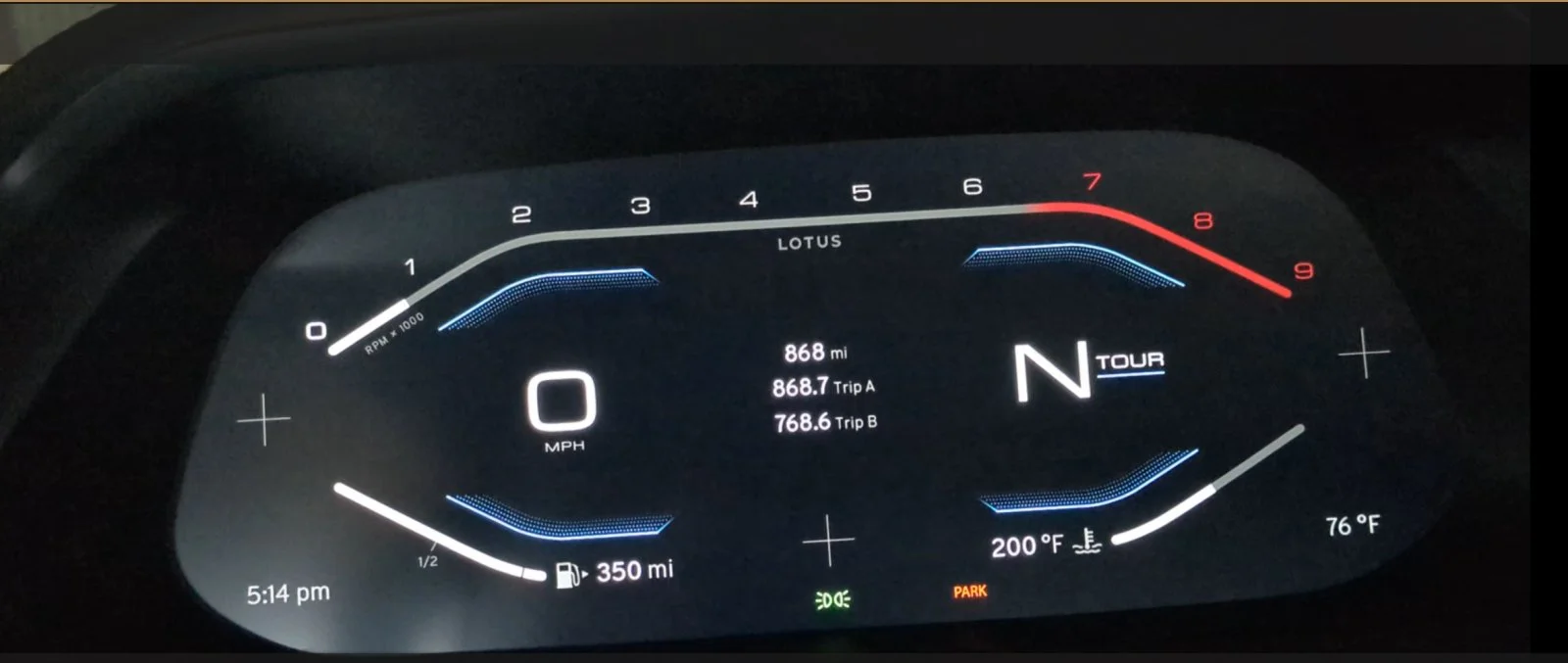

Picked up my Emira Friday and drove 868 miles within the first 24 hours of ownership...all following proper break-in procedure thanks to this thread and everyone who contributed. So a big Thank You from me. Can performed like a champ and looking forward to some fun driving now that it's home.
Just wanted to report back that break-in went smoothly thanks to the helpful info in this and related threads. If you're interested in my break-in journey...
