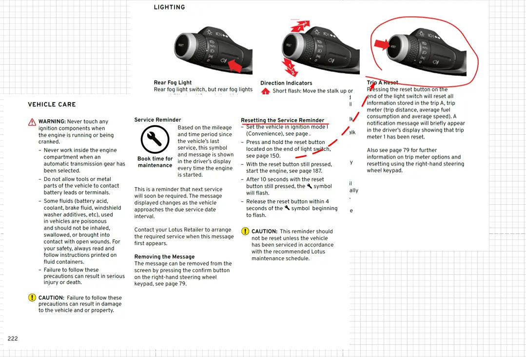

Per user manual US version:
however, it was the exclamation triangle blinked, didn't see the wrench symbol in the dash
