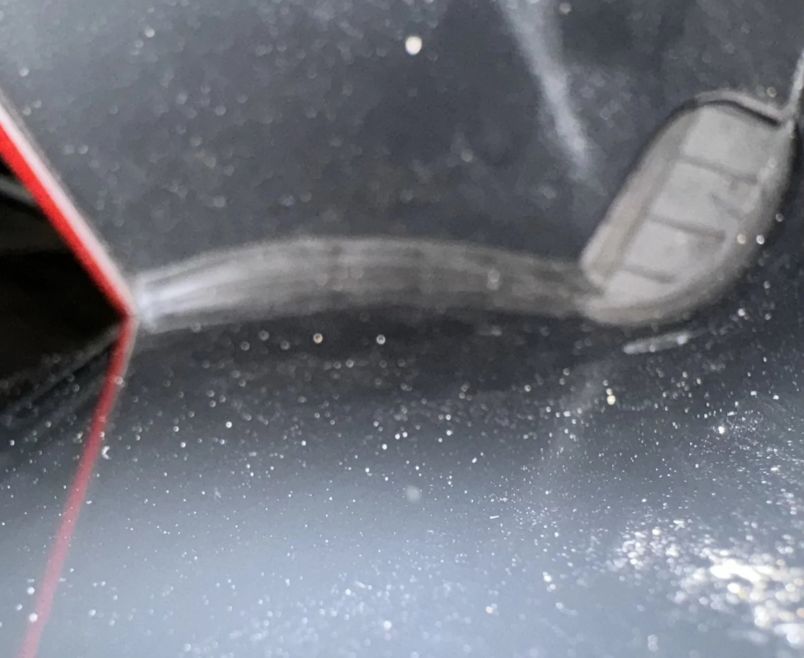

May 2024 build here. I can confirm my rear tire area also has this rock collector hole as seen in the OP's image below.
yeah all cars have the rear opening. OP is talking about an opening in the front fender liner behind the tire.
I owe everyone an apology and here it is. I checked my car this morning; the first time since being at the detailer on Saturday. The holes I described ARE in the rear wheel wells. They’re in front of each rear tire (closest to the door) and the rock accumulation area is the outside cavity next to each rear tire. There are no holes behind the front tires.

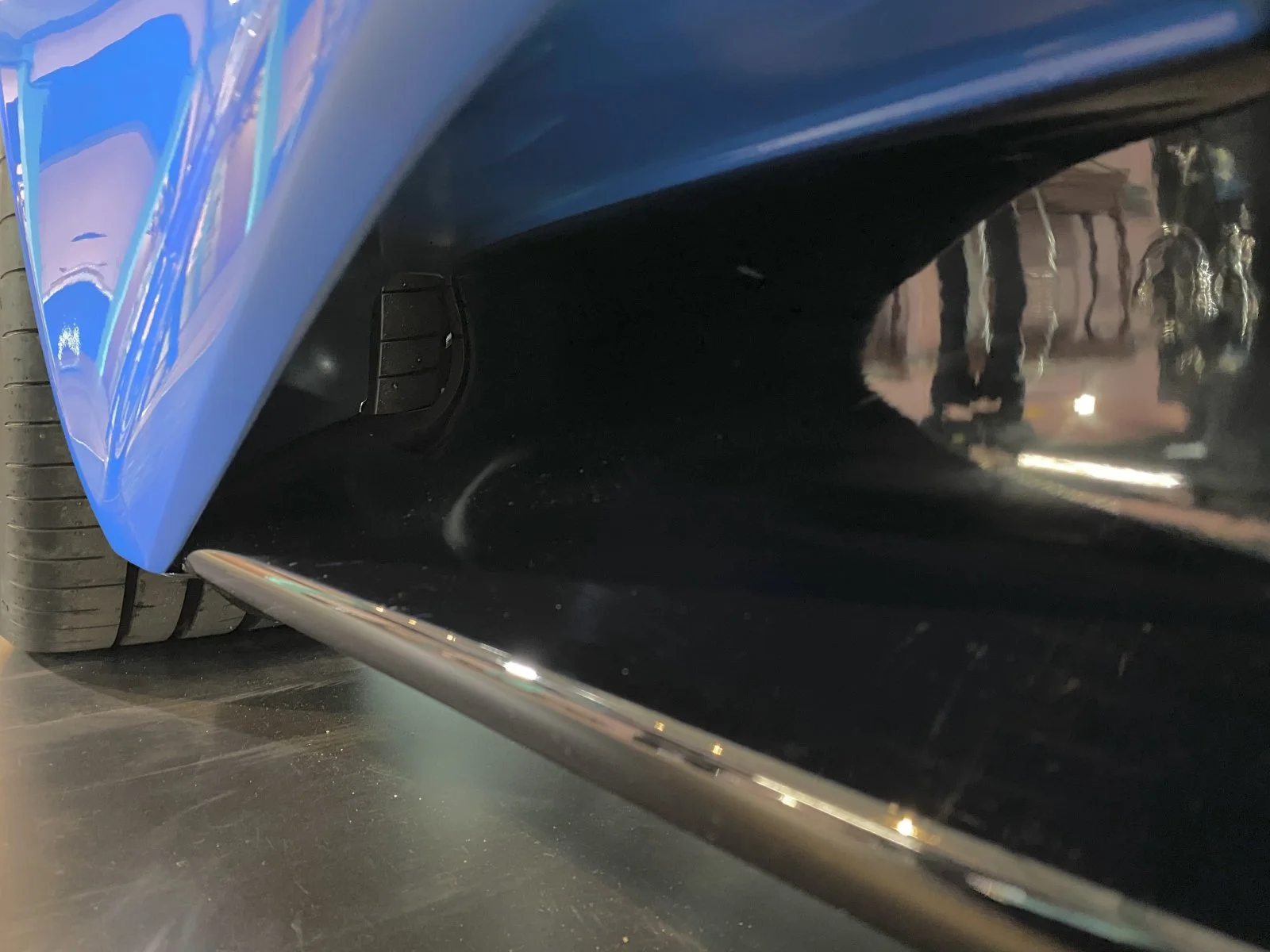

The hole has been there since (before) day one.
This is a pic I took of the pre-production roadshow car in November 2021.
It’s mainly an aero thing. Pressure reducing airflow through the wheelwell that exits out the vents at the back. Helps cool the brakes too.
Blocking it up is probably a bad idea. Mudflaps on the front would do more to stop the stones.

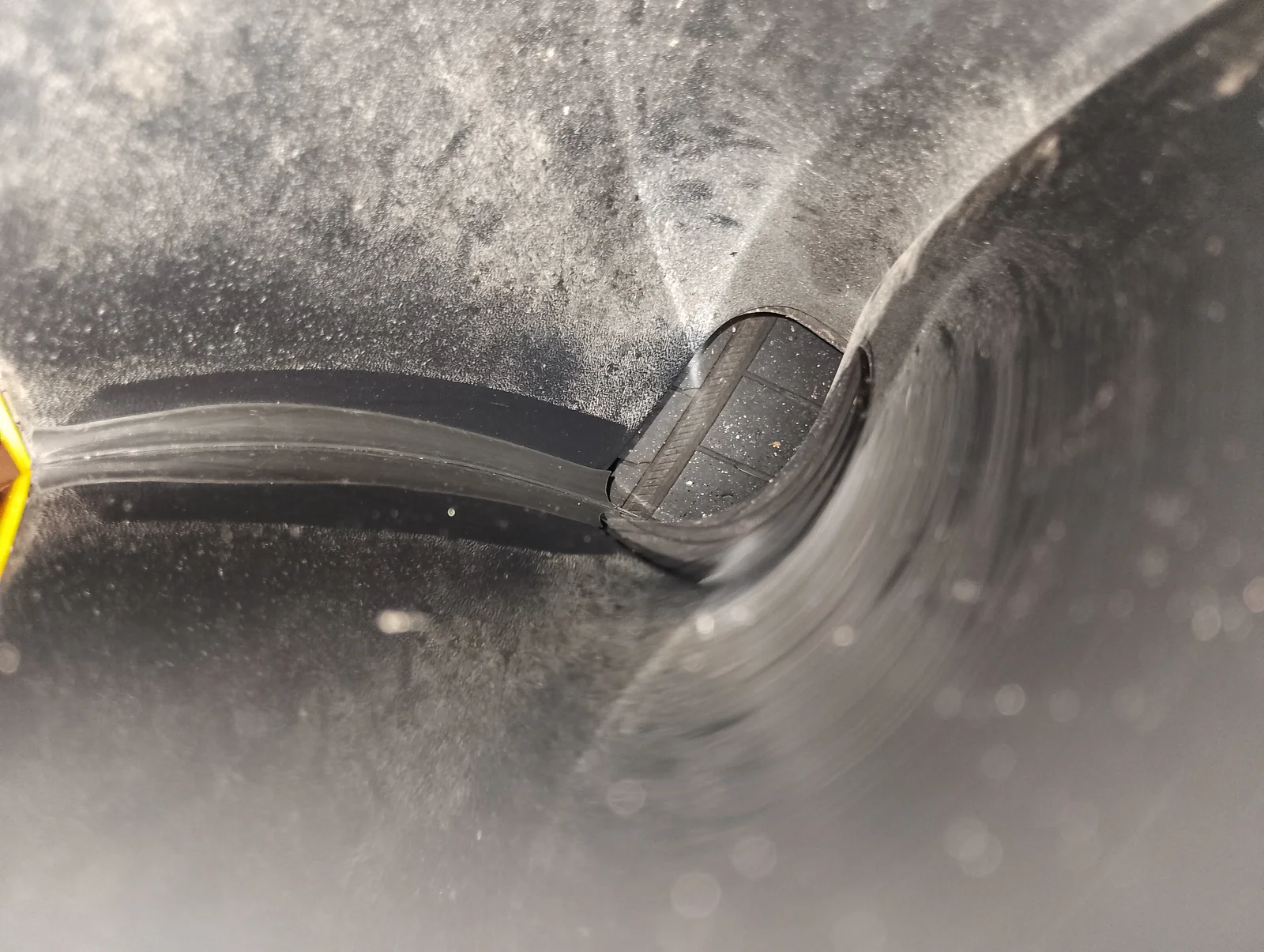

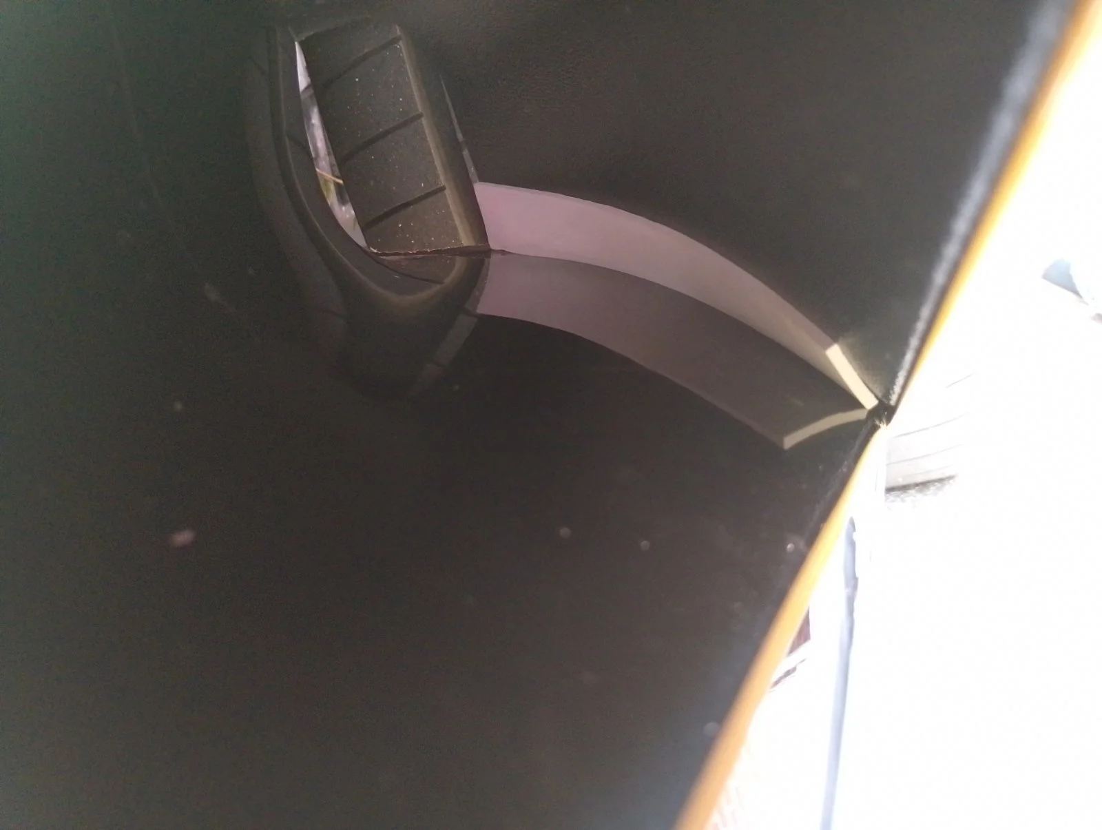

Well, after cleaning out all the small stones trapped in here I had a look in my garage to see what I had to stop this.
I've applied one strip of this 3mm thick draught excluder closed cell foam.
It's tricky to do but I pushed it into the gap a very small way and then lifted it up to stick it on the vertical surface.
Hopefully the stones will hit this and bounce on their way out the hole.
I would have preferred it if it was black so If it works reasonably well I might change it. You can't see it though unless you're looking directly at the hole at ground level.

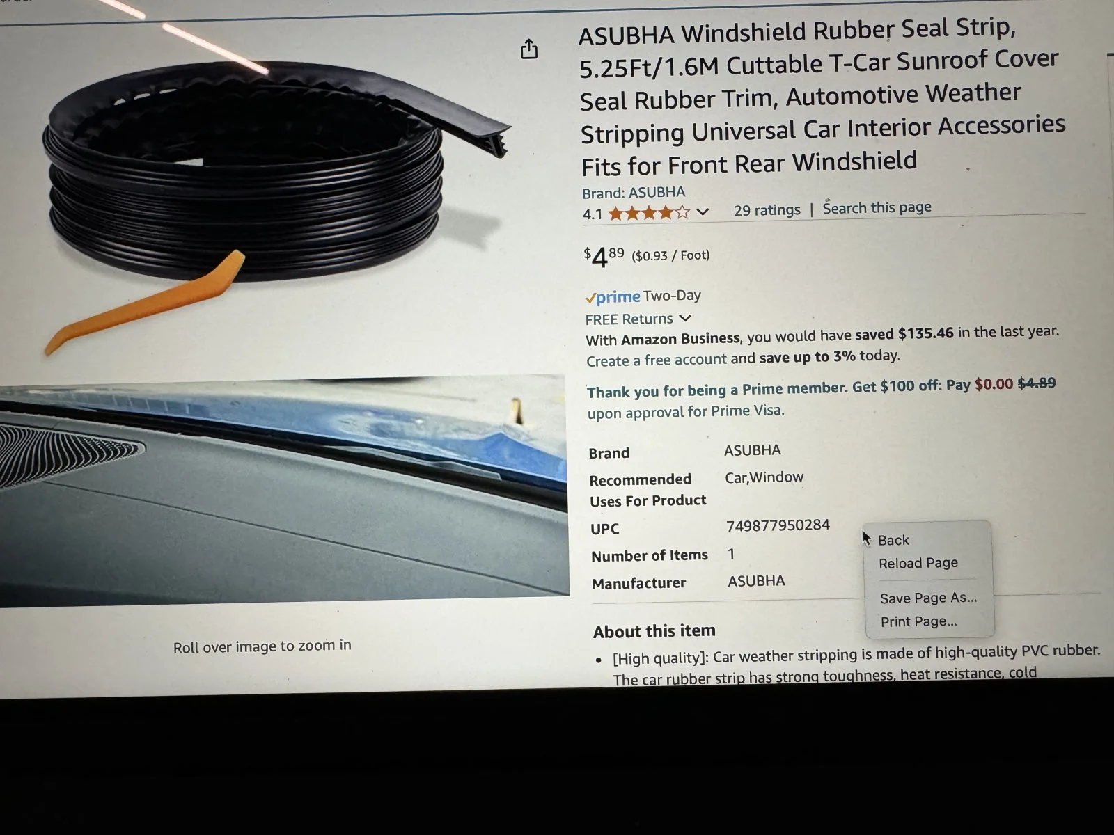

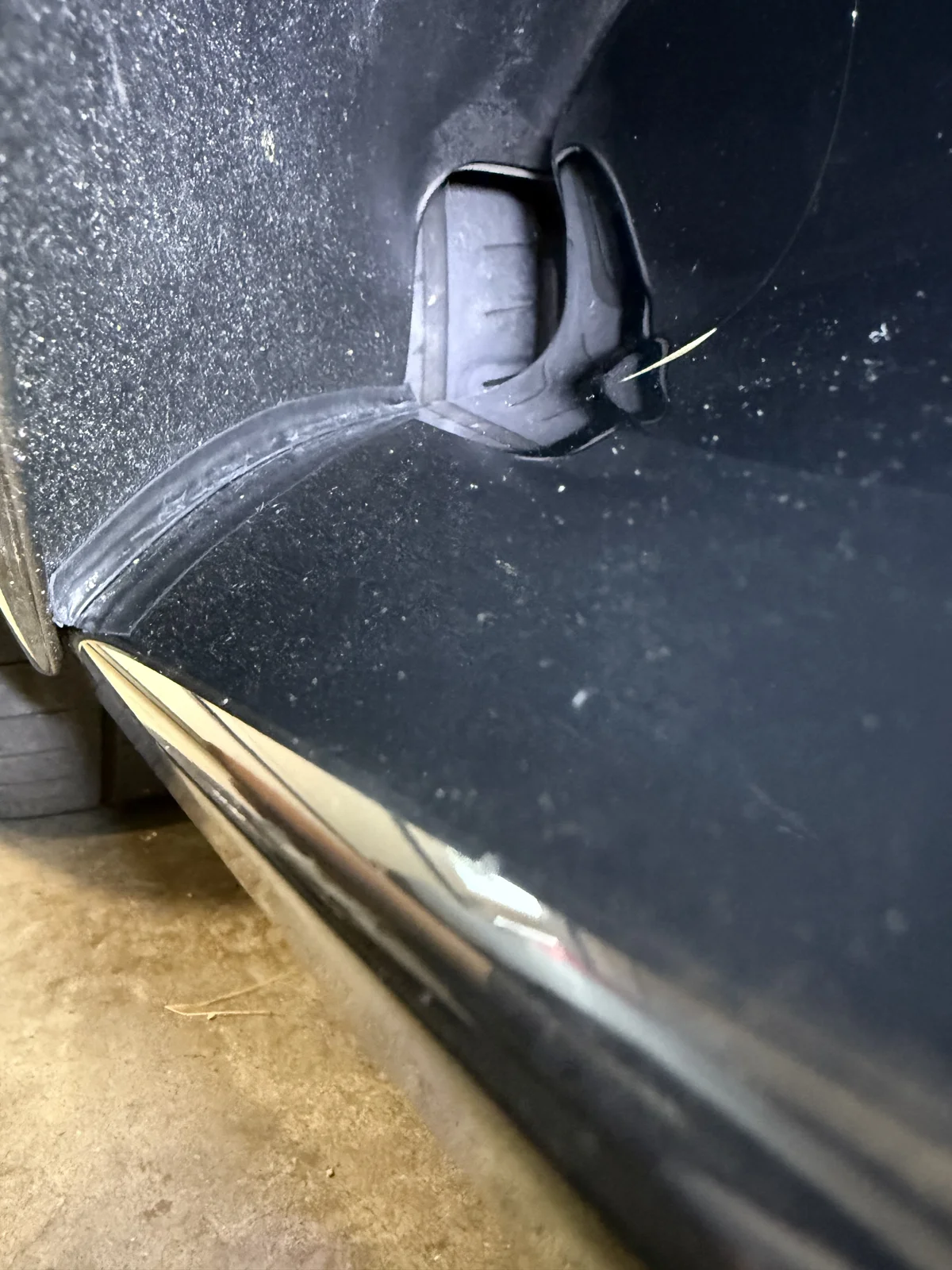

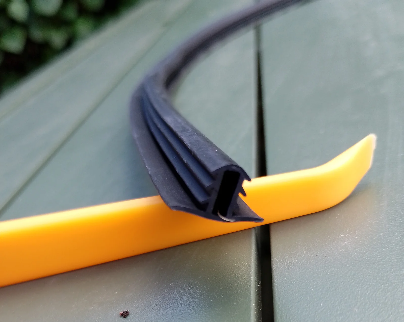

I took the liberty of using your idea to also solve to the stone and debris collected at the end of the side skirts' tunnel on my Emira. I purchased the (pictured) tool on Amazon (don't know its official name) to carefully clean out the existing debris and purchased a trim, generally used between a car's dashboard and windscreen. That trim, (also pictured) easily and perfectly wedges in and seals the crack where the debris collects and gets stuck. No need for the assistance of any glue as that trim once pressed stays firmly in place. I'm also including a picture of the final result. Hope this can help others and thanks for your initial tip. That's what this forum is all about.

My initial "fix" (see above) hasn't worked as rocks were still being collected and one side had the foam strip coming partially away and collecting rocks on its sticky side as well.
I've gone for @crestima 's solution with a sealing trim that pushes into the gap.
Let's see how this does.

I think you'll be very satisfied with this solution as my trim has stayed firmly in place up to date, it has sealed the gap and has effectively avoided the collection of small stones and debris in the otherwise original open gap.

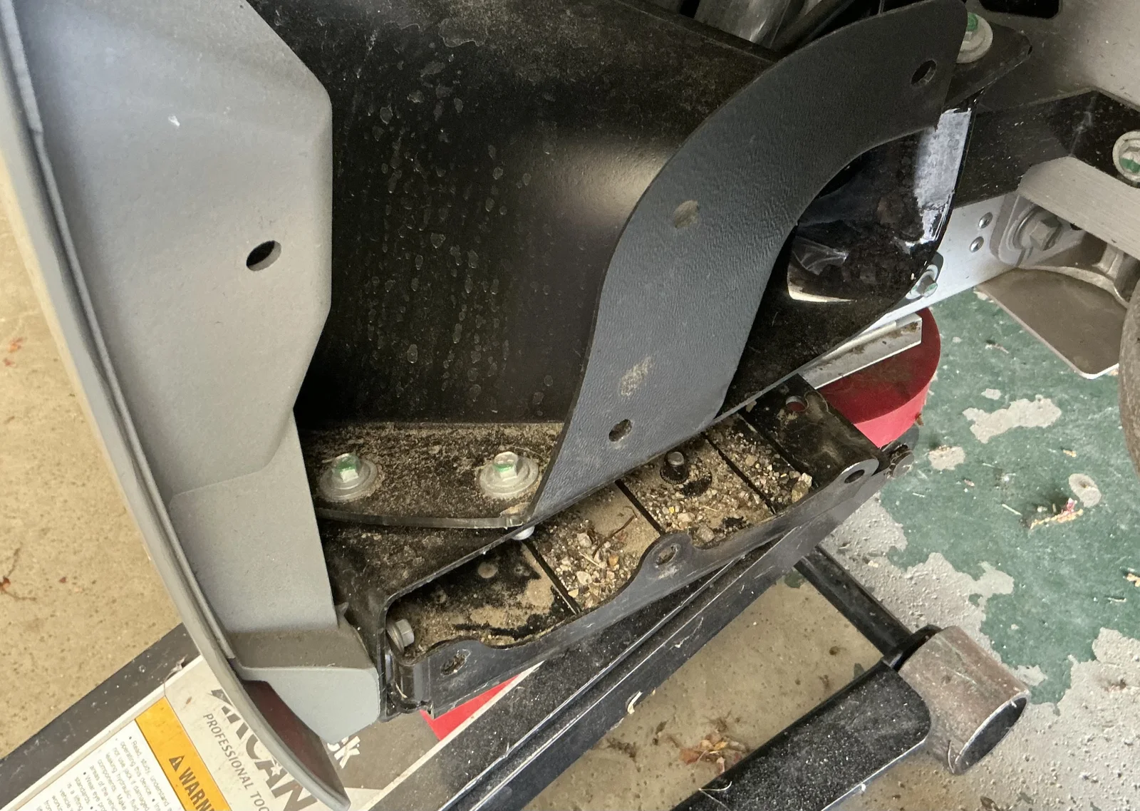

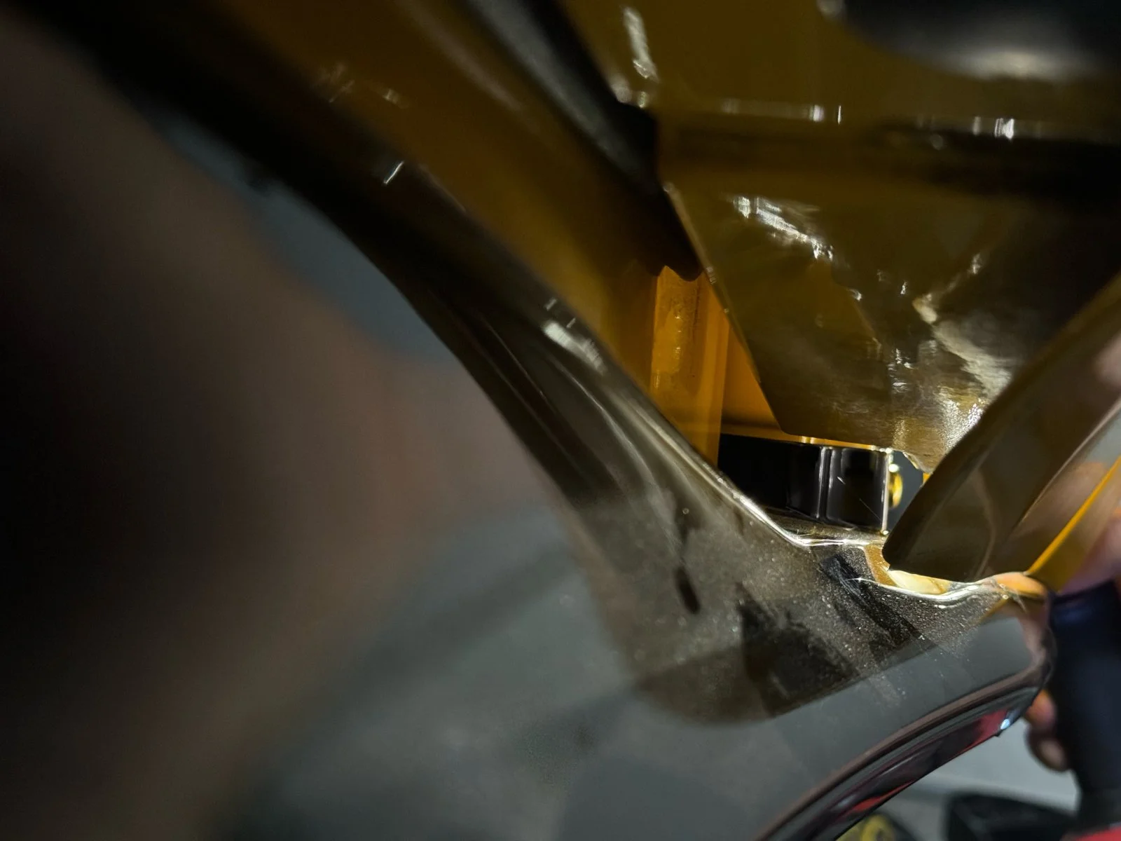

This is what mine looks like with the fender liner removed (early build, no hole in mine).
There is an opening but it’s very small and it’s blocked by a tab:
Wonder what that area looks like in a newer car.

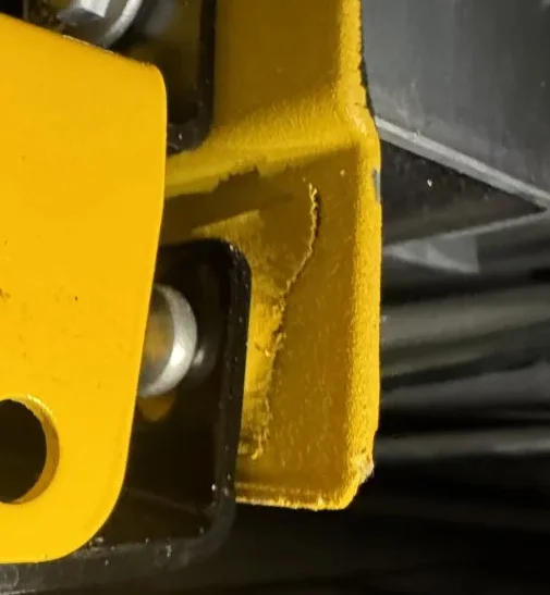

WTF is that flaky bit, looks like it's pulled away along with the chips on that leading edge. Where is this bit, so I can get some stone chip paint on there

Could you add a link to the products you purchased from Amazon?
Thanks,
This is the UK Amazon site:
https://www.amazon.co.uk/dp/B0BSKYGR7R
This is on the US Amazon site, different supplier but looks the same:
https://www.amazon.com/dp/B0CJBZDHNH?th=1
Also, this is what Crestima used looking at his photo of the Amazon site, the tang part looks like it is shorter than mine:
https://www.amazon.com/Dashboard-Protector-Windshield-Soundproof-Weatherstrip/dp/B0BNHJC6KC
There are several suppliers for this, probably all from the original manufacture.
If anyone gets stuck search for the following or similar:
Windshield sealing strip
