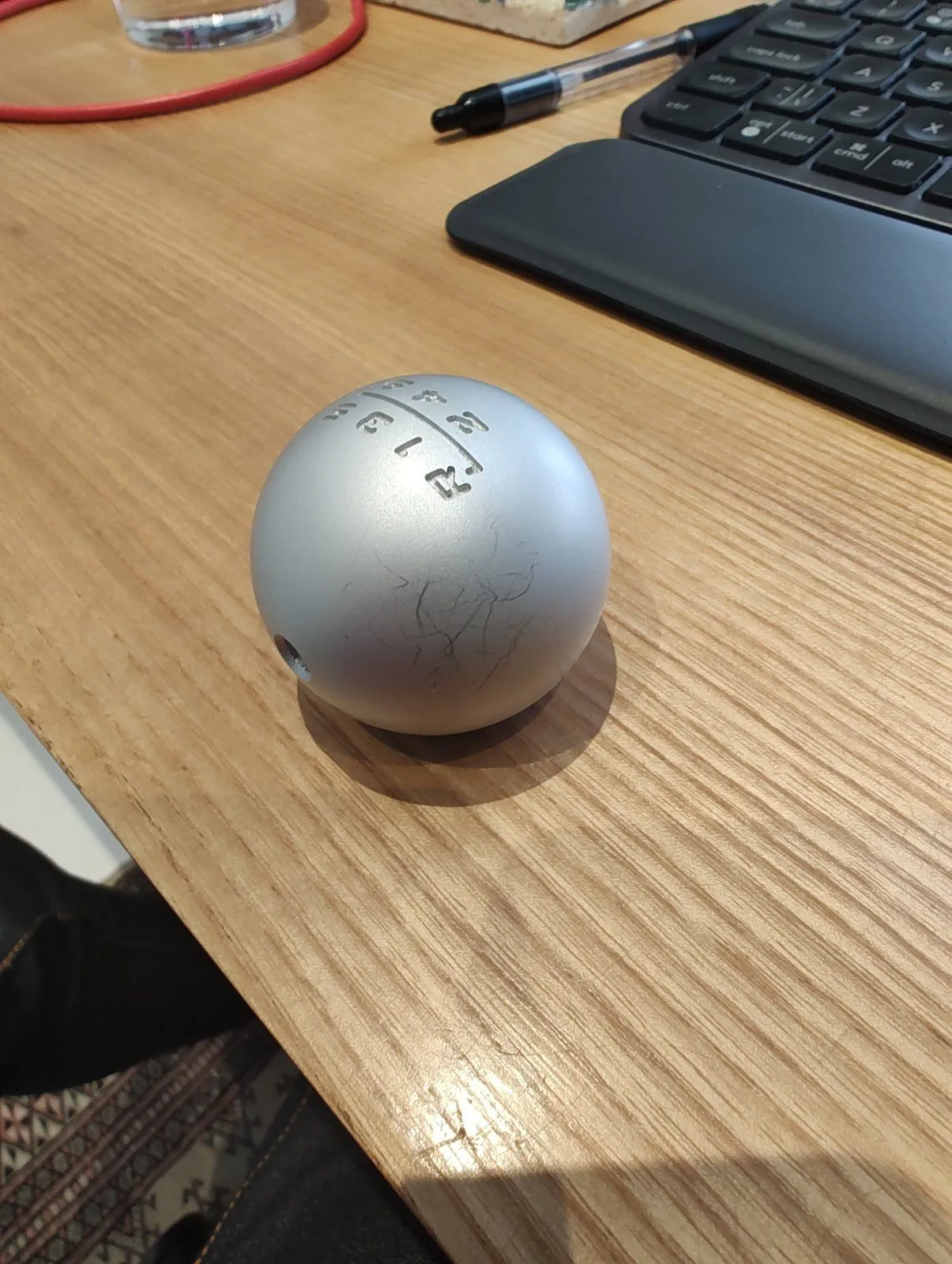

So, as is inevitable, someone has worn a ring while driving my car and scratched my gear knob.
As it's anodised, I have no idea what can be done to remove the scratch.
Anyone used anything to remove scratches from one of these? Can it be done or am I stuck with it?
To be clear, I've had the car a while, I think it was done by the dealer while having some service work done, but, I can't prove that.

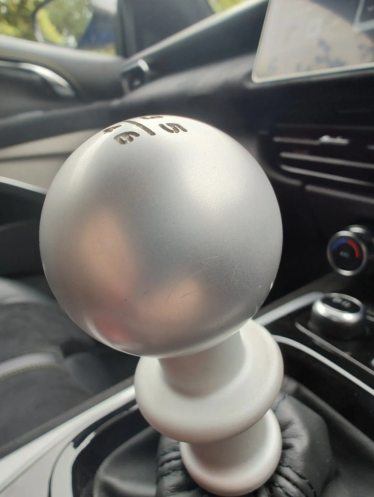

So I actually have 2, one on the car, and one that was on the car but was swapped because it was scratched before I collected it.
The one on the car is a lot lighter, but still noticeable.
Kind of hoping there's an easy way to restore the light scratches without having to replace the knob, though, good to know it's only £50 if it gets really bad.

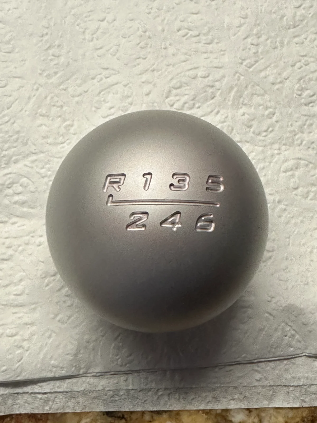

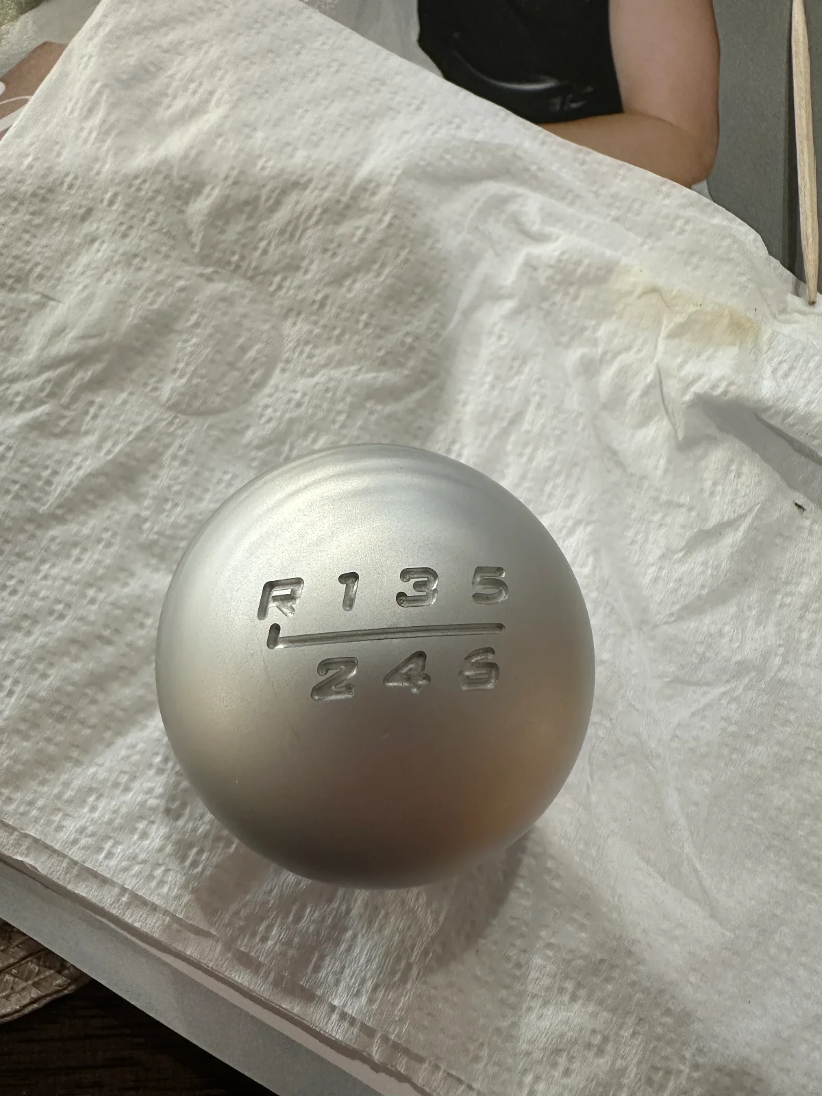

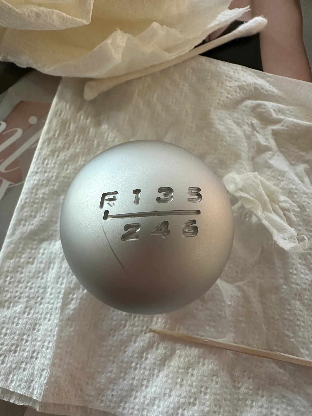

3M rubbing compound works pretty well. Scratch is still visible but less so now.

Yup, polished a bit more and it looks great, can’t see it
