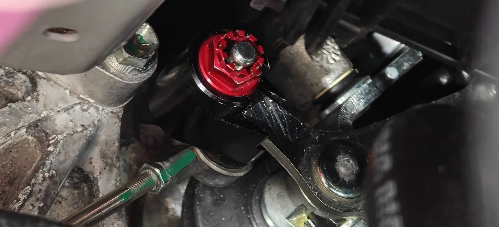

When looking at the shift linkage on the Emira it looked exactly like the linkage on my GR Corolla. So I bit the bullet and got the Forge Motorsport short shift kit . It arrived today and I was able to install it with one hand, in about 15 minutes. Only removed the trim piece closest to the trunk. Nothing else. Here is a link to the item:

It's adjustable, I set it to the middle position. Nice short, firm shifts and only $85.

On my Corolla, yes. Shortest setting was too much, shifting was a little strained. Longest setting was also nice and short, but the middle was the sweet spot.

I've only done 110 miles so far so cannot tell. Since the shift is now faster, I would not say that it is smoother. But in practicing heel-toe downshifts it is definitely easier to rev match and release the clutch sooner .

Instructions would be pretty much the same as for the Corolla. Instead of removing the air box, you unclip the trim piece closest to the trunk. Then simply reach through the pipes. Easier when the car is cold.

Pic after installation?
You missed it above, post # 13.
