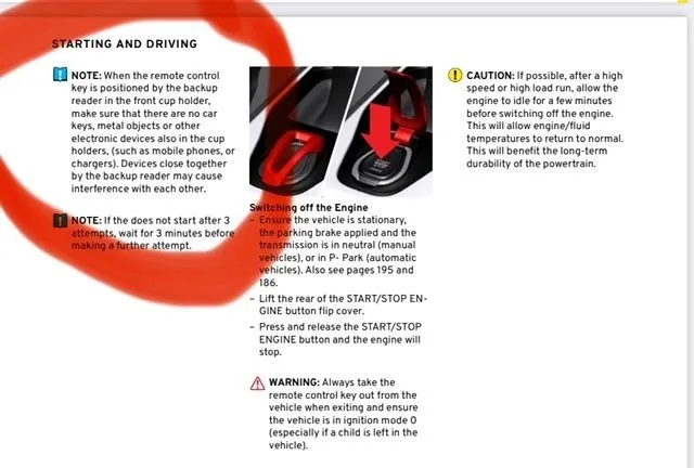

Same issue here ... found this (below) in the user manual - removed my iPhone charging cable and my Ooono Speed Camera tracker - and it worked for me
Howdy sir - did this actually work for you? ...I have this problem and it drives me crazy, I have a charger for my phone in the usb in front of the gear shifter and a dashcarm into the obd port
