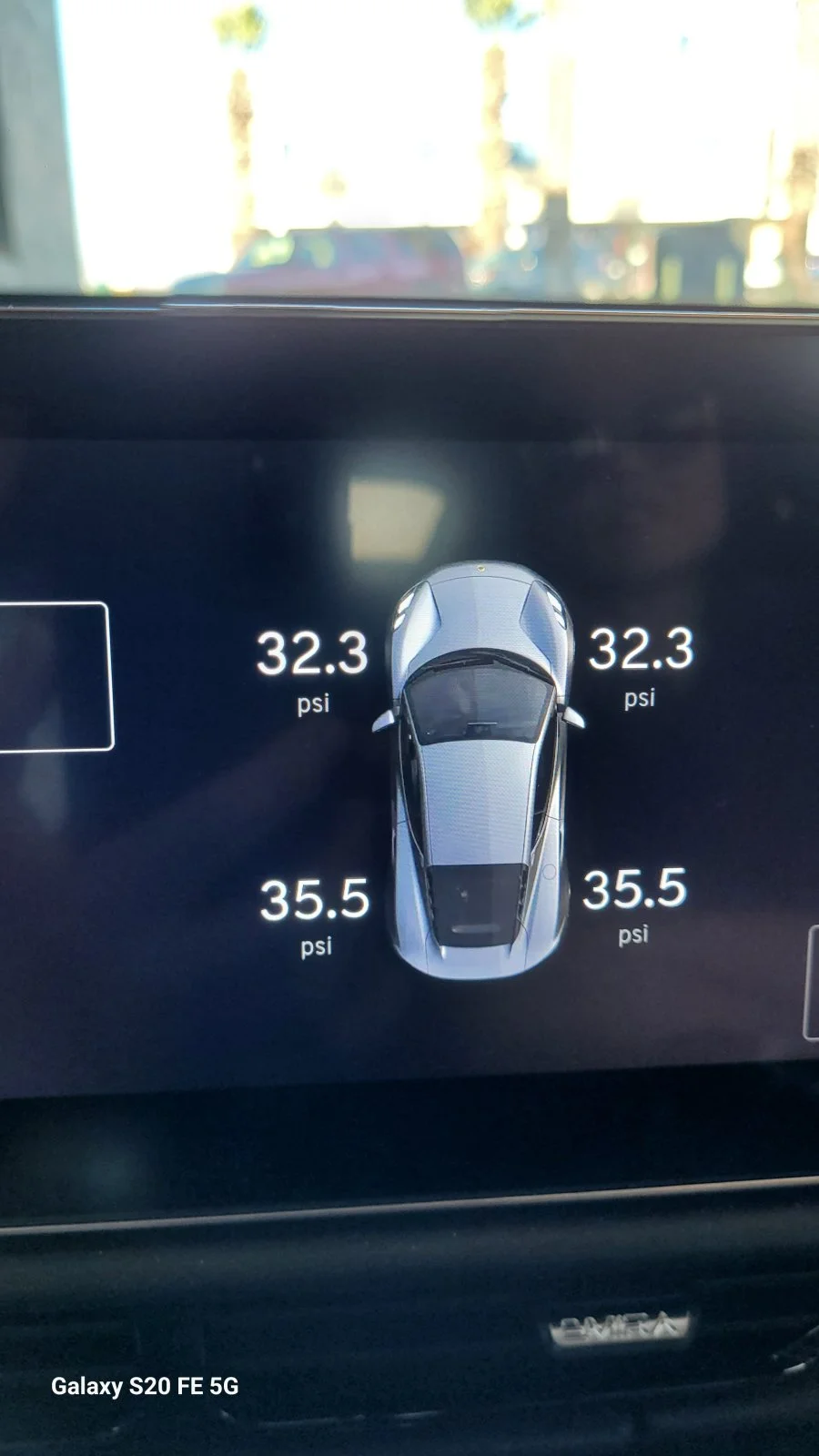

Quite frustrating....my tpms reads perfect but dash light still on... how do u get it to go out??
Over time it should turn off on it's own, however what I've done when that's happened with other cars I've owned, is increase the tire pressures by a couple of pounds above recommended. Drive the car like that for a day or two, then lower the pressures to what they're supposed to be. That's always worked to get the dash light to turn off. If all else fails, take it to a tire place like Discount Tire and ask if they can reset the TPMS units. They have a magnetic device that can do that.
By the way, for the Goodyears the recommended tire pressures are 29 front and 32 rear. You're already running a little above that. Try lowering them to those numbers and see if the light goes off.
