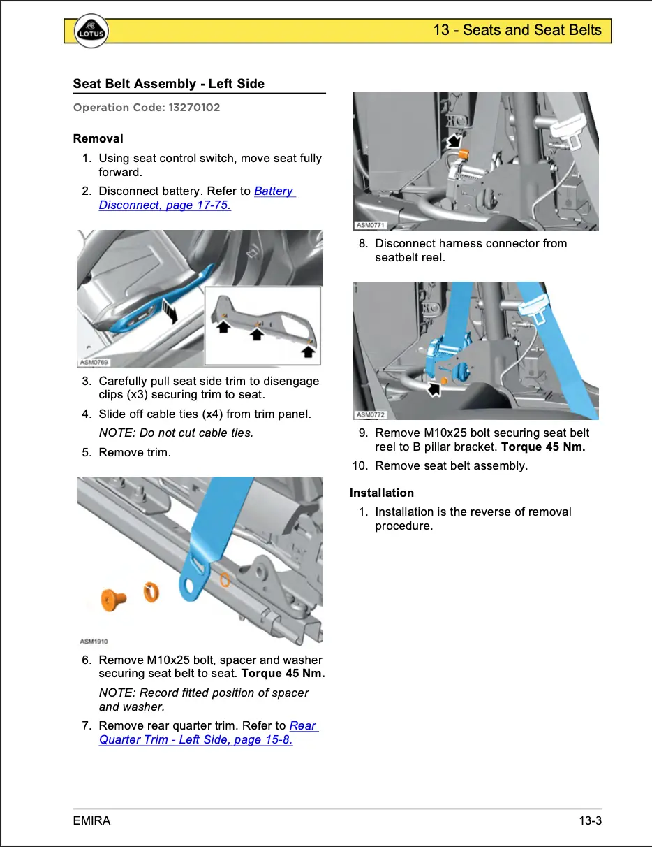

Personally I wouldn't tinker with seat belts myself. If you do please make sure to torque everything up to spec. This is what I can provide you off the service notes:
If you choose to diy, maybe have a quick chat with your dealer about it. I think there was some concern regarding safety if untwisted - apparently it was done on purpose. I can't remember :(

Thank you @Kimmax
Where did you get the service manual?
