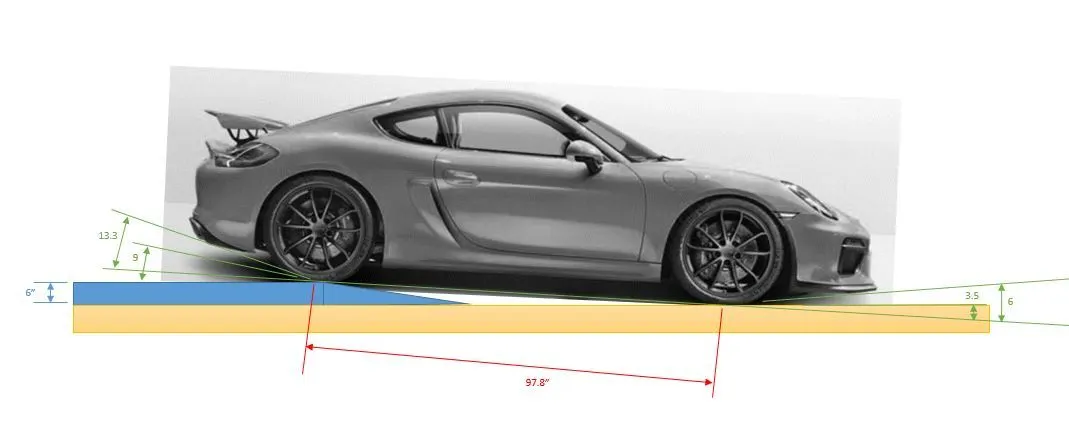

I don't have data on the GTS, but the GT4 with a front lip has a front on approach angle of 6 degrees or 7.1 degrees without the lip. If you drive at an angle (e.g. at 30deg up a driveway) then you will get a bit more clearance.
