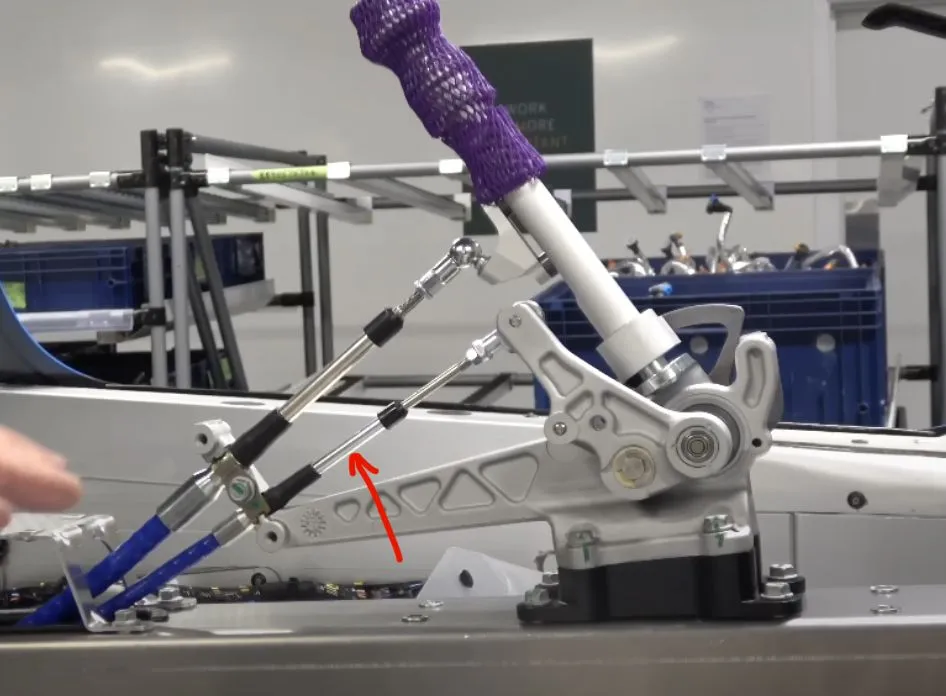

Thanks for sharing the recording! I know its tricky to capture such sounds properly so appreciate going out of you way. It's not a sound that I have in my car and am a bit baffled by what is causing it. Doesn't sound like anything major, moreso something loose that starts vibrating at certain frequencies. A shifter cable might transmit such sounds, but in that case the noise should be apparent near the gearstick as well.

I have not taken it in yet. I think the noise is due to vibrations from the engine transferring through the linkage. I am gonna experiment with adding some dampening material around the cables to see if it gets better. Otherwise I'lll take it in. I just don't want them removing half my interior to adjust cables when that may not even solve the problem

I removed the shroud around shifter to access the cables. The noise is definitely coming from the cross gate cable. You can feel the vibrations if you touch the cable and rev the engine. You don’t feel that on the top (gear shift) cable.
I added insulation to it but no joy. Next step is adding some more insulation bu to the engine bay side of the cable.
