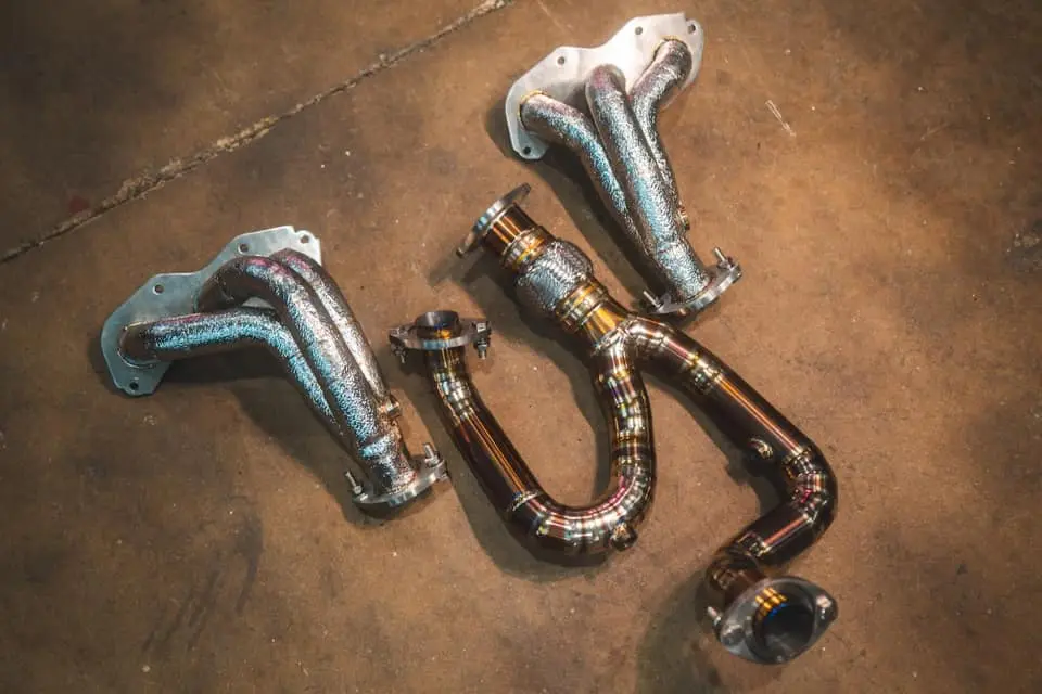

Their header design places the primary o2 sensor in a single runner vs at the collection/collector point of the three runners which in my book and others is a no-no. When this is done the engine is making air fuel ratio changes based on a single cylinders readings, for all three cylinders on that bank instead of making a "global" adjustment based on the reading from all three (making them all run as evenly as possible by taking a reading from all three) This can in turn have the other two cylinders not monitored running rich or lean depending on the monitored third cylinders readings.

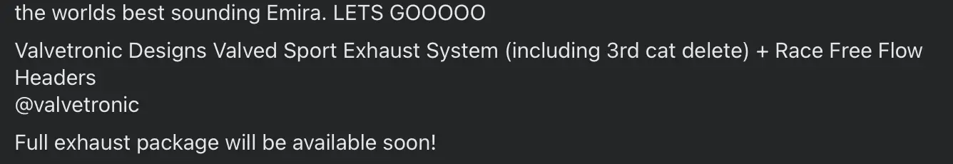

Looks like it, here's his post.

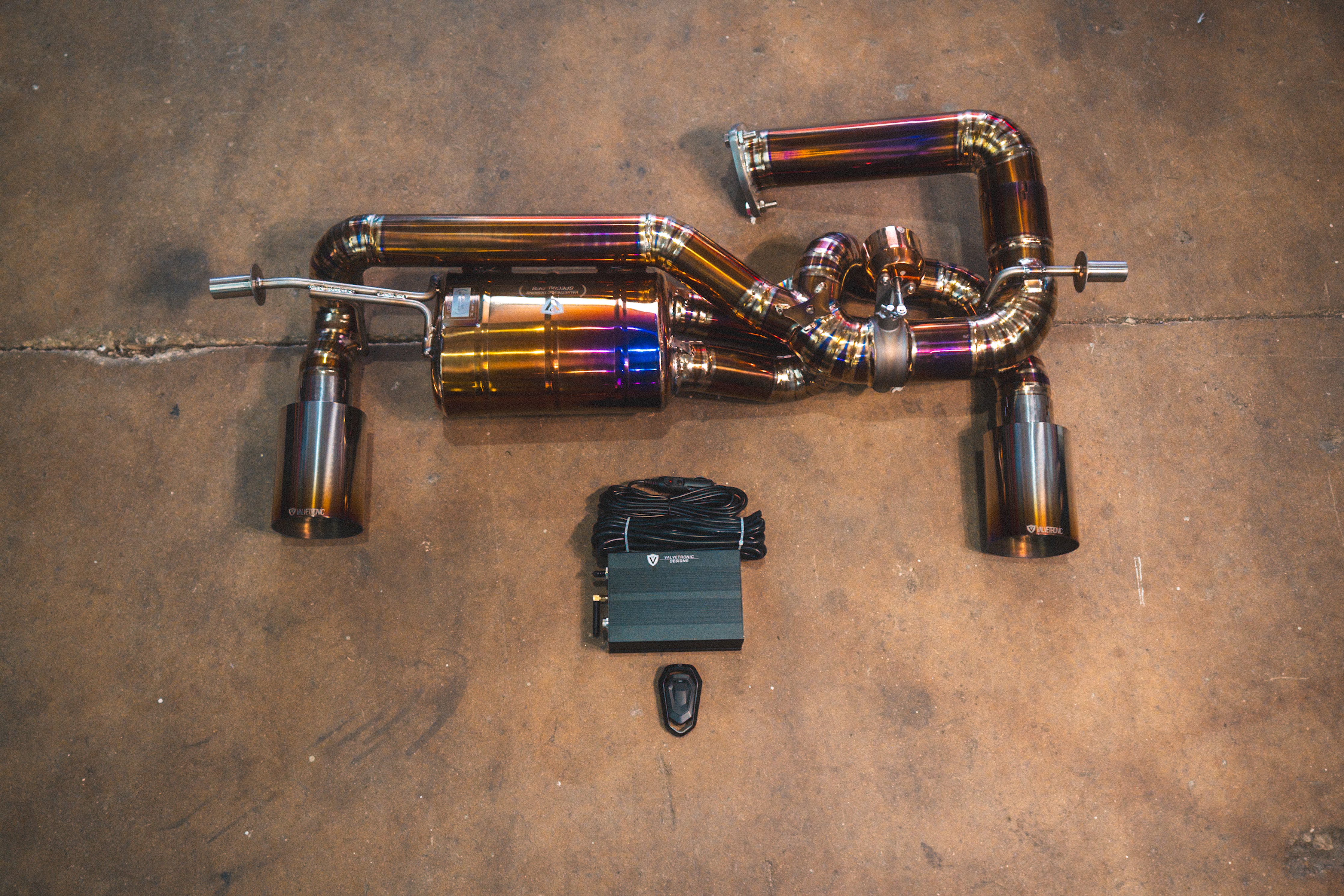

People need to understand that the stock exhaust on this car is essentially a straight pipe when you force the valve completely open, give or take a little bit of additional rasp from titanium.
Any exhaust will sound similar to this with a 3rd cat delete and catless headers.
Looks like their headers just remove the stock cats? If so that would make it a no-go for me. Illegal in most states and the car will stink without them.
Stock exhaust with a valve controller and GRP 3rd cat delete is perfect and cost only a couple hundred bucks. Maybe I'm getting old and boring but I'd be embarrassed driving a car this loud. Everyone but car enthusiasts will think you're an asshat.
Correct they are a catless header. Catless headers do add a decent amount of power (especially once tuned) but also add a lot of extra sound, like 40-50% increase in volume. Not for the faint of heart, especially in a street car. We also sell catless headers but try to warn everyone interested about the sound increase, catless stink and non emissions compliancy

Marginally more high pitched rasp.
No high flow muffler is going to sound massively different to what you have as the stock muffler is pretty much a straight pipe when the valve is forced completely open.
Source: I had a titanium system on my Emira and took it back off due to issues with the Valve causing CELs. But it sounded basically the same as stock with 3rd cat delete and valve controller.
