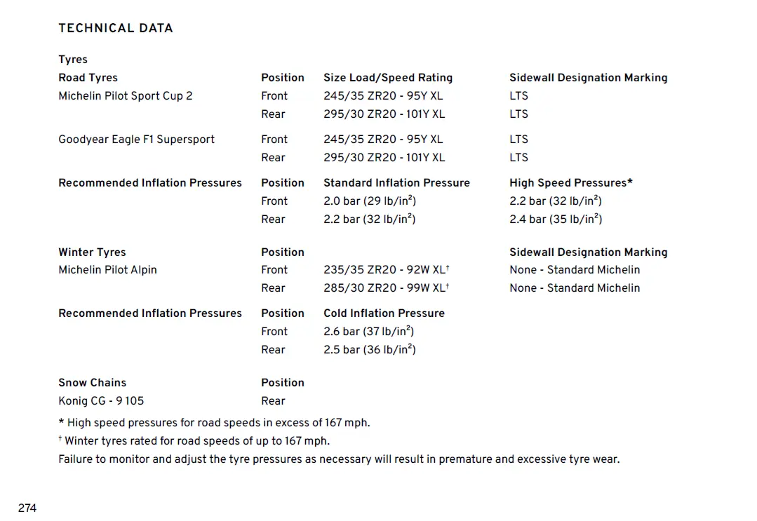

It's printed on the inside of your driver side door. I think it is the same for either tire, 29 F and 32 R cold. You could check and see if it's different for the GYs. I doubt it.
I am also guessing that recommended tire pressures are more related to safety and tire wear vs performance orientation.

I never plan to exceed 167 mph so I guess high speed tire pressure doesn't apply? I'm guessing this is more of an autobahn thing. I've never gotten close to 167 mph on a track either.
