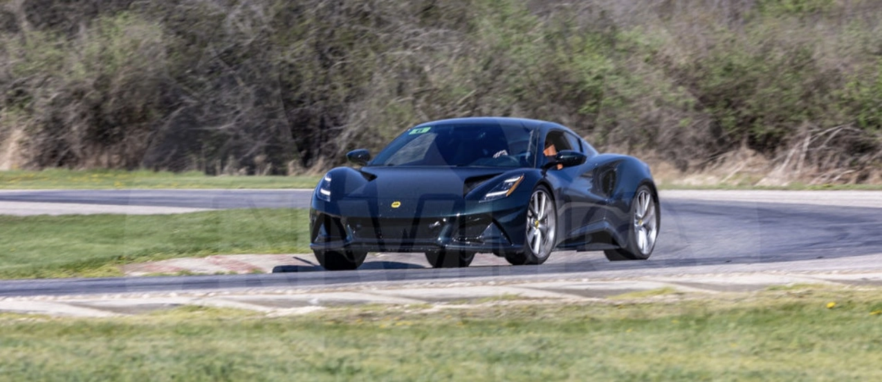

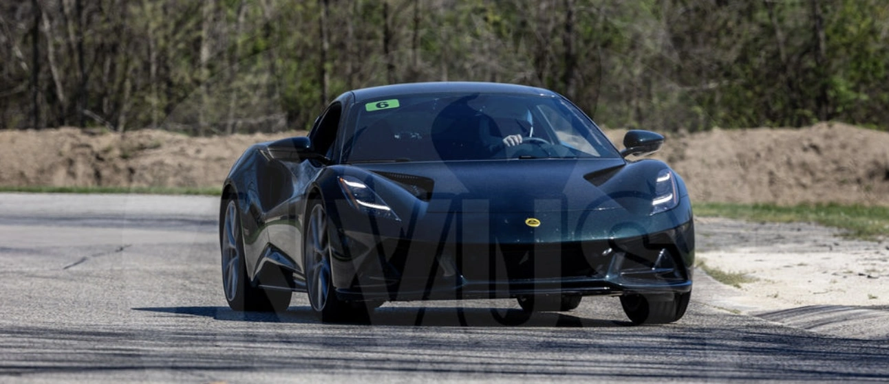

I have tracked my car 3 times since delivery in March…I did not change the brake fluid, since it was delivered with high-temp brake fluid. Brake pads still have plenty of life. As for tires, the Cup2s are great track tires, but after 3 track days and 3000 road miles they are nearing the end of their lives.

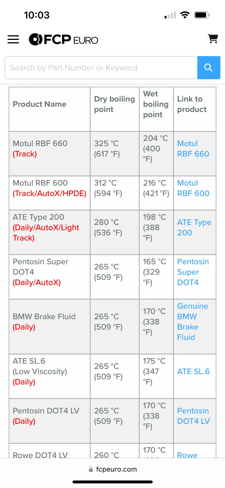

So interest enough I found the dot4 that lotus uses per the manual (pentosin super dot4). Looks like it’s about standard fluid for daily/autocross but looks like a few members have been able to use it on track without upgrading the fluid.

I’ve always run motul 600 or 660. I’m surprised that our stock fluid is similar to BMW stock given that our cars come with AP racing brakes. That fluid can get cooked on a track.

I agree with you on changing the fluid on our cars before a serious track day, based on the table above (and always using fresh bottles).
I’ve genuinely not heard of anyone prioritising DOT 5.1 fluid so I did a quick search - and it turns out that despite RBF600 being rated a DOT 4, its boiling points are actually far higher than 5.1. So the DOT rating is not particularly relevant, and we should be looking at the actual boiling points. There are many track day-appropriate fluids that are DOT 4-rated.

Many racing fluids are rated DOT3/DOT4. I've always assumed this is to make it clear to consumers that it is compatible with their cars. They can label it that way because those only indicate a minimum standard and they are way above it. High temp fluid of your choice is a good answer. Off the shelf DOT5.1 fluid is going to be the most economical high temp fluid and is what I use even in my endurance racing cars.

It appears the reason - at least in RBF600’s case - is the viscosity at very low temps is slightly too high to meet DOT 5.1 requirements. Obviously the stuff we care about ie boiling points well exceeds.
