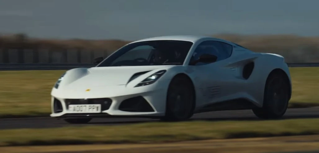

If you watch the Top Gear review, on the prototype car during hard braking/cornering, the tire almost touches the wheel arch in front.
So yeah, the touring suspension travels quite a lot.
I don't really like it... let's hope the sport setup will be stiffer (and ideally a few mm lower, even though they say it'll be identical in height) - I can tell from experience on my previous cars... even a few mm in suspension height or tire width can make a big visual difference.
So, the more I look at photos, the more I can see myself putting on some maybe 15-20mm spacers, depending on what it looks like with measurements/clearance. I'll decide on anything else later, but I love making wheels look flush to the fenders, and since I am not going to be driving it in wet/muddy conditions, I am not concerned with them being farther out to the sides and spraying onto the fenders.

So I believe the First Edition is actually lower? I seem to remember reading that somewhere.. You can see in Shmee's walkaround video here of the FE that its sitting lower than the white car.. The front wheels look bang on.. i guess the rears could be spaced slightly but I think this video from Shmee gives a great look at how it sits.. This white car just doesn't look right in a lot of ways.. best to wait for final FE reviews I think.
I actually think this car looks too low! Plus every car in which I've installed Eibach suspension is "settles" after some miles have been put on the car. I'm not worried about it.
