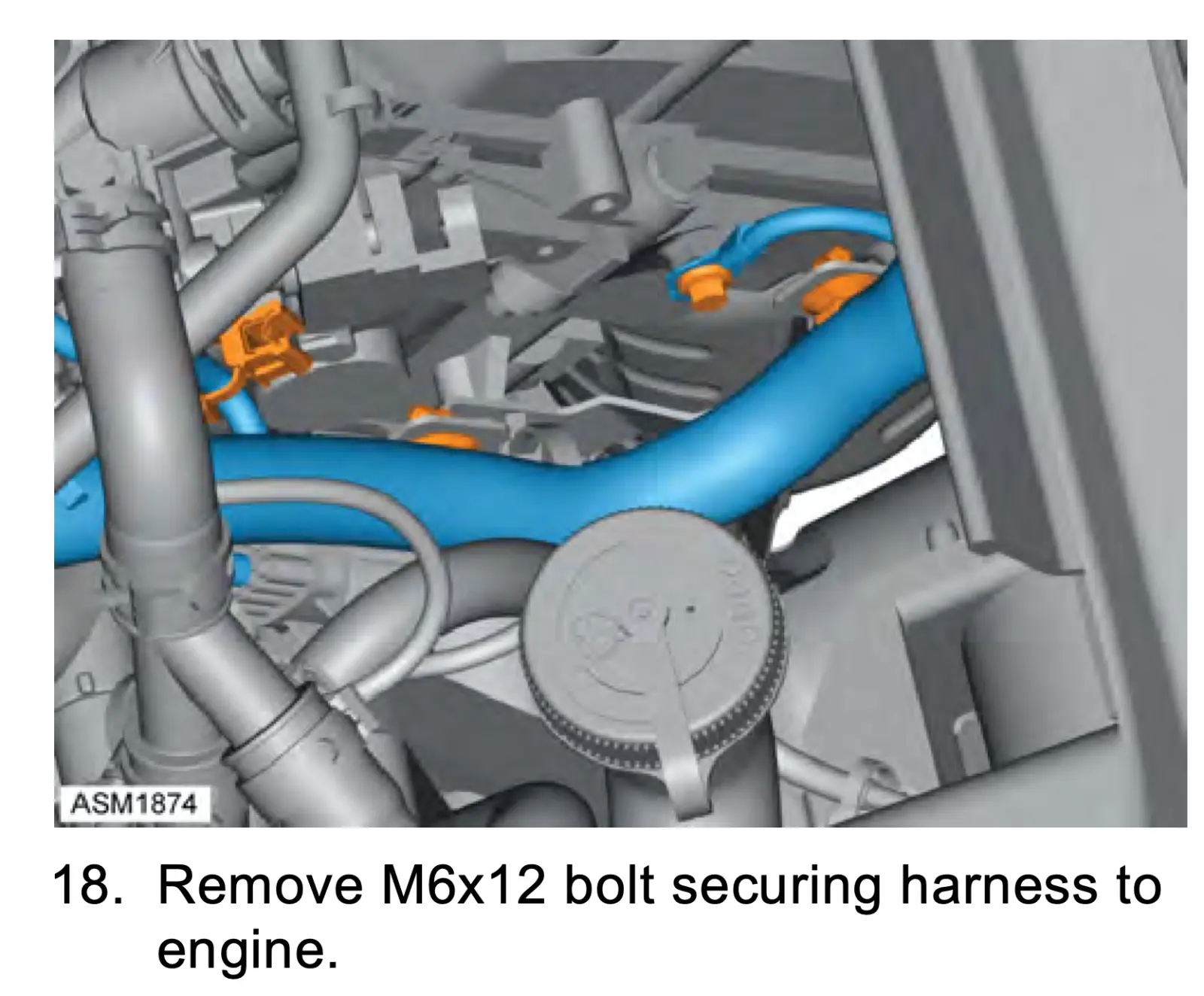

Battery? Check to make sure the cables are securely attached to the battery posts. Have the dealer do a battery health check; make sure it's charging properly and holding a charge. Could be an improper ground connection somewhere. Check the ECU (Lotus calls it the ECM) connection to the engine (which is the ground connection for the ECM). It's the orange-colored bolt in the middle of this diagram. Check to see if it's secure, and clean. If it doesn't look right, remove the bolt, clean it and the contact surfaces of the cable end and the engine, then re-install. They don't list the torque spec in the manual, but for an M6x12 I'd guess 10nm.
