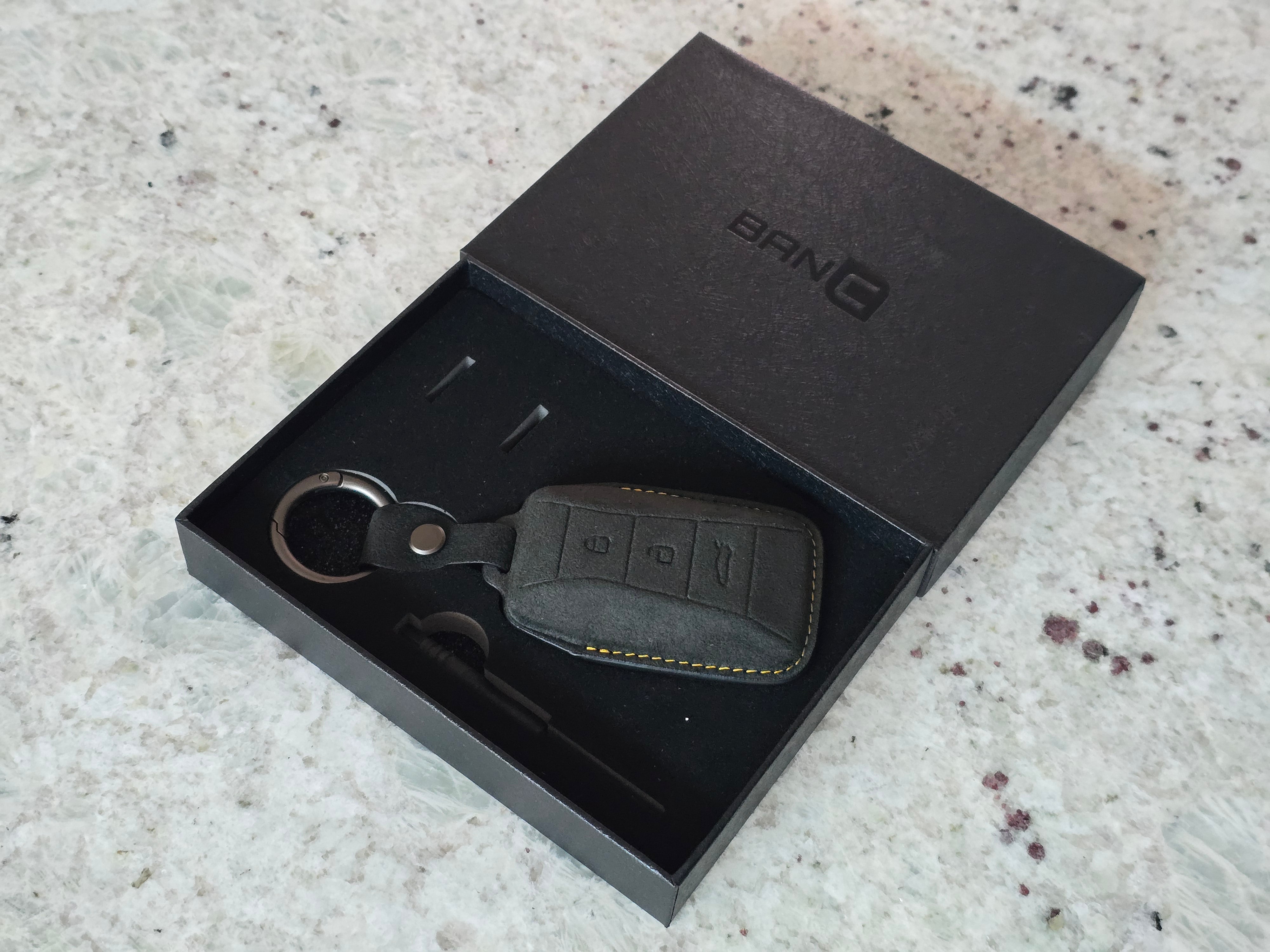

One of these :
will help reduce the pocket thing quite a bit (but not entirely), and some reusable car dehumidifier bags from Amazon (Sorry - Amazon links not working on here for some reason) should help with any residual moisture once you've had a go with towels, wet 'n' dry vacuum, etc.....
