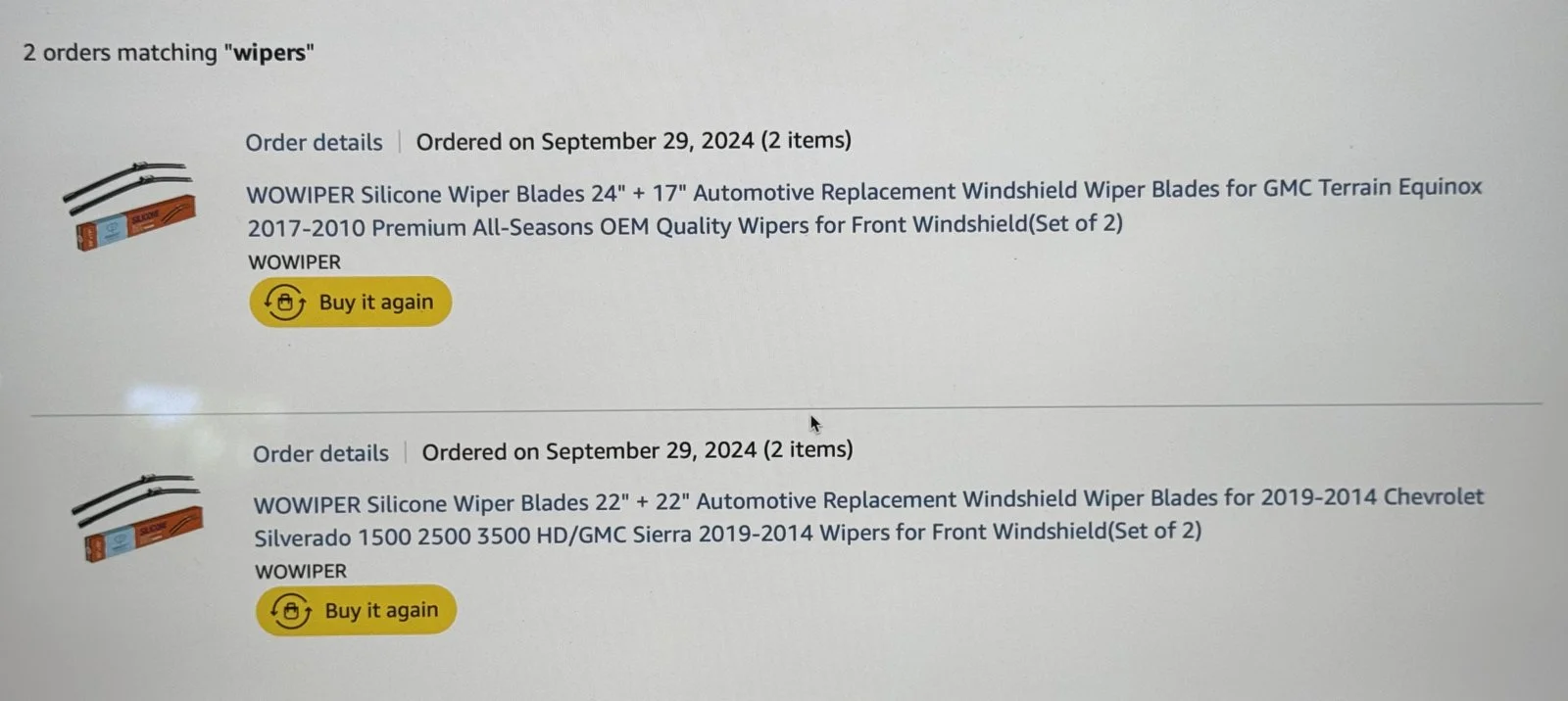

I had the same problem from the onset with my blades, particularly with the longer blade shuttering on every use, so I decided to try some silicone ones that I found on Amazon. They're purchased in pairs, but are fairly inexpensive, so I used a 24" and 22" from the sets which, despite being a little shorter than the OEM sizes, worked perfectly fine. I've had them on since Sept. 2024 and I've been very happy with them. I'll never re-installed the OEMs since I haven't experienced any stuttering at all with these and despite the slight size difference, I can't even tell the difference in windshield sweep area from inside the car. Hope this helps.

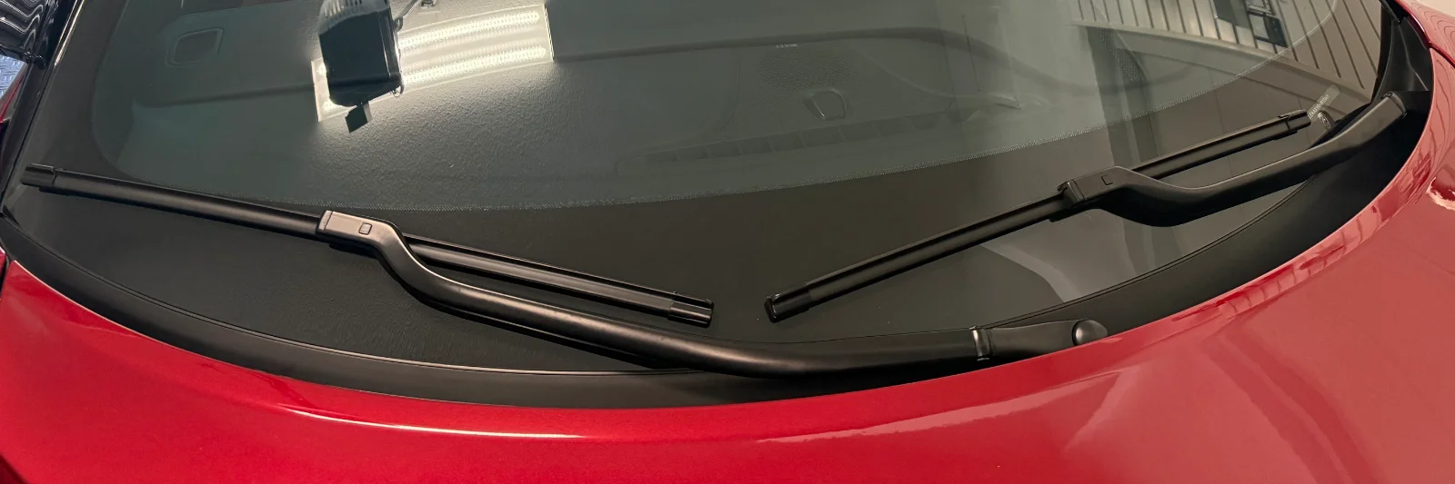

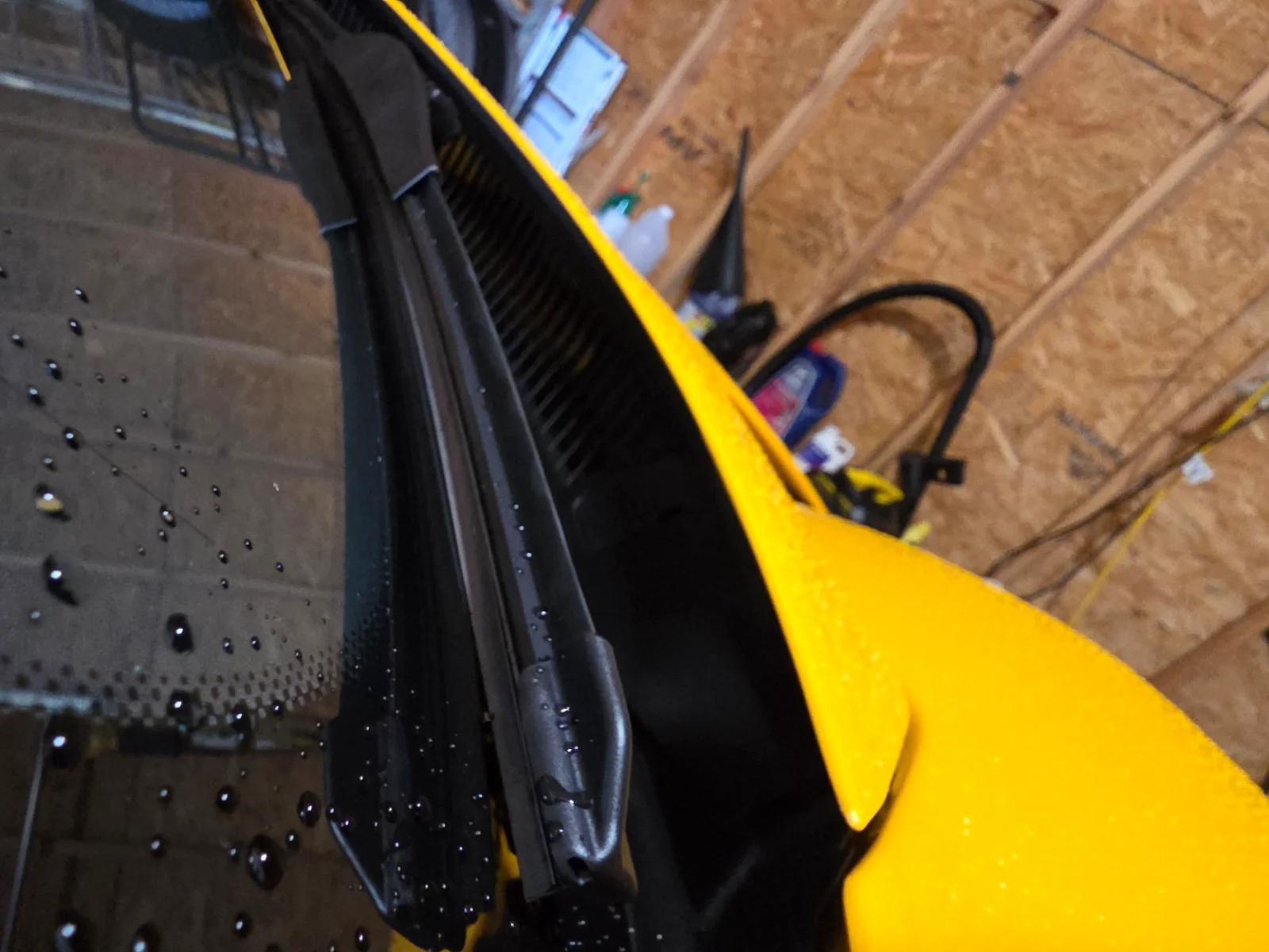

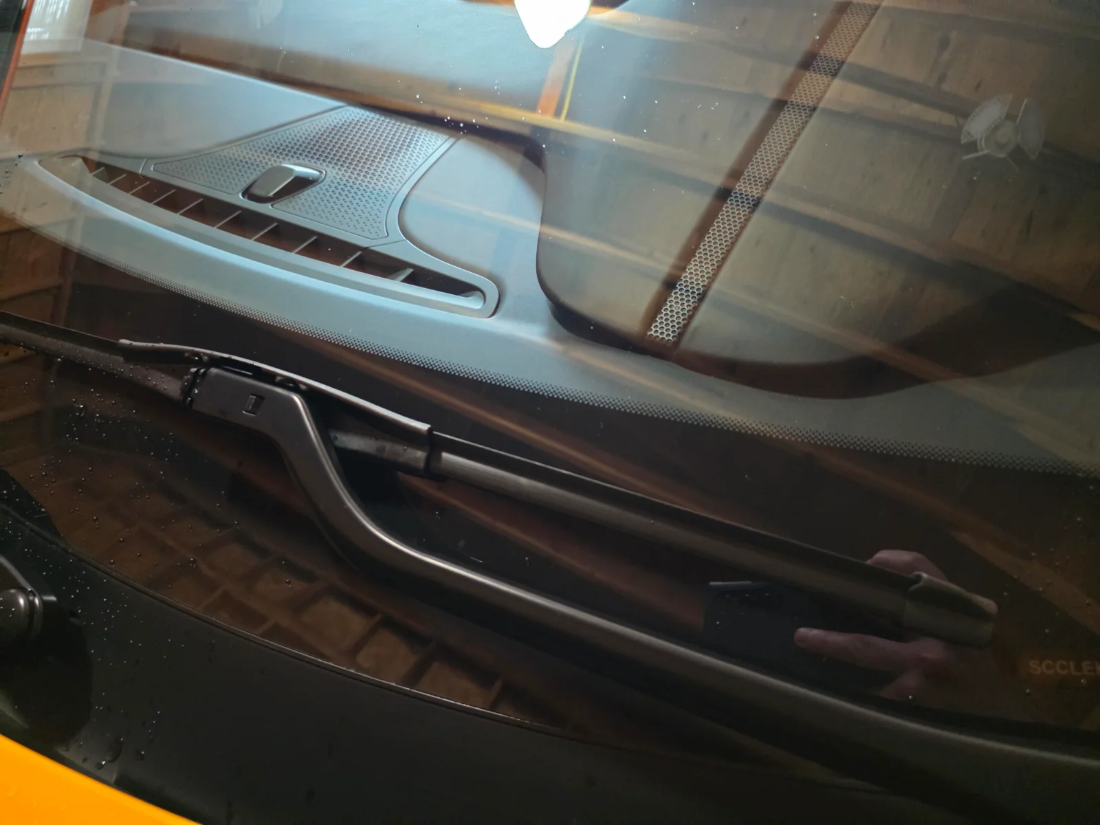

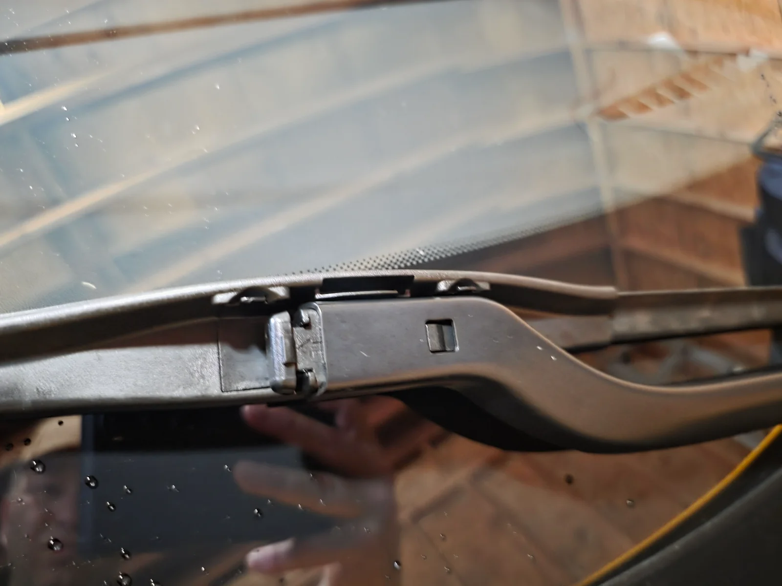

Thanks for this info. I got Trico Silicone Ceramic in this size (from NAPA - $40 total) and it is an improvement. Still a bit of stuttering, but not as bad as OEM. They are a bit chunkier due to the construction, and the very last 1/2" of the passenger side wiper is not flush to the glass in the down position. I didn't notice that creating any issues at high speeds, or in use. Here are some photos and here is a video of them in action. Installation requires snapping in the 22mm adapter, following the instructions here, which was pretty straightforward.

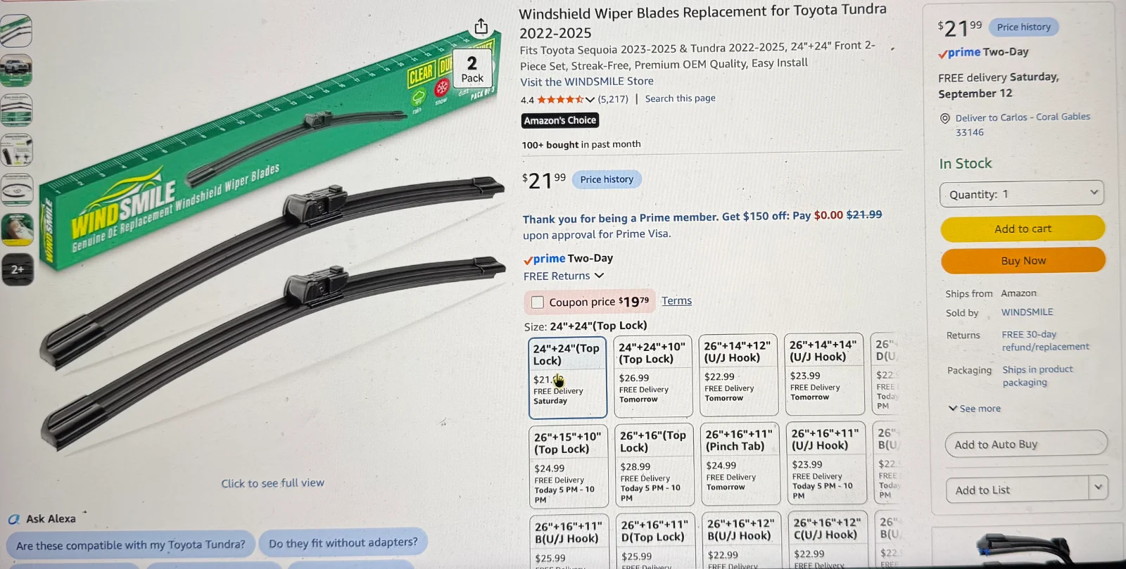

Glad it helped. For whatever it's worth, on my last wiper blade swap, I decided to give it a try with 24" blades on both sides. Honestly, I couldn't tell any difference at all in performance or swept area compared to the odd sized OEM's (25"/23"). Availability and brand selection for 24" blades makes it so much easier to get what you want and find them sold in pairs.

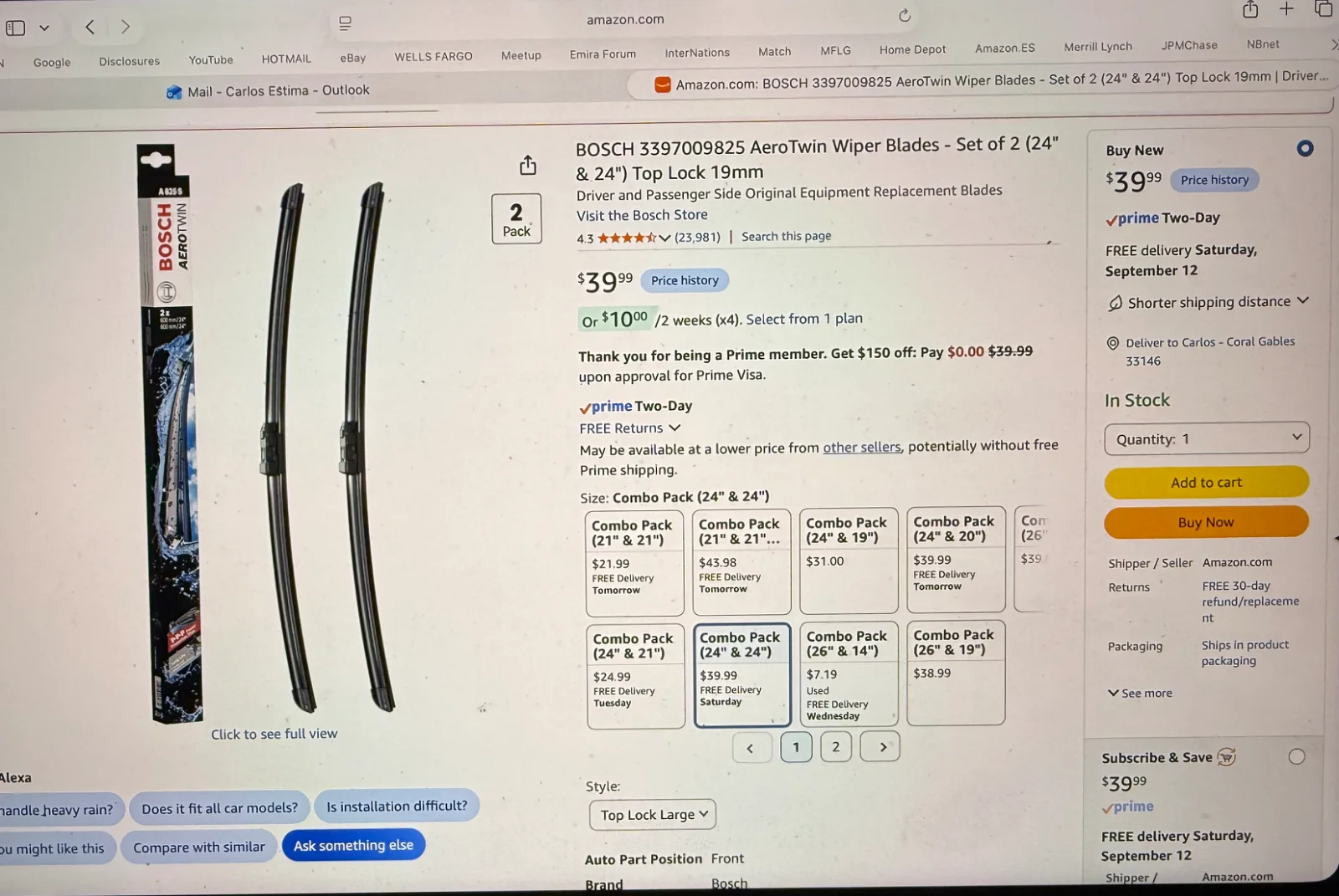

Which brand? Where did you get it?
Put these on mine, worked great and slightly shorter to avoid the shuttering. I ordered them from Tire Rack.
22" PIAA Si-Tech Silicone Flat Wiper Blade
Vendor Part #: 97055A
24" PIAA Si-Tech Silicone Flat Wiper Blade
Vendor Part #: 97060A
