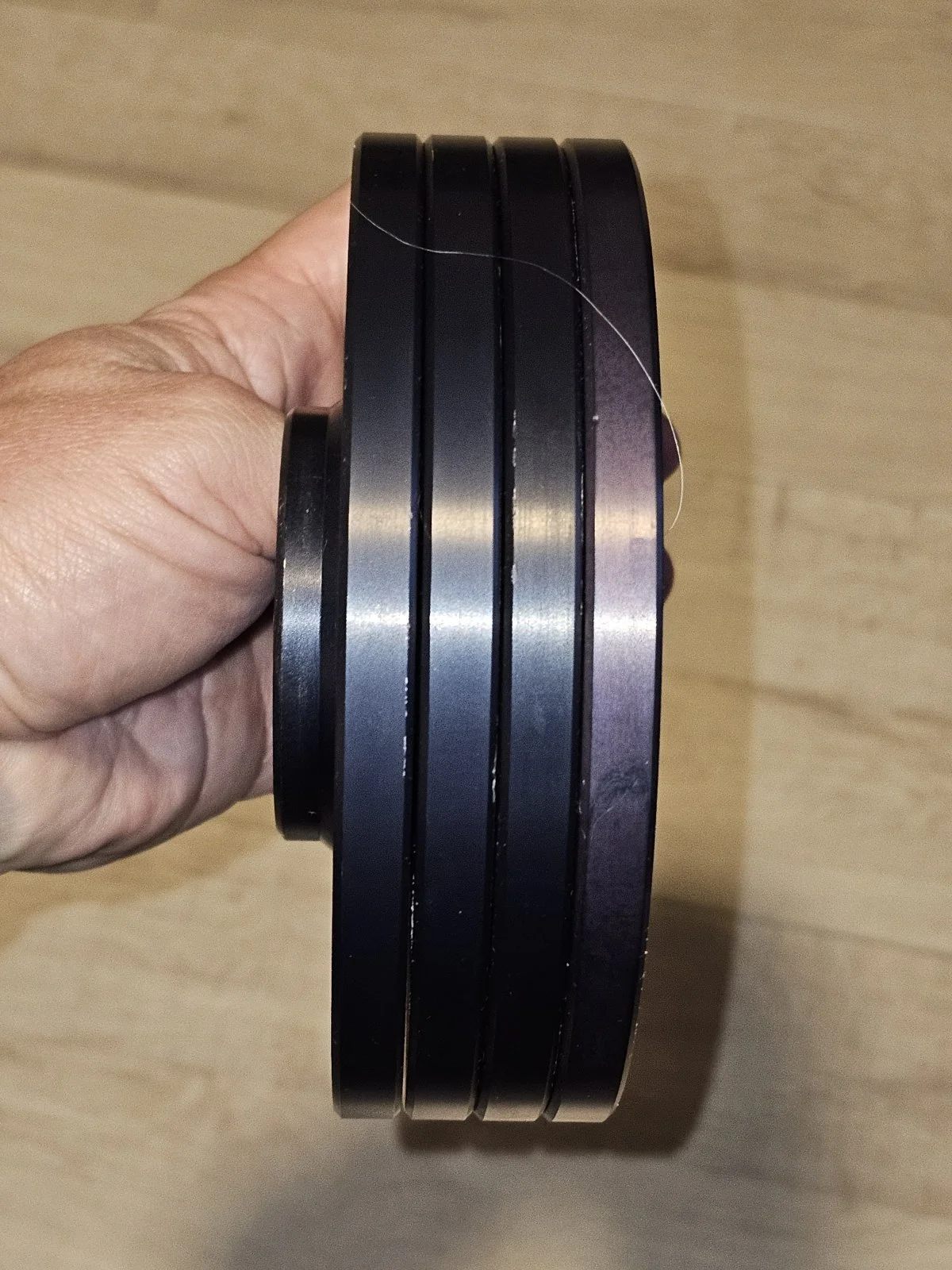

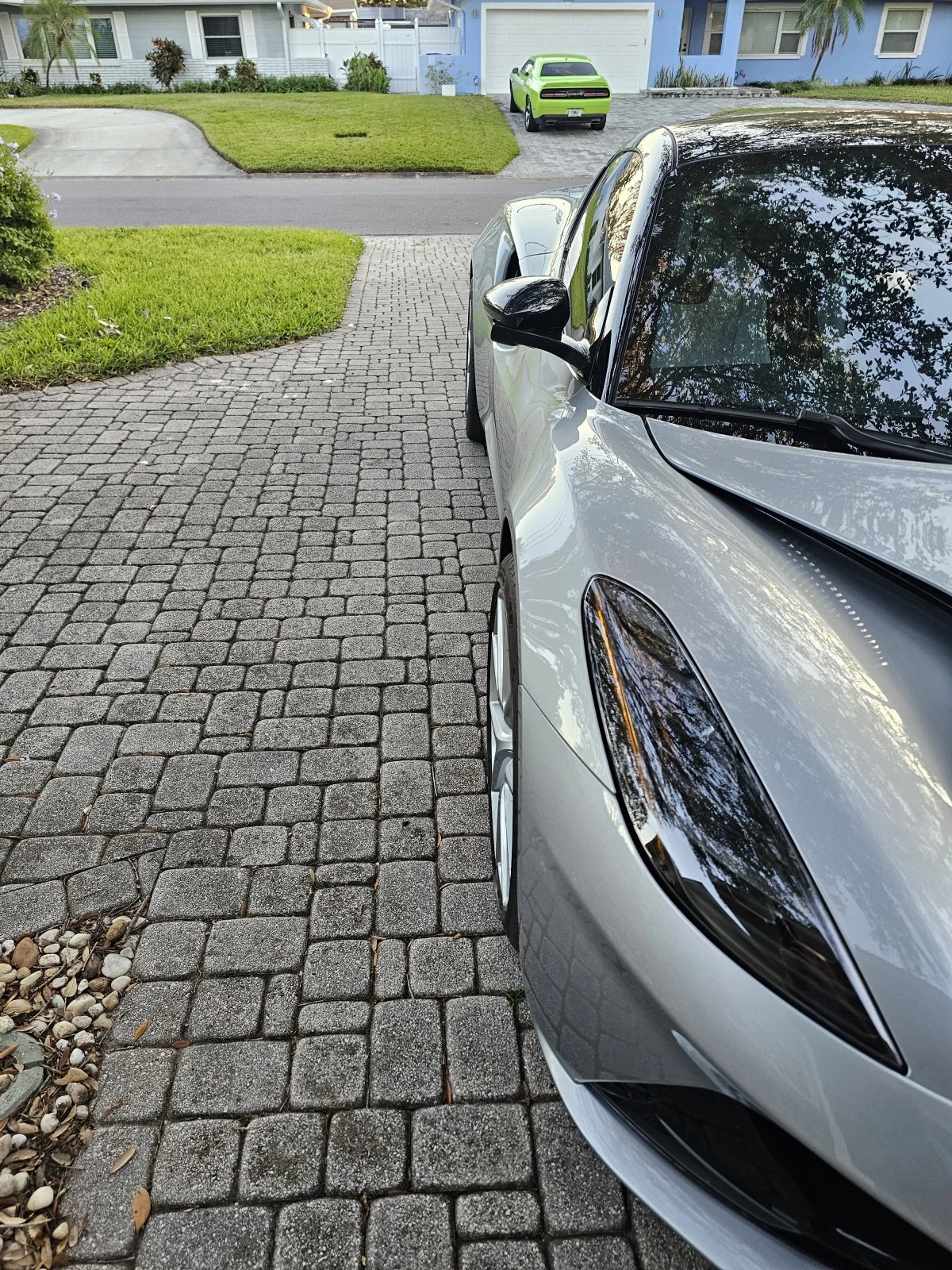

So I know people didn't think it was possible for hubcentric spacers at 10mm. But here is proof.
Got these from crestima (thanks again).
Putting them on Saturday. I just think 12mm sticks out just a hair too much on the front so I wanted 10mm. I might buy the 12mm for the rear of it bothers me but I'll see what I think once they are in.
***Added pics of the spacers so people can see..
Here are the pics....

10mm hub centric is absolutely possible -- you're just giving up 2mm of hub extension to fit into your wheel bore. That's fine as the hub extension used to hold the wheel on anyways, it just provides a centering interface.

Source? Price?
  • #4
I don't know what they originally went for or where to get them as I got them from @crestima .. He can hopefully let everyone know..
I didn't like the 12mm in the front as I felt they stuck out just a tad too much.. I didn't plan on lowering the car so I am going with this for now.
Sorry I can't help here with where to get them.
I bought 12mm spacers from GRP. I think 2mm difference would be hardly noticeable by eye
Reactions: GRP
Source? Price?
Check out my August 23rd post on the thread entitled "12mm spacers, seems a bit much on front". You'll find the detail on how to go about special ordering the 10mm PCDs. Hope this helps.
