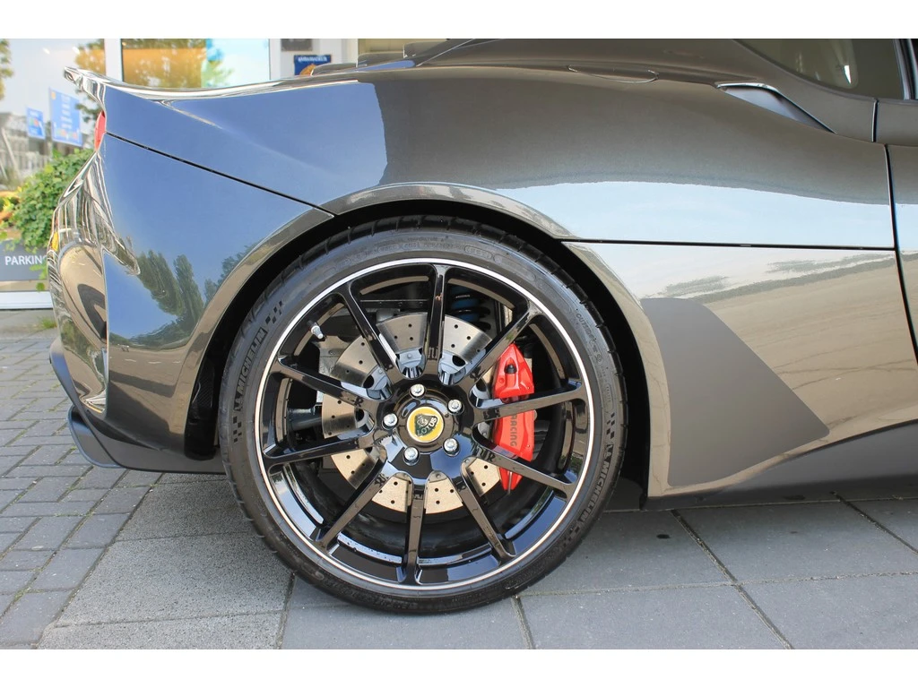

With my '21 Evora GT 410 Sport I changed the OEM Lotus pads for EBC Red Stuff pretty soon.
The dust amount on the wheels is reduced, however some dust always remain.
Especially as the GT 410 Sport has the shiny black rims
After every drive i clean the rims with a towel.......it takes only a couple of minutes.
The stopping/braking power of the Red Stuff is excellent; I do not notice some significant difference with the OEM pads.
