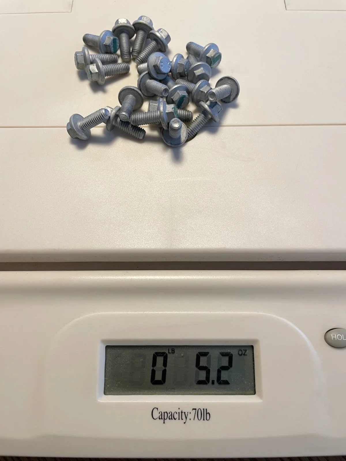

I replaced 21 hex head bolts for .79 cents each. That many of those titanium bolts would cost $48!
Just for the sake of interest, I weighed the 21 bolts I replaced; the whole group weighed 5.2 ounces. There isn't enough potential weight savings there to bother with paying for lighter bolts. I replaced these with the button head screws mostly to clean up the appearance underneath the front.

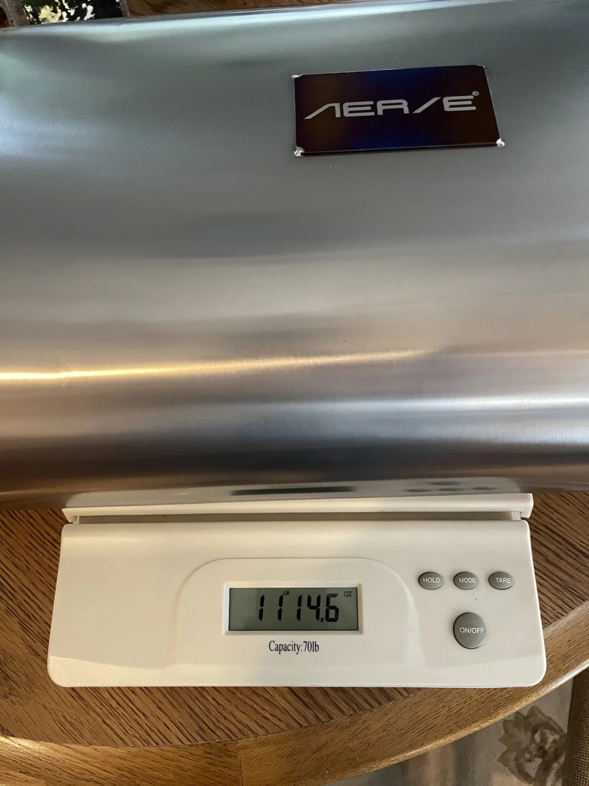

I received Aerie's titanium muffler yesterday. Because I've bought other things, and I'm a good customer (I think), they made me an offer that was too good to refuse lol (don't ask, I can't say what it was). This is a new revised one, that's supposed to fix any issues with the valve and what not. I also weighed it, and at 11 lbs 14.6 oz it's lighter than the previous one they show on their website which was 14 lbs.

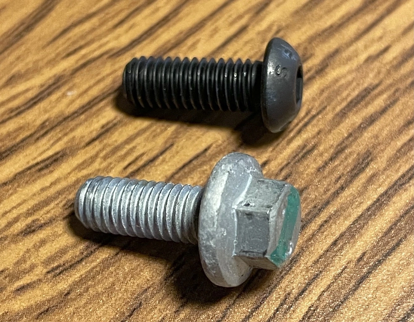

I've noticed on front shots of the car, you can see the hex head bolts underneath holding the front body pan on. When I saw a picture (great shot too) that @kitkat posted of his red car, I decided to do something about that with mine.
I went to the local Ace Hardware store and got black button screws (M6x16) to replace the hex bolts. The manual says to torque them to 3 ft lbs (4 nm) which is a hand-tighten. The hex head bolts need an 8 mm socket, and the button screws used a 4 mm allen wrench.

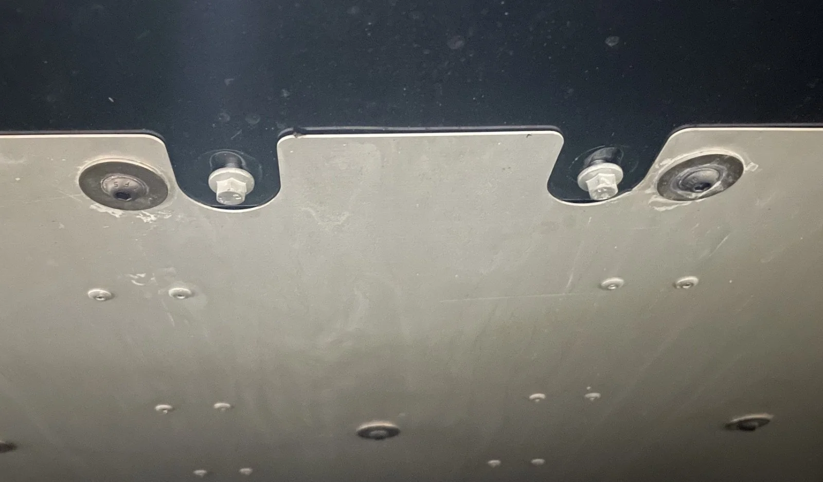

As I was doing this, I noticed two things. One, there are 4 hex head bolts that bolt straight into the body panel, and for some reason they didn't have any washers under them. You can see the two in the front of the car in the photo below. If you'll look closely, you can see there appears to be an imprint in the body where there was a washer at one time. What this means I don't know. ?? So I'm going to go get some washers and use them when I replace the hex head bolts with the button screws.
The other thing I noticed was the aluminum underbody panel makes a lot of noise, like a drum. Now I'm thinking some of the road noise may be coming from at least this one underbody panel vibrating, and maybe others too. Next time I have the car up on the Quickjack, I'm going to remove this panel and put some Damplifier mat on the backside, to dampen it and stop it from vibrating. This may be the source of at least some of the road noise, which will be a lot easier to remedy than removing wheel well liners.
