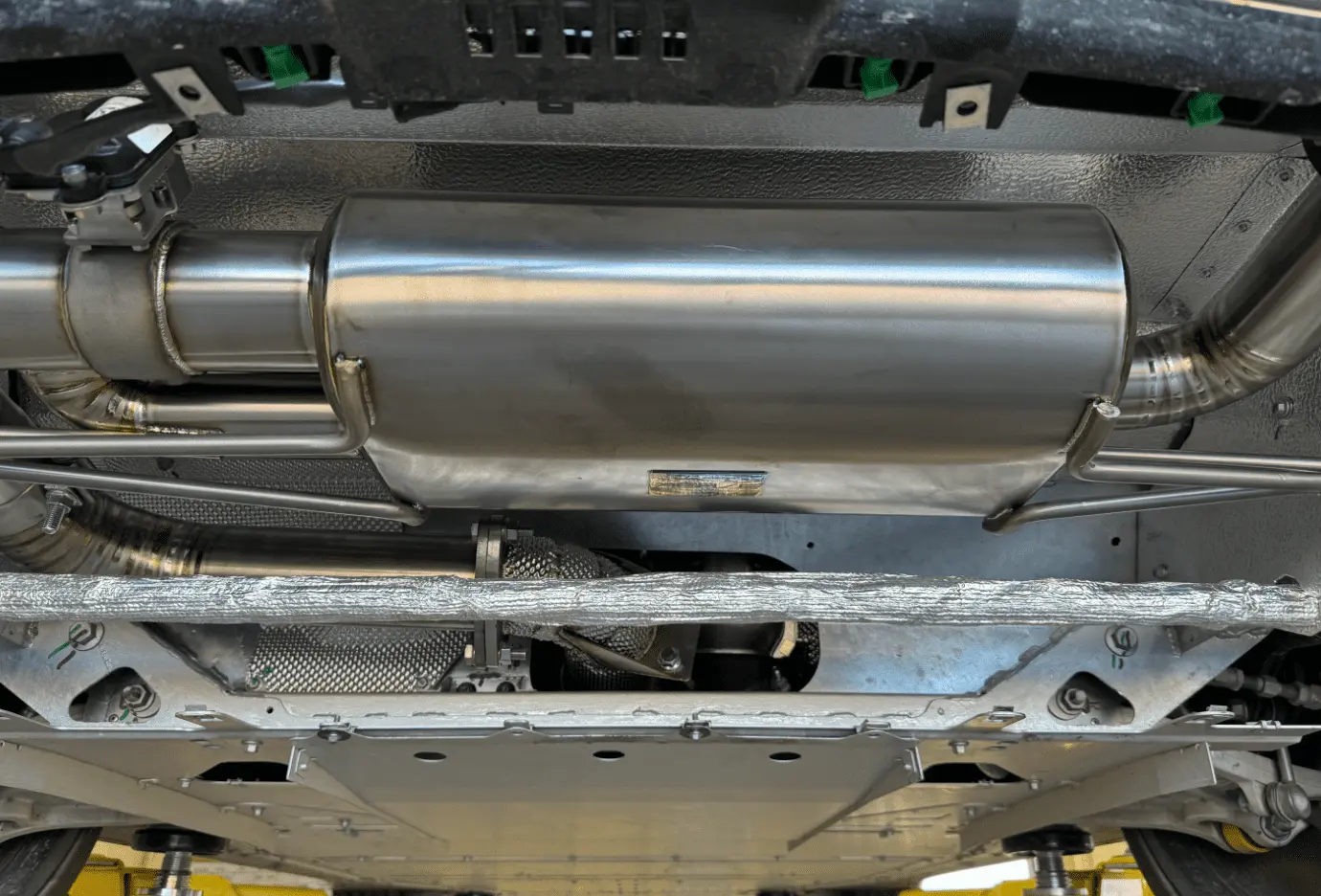

Took about half a day.
Had to remove the diffuser and engine base plate. Removed the sway bushings to let the bar move out of the way.

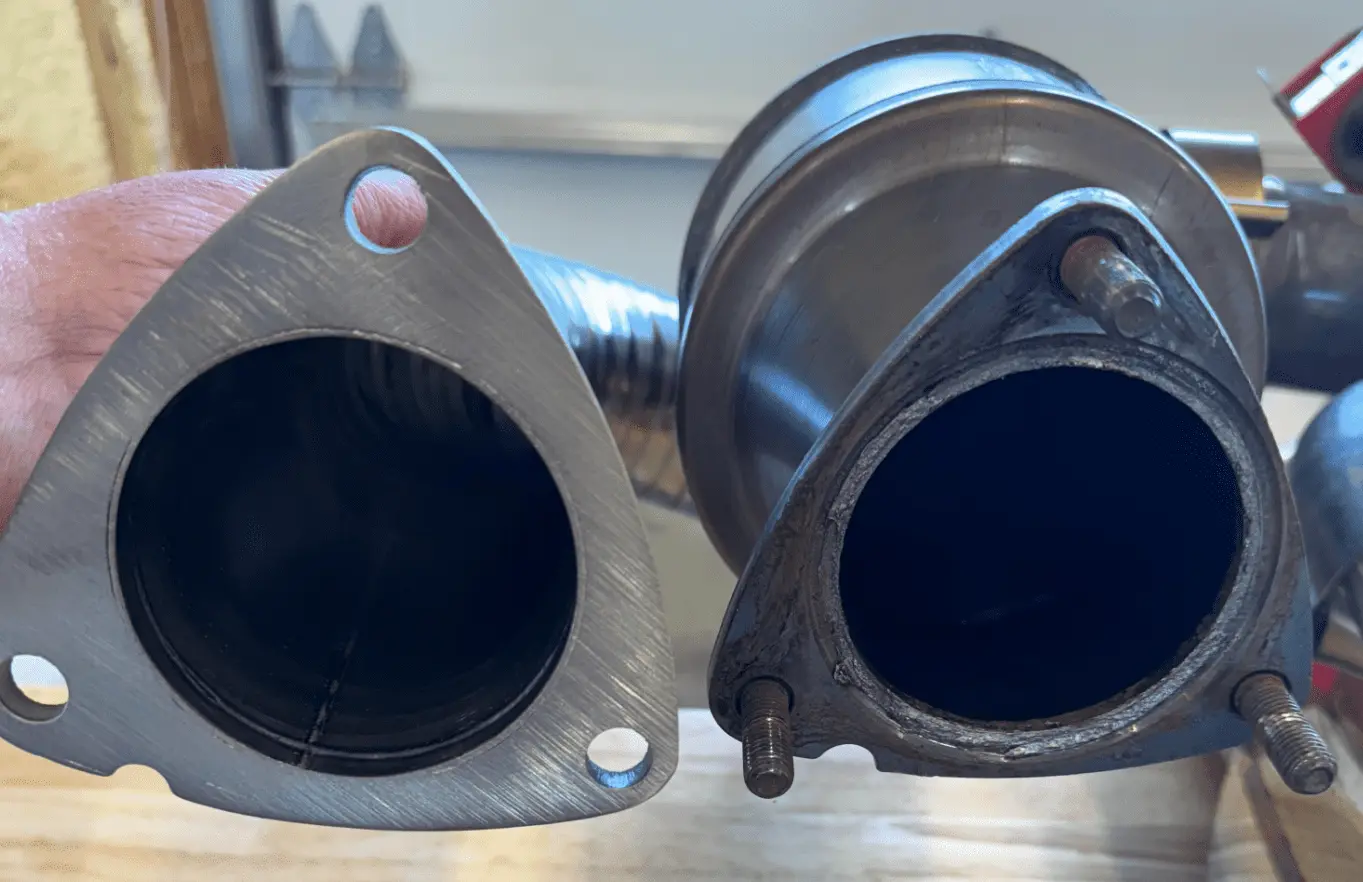

Aerie had send me the Y-pipes with the heat shielding as an "upgrade". I did not plan on using (I had ordered the non shielded Y-pipes for min weight), but the back section and 3rd cat bypass is not compatible with the stock Y-pipes.
Aerie on the left, stock on the right. The Y output does not fit into the bypass and there is a flange on the stock rear section that the Aerie bypass flange has no relief for.
So, I needed to mount the heavier Aerie Y-pipes. Bolts very accessible, but, the stock M10 bolts have a shoulder that does not pass though the slot. Had to find replacement M10x1.25pitch bolts.

I did not end up using the Ti tips. I prefer the stock ones with the classic Lotus diamonds.
I also bought the Aerie "diffuser" but I didn't read the small print properly. The carbon pieces just cover the existing diffuser fins. Not quite what I expected.
Sounds a bit louder. If there was a non-valved (straight cat-back) version available I would have preferred that.

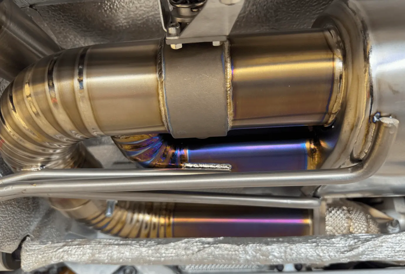

Will run it more tomorrow and take pics of the Ti heat - colour anodizing.

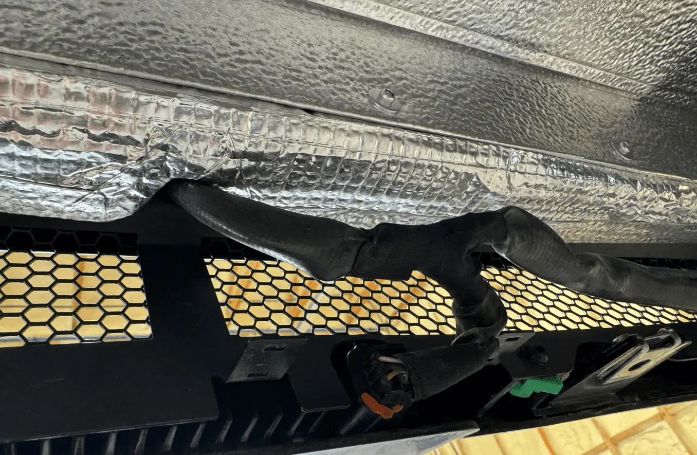

One more glitch - The Aerie configuration relocates the valve servo. The cable ties on the sensor connector harness need to be cut otherwise it wont reach the connector. Cutting the cable ties leaves the servo harness stretched diagonally and not hidden neatly behind the structure surrounding the rear grill. Not a huge deal to me, but it may be to others.

I did not make a weight comparison. The issue is that Aerie sell the exhaust and y-pipe separately - the exhaust does not fit the stock y-pipe - so they need to be purchased together.

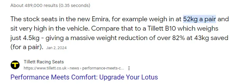

Tillet seats will reduce weight by 94.8lb. Other than exhaust parts and battery, I'm not sure what else can be modified besides minimal gains from CF replacement parts which can't add up to much. Still, 1400kg with seat replacements will be easy!

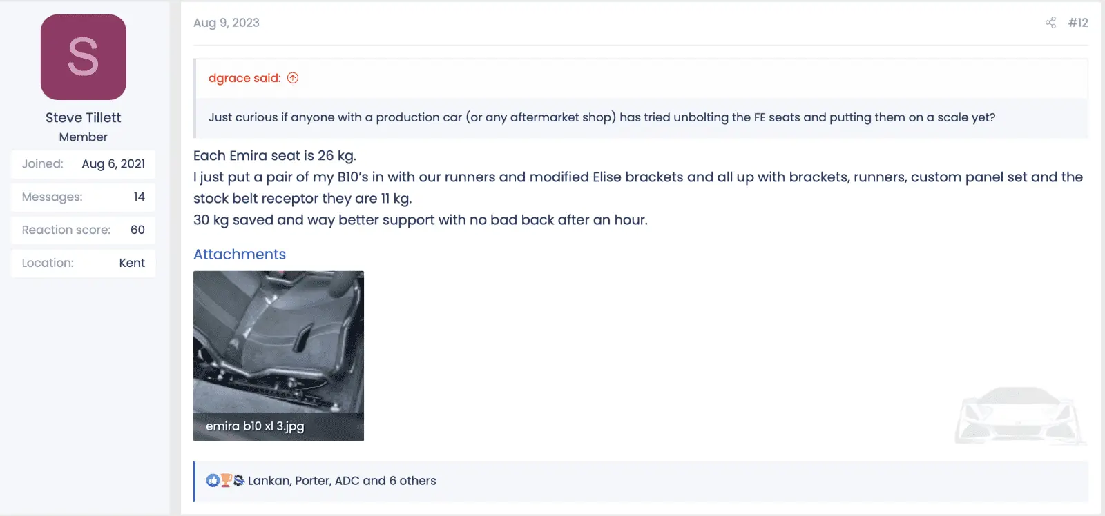

Tillet seats weigh 24.25 lbs each. The factory seats weigh 114.34 lbs (57.32 lbs each). One Tillet seat removes 33.07 lbs, so both would remove 66.14 lbs, not 94.8.
The easy weight reduction parts are battery and wheels. Exhaust and seats are more difficult and more expensive, but all that adds up. Figure about 55 lbs saved for battery and wheels, and about 90 lbs saved for ti exhaust and seats. That's 145 lbs. The car stock has been weighed in Europe, and it was 3,232 lbs (1,466 kg). Getting down to 1,400 kg (3,086 lbs) requires removing 146 lbs, so doing the above gets you there. It'll run you about $10k, but you'll reach your goal. I don't know if I'd call that easy; certainly not cheap, but it's doable.

[...] The issue is that Aerie sell the exhaust and y-pipe separately - the exhaust does not fit the stock y-pipe - so they need to be purchased together.
Yeah I think they have a new version of the exhaust that bolts directly to the OEM Y pipe.
Aerie
Supporting Vendor
Nov 12, 2023
169
472
HK
Yes , the new batch of titanium exhaust system de-cat down pipes will be fit OEM y-pipe .
