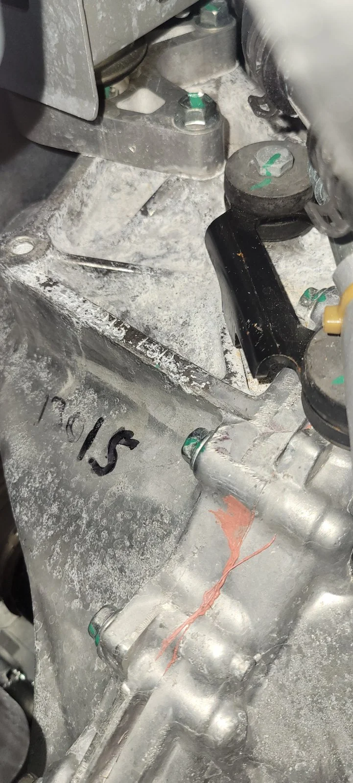

Has anyone over the years with their Lotus used any spray protection on Aluminum
suspension / transmission to maintain them from corroding??
I just sprayed my transmission housing with CRC Marine corrosion inhibitor... it had a bunch of white flaky crap on it that I noticed when doing the short shift mod. It seemed to work well. (Before pic below)
I just sprayed my transmission housing with CRC Marine corrosion inhibitor... it had a bunch of white flaky crap on it that I noticed when doing the short shift mod. It seemed to work well. (Before pic below)View attachment 57864
Do you have after Picture you can share.. Is this something you will need to spray few times a year ??

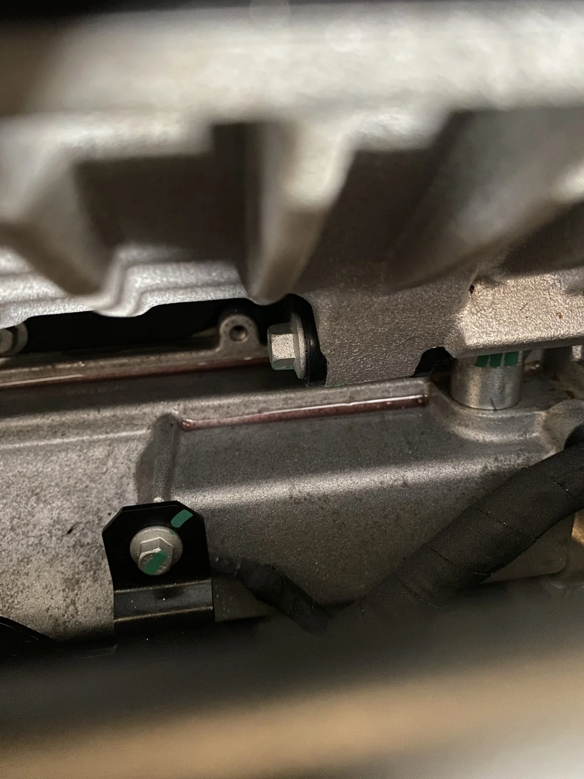

I didn’t clean or prep anything. Just sprayed it on the first week I received the car. It did run a bit and collect in areas. See pink liquid in attached picture. I didn’t bother wiping it but you certainly could.
