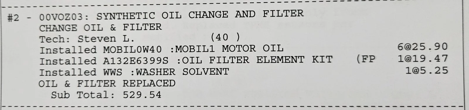

Lotus of North Jersey:
$349 labor for ~2 hours work, this is on the high side.
Mobil1 oil cost is the same if you buy from Walmart (Euro car formula), no issues there.
I got mine changed in Nashville, Tn at dealer and end price is the same. IDR about the breakdown.

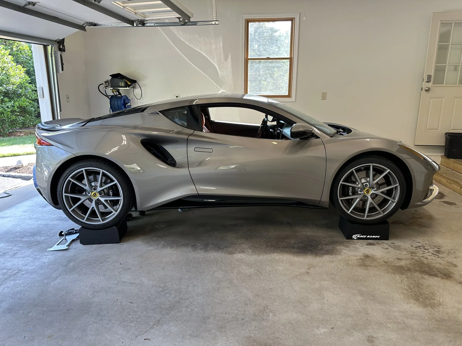

I put mine up on race ramps wheel cribs. Went with the 12” two piece ramps, so 6” under each wheel. It gave me enough room to get under and remove the under tray. It was tight but doable.
I have race ramp wheel cribs too, but the 10” that comes in 5” sections. It gives me more room underneath and I can use a creeper. My method involves lifting from rear jackpad on one side, placing one 5” section under each tire on that side. Then go to other side and lift from rear jack point, place full 10” wheel crib under rear tire, jack stand (esco flat top) under front jack point. Go back to first side and lift from rear jack point and put full 10” crib on rear tires and jack stand up front. I liked this stepped approach better than doing all 10” at once since that’s a bit sketchy

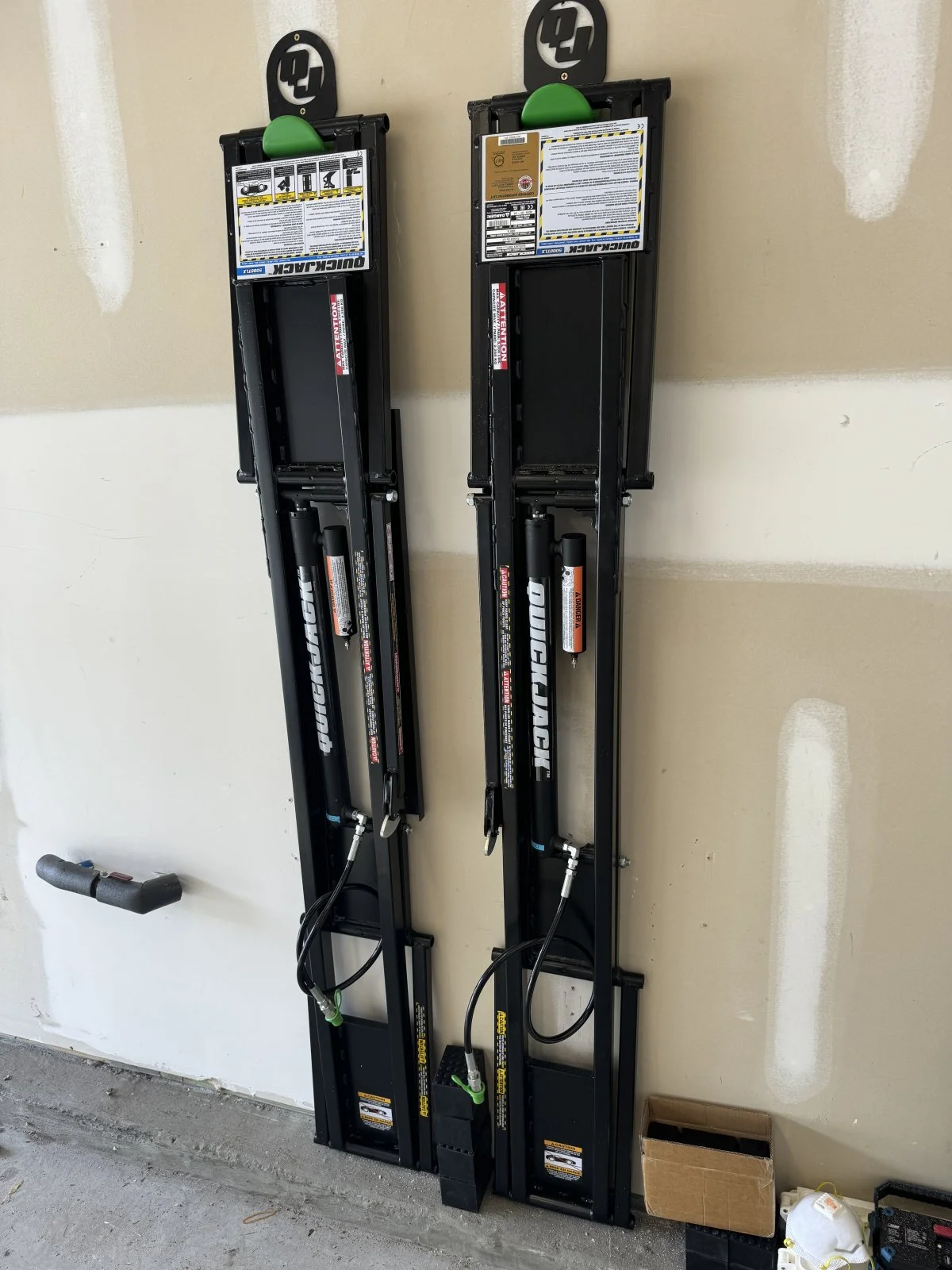

Having used ramps before, which work….life is much easier since I got the lift. You can catch them on sale occasionally ….. the QuickJack 5000TLX works for all my cars.
