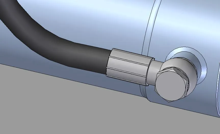

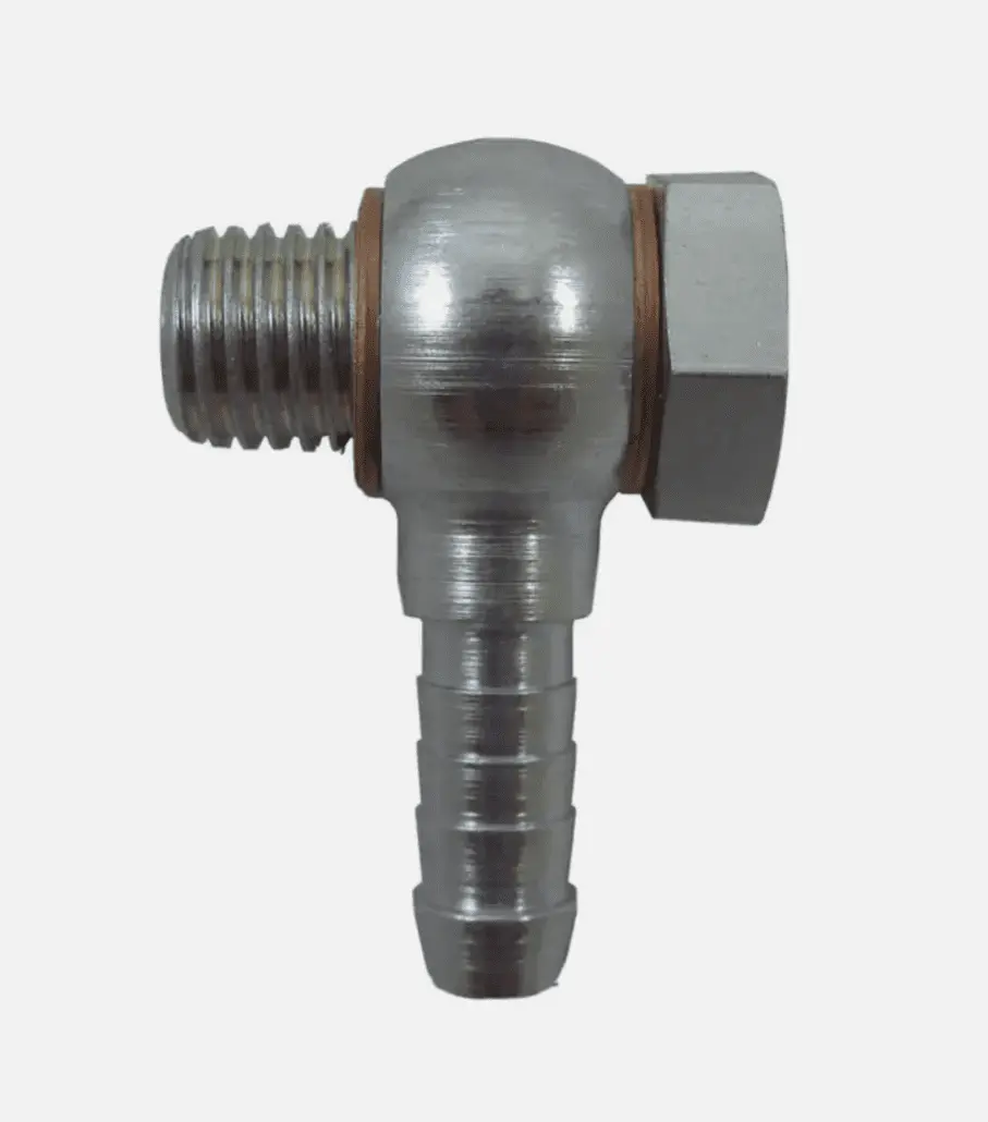

I must admit, I've never heard of a bingo bolt before now... did you mean banjo bolt perhaps?
  • #33
Good to hear you got this sorted. The trim tether sounds like the airbag recall issue, so that's good to have sorted too 👍
:ROFLMAO: Yes that was it a banjo bolt not bingo, is it something to do with the brakes?
😂 Haha that's awesome. It really is a funny term, I don't blame you for mixing the terms. So many terms in mechanical fixings and fasteners are weird colloquialisms.
A banjo bolt is any bolt fixture that allows fluid through an integral orifice into an attached hose fitting. Typically they involve a bolt-through collar that is sealed to the bolt head and the mounting face using copper (or other crush) washers.
[edit] found a good brief explanation on a motorcycle site: https://www.revzilla.com/common-tread/what-is-a-banjo-bolt
