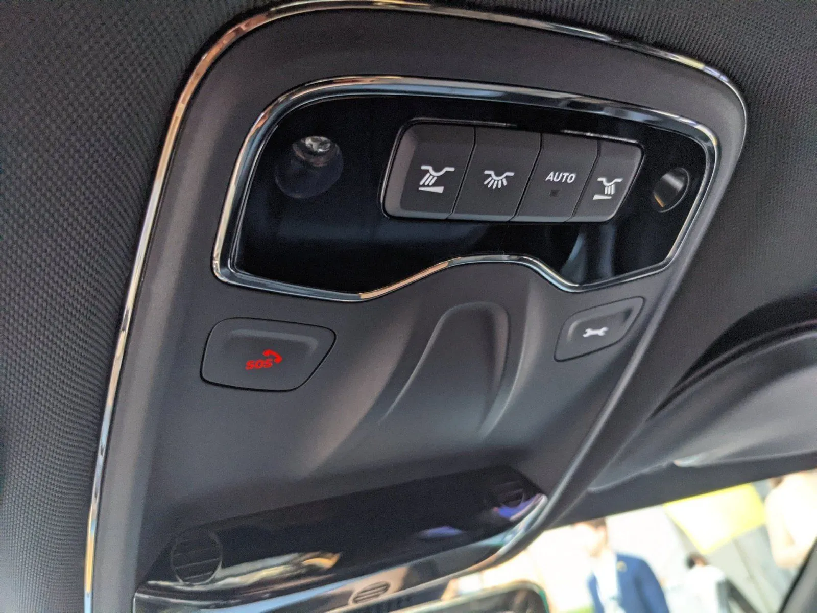

The show car had a USB C in the roof panel - hope they kept that....
Good spot! I was thinking the roof panel was a good place to splice into the wiring but hadn't seen a USB socket. Maybe that's it at the bottom of this picture (ie the front of the car):

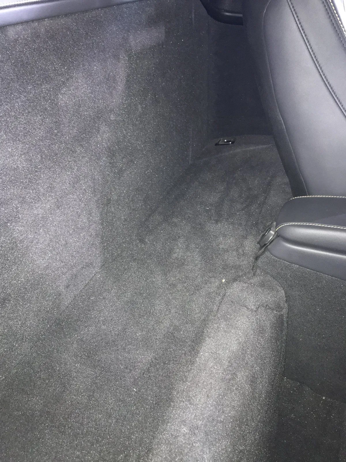

It might be further forward of the lower USB port, under the dash (Evora has one there) or behind the armrest bin. The Evora has one there, which makes more sense as it's in the rear of a 2+2 but makes less sense in a 2-seater. Is this it, just visible as a flip-up cover behind the armrest?

I saw it on the grey car at Goodwood - didn't check the blue one.... Scott mentioned it to me as a great bit of thinking... I hope they didn't remove it
wait... what?! I could swear I looked for one during the roadshow, for exactly the purpose of wiring a dash cam without the palaver of running all the way across the windscreen, down a pillar, etc.
was probably just blind with excitement, to be fair... :D

Has this been confirmed by anyone at the factory tour yet?
Not by anyone on factory tour, but it was answered on another thread (perhaps one about goodwood) that NO it doesn't have USB C in the roof panel unfortunately
TomE
Aug 10, 2021
6,427
14,641
Surrey, UK
That's right, confirmed by me on the Goodwood update thread that there is no USB or other socket in the roof panel. There's obviously power provided to that panel, so it should be possible to tap into it. But a shame the port hasn't been retained.
