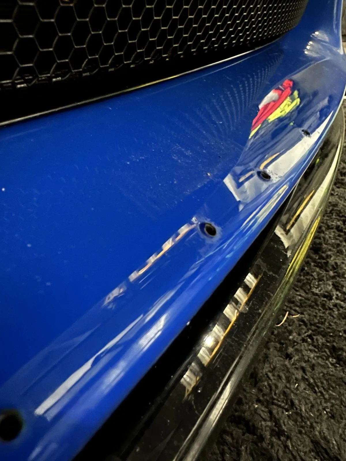

They are stuck onto the front mount which is then screwed into the bumper.
Where the mount is screwed in they’ve made rather horrible raised little holes. I was hoping to remove the front bumper and put some v small little black bungs into the holes… I now think that will look worse than the number plate.

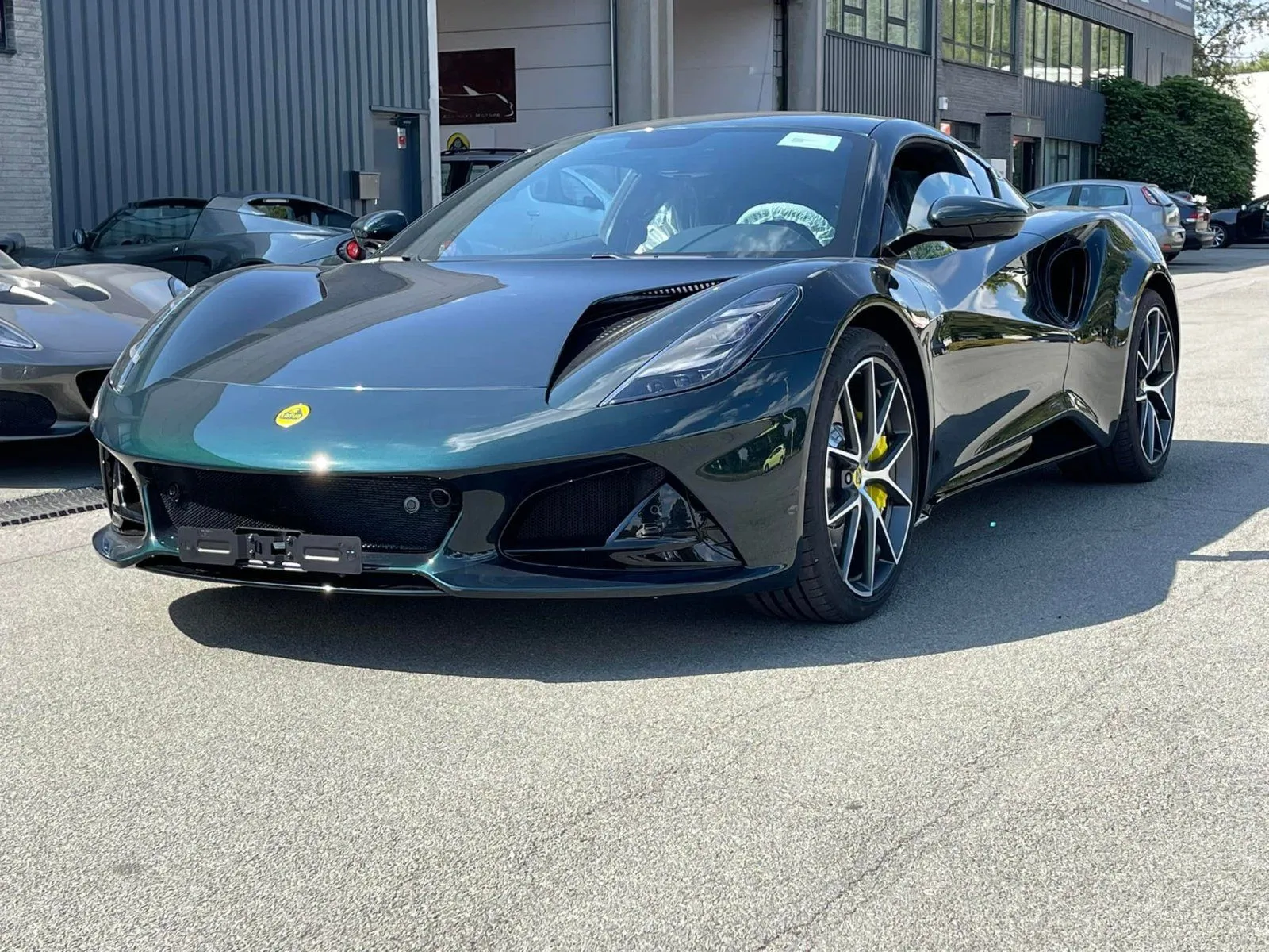

UK front plates are held with double-sided tape to the plate holder, so are easily removed. Taking off the plate holder, cutting it down and re-fitting it is a 30 minute job. I guess you might want to paint or tape the cut edge. The new plate hides the cut.
The mount (part that screws into the lower lip) is universal worldwide. The plate holders vary by region, so one from another region should be shorter. For previous E-cars you could order non-UK holders from your UK dealer or Deroure (Lotus parts).
Pic: Lotus Antwerp
