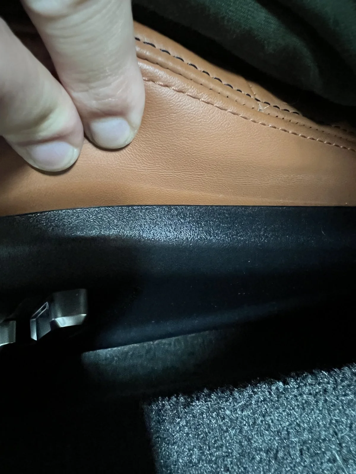

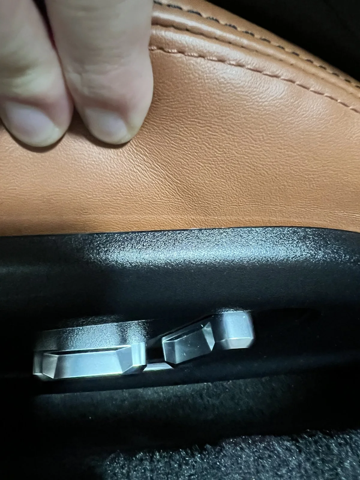

Driver seat issue
Link to The Metal House website. I used the smallest size 6mm x 3mm.
You used this one?
You used this one?
Yes. I already had some of this left over from a different application and it works well for protecting the seat leather where it contacts the hard plastic edge at the side of the seat. However it would probably benefit from some form of adhesive to hold it in place.
You used this one?
I used this one that I purchased on Amazon...worked perfectly.
My seats weren't marked but yall scared me into doing this. Thanks!

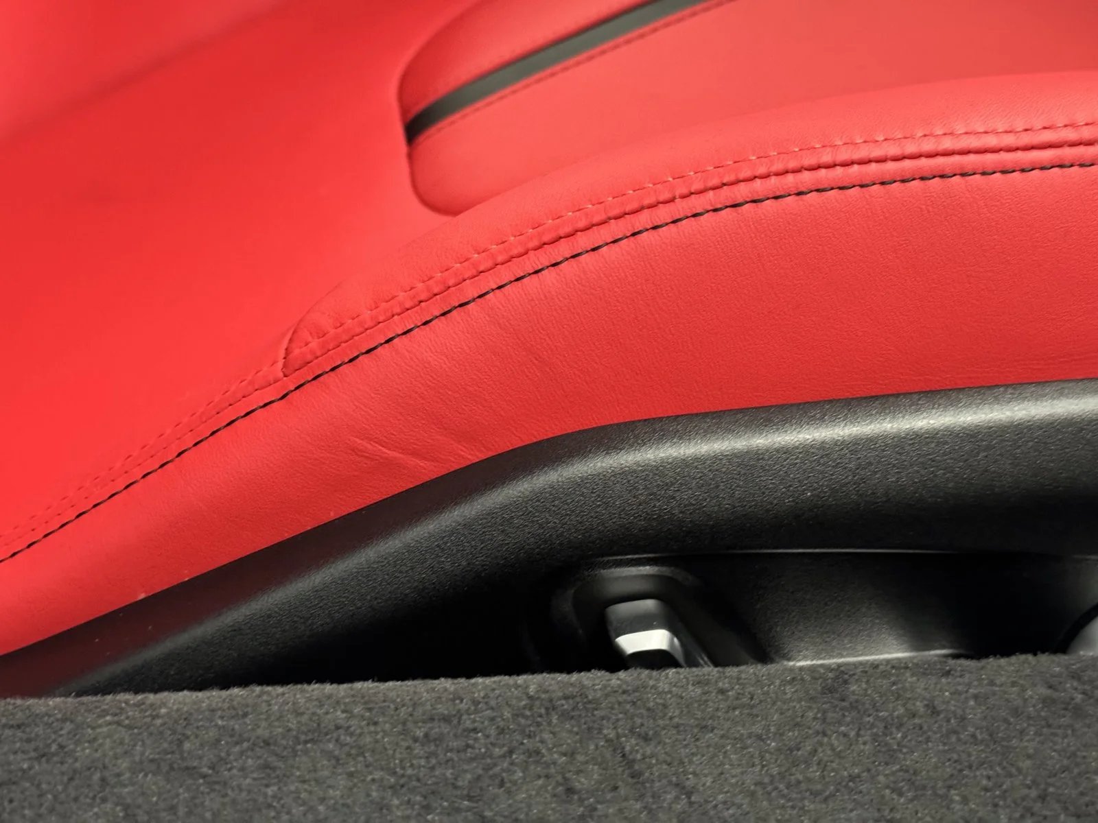

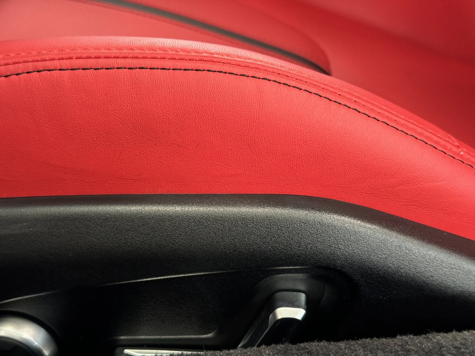

I posted earlier that both our seats at less than 500 miles were defaced by the plastic trim panel. My wife was the only one to sit in the seat, she weighs 135 and only sat in the car three times. The plastic trim actually cut through the surface of the leather on her side. Took it to dealer, he took picture sent it to Lotus. Waited for two weeks for an answer and finally got one: not covered.
That’s honestly insane. Ridiculous.
Hello everyone, I find this response unacceptable because many people have noticed it. this defect in the plastic material surely came from China because unfortunately lotus is Chinese now!!! the lotus customer lotus service is deplorable Philipe
@Cobra 427 where the part comes from had no bearing on it. QC in Hethel should have caught this and corrected it. And at the very least they should be correcting it now after the numerous complaints. All they need to do is deburr the seat edge. It's really quite sharp. But if it takes a class of complaints maybe that's what they'll finally respond to.
Thought I’d share my experience with everyone following this thread now that I got to see my car this week. The condition of the seats look way worse than I thought they’d be and this is before I sat in my car once. Even the side bolsters look like they have some wear from inconsiderate clowns getting in and out. Pointed this out to the gentleman handling my delivery but they basically said there’s nothing they can do and recommended I start a case with Lotus customer care or something….unacceptable frankly.
