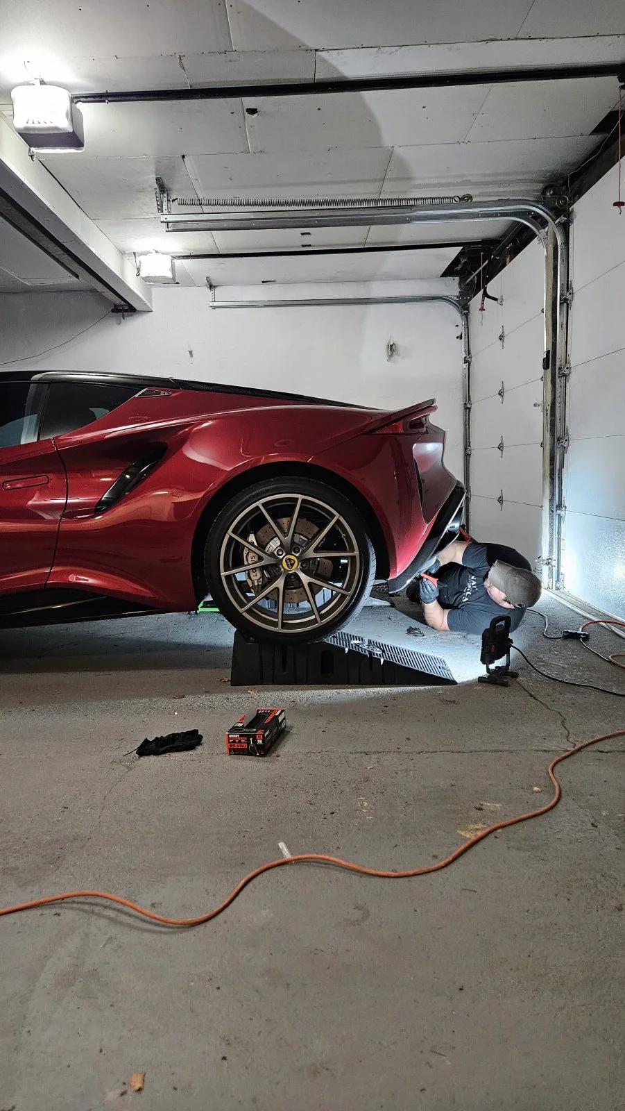

I installed a miltek 3rd cat delete and had a perfect pipe fit. The way I did mine was to take out the entire muffler. Much easier IMHO if you do not have a lift. The only steps that needed to be added was releasing the left side sway bar from the lower control arm and the sway bar brackets. This let me slide the entire muffler assembly out to easily remove and reinstall the new 3rd cat pipe.

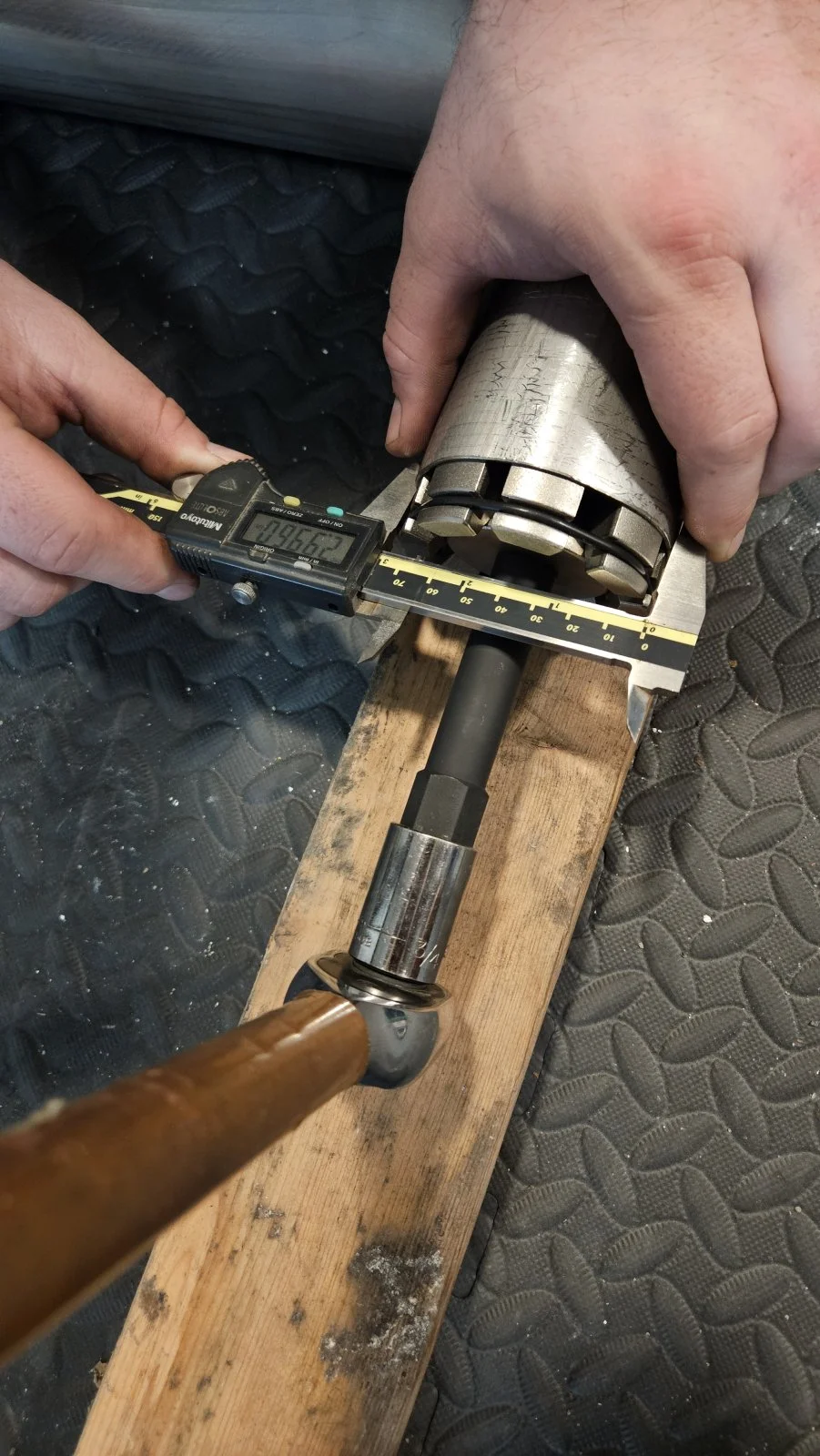

Thanks for the video and tips @Dragoon. Install went pretty quickly for us.. Minus a trip to Harbor Freight for a pipe expander. 🙄 All good though.. Everything is buttoned up and sounding mean!

I'm so glad the pipe expander wasn't a surprise! It's much easier to pivot to that solution when you know it might be an option you need beforehand.

I still can't figure why the expander has been necessary in some cases. When I installed my GRP pipe, it fit snugly and went in by hand without even needing the assistance of a tool and it tightened very firmly with the clamp. I can only imagine that the manufacturer of the GRP pipe made them with slight diameter variations, or the Emiras' exhaust pipes are not consistent in diameter specs themselves. Very strange.
I talked with GRP, and they said their pipes are set to a specific diameter. He seemed to think the muffler inlet pipe diameter is what fluctuates considerably between Emiras.

I just installed onto my car (I got it beginning of Aug) and I had to get a tail pipe expander to get it to fit tight enough. I think I spent more time on that portion and putting it all back together then on anything else! (and trying to zip tie the miltek controller to the bumper...ended up using double-sided sticky tape...I hope holds up.
