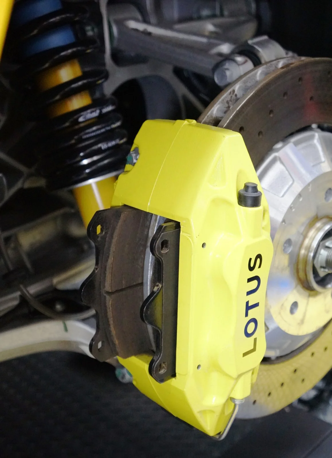

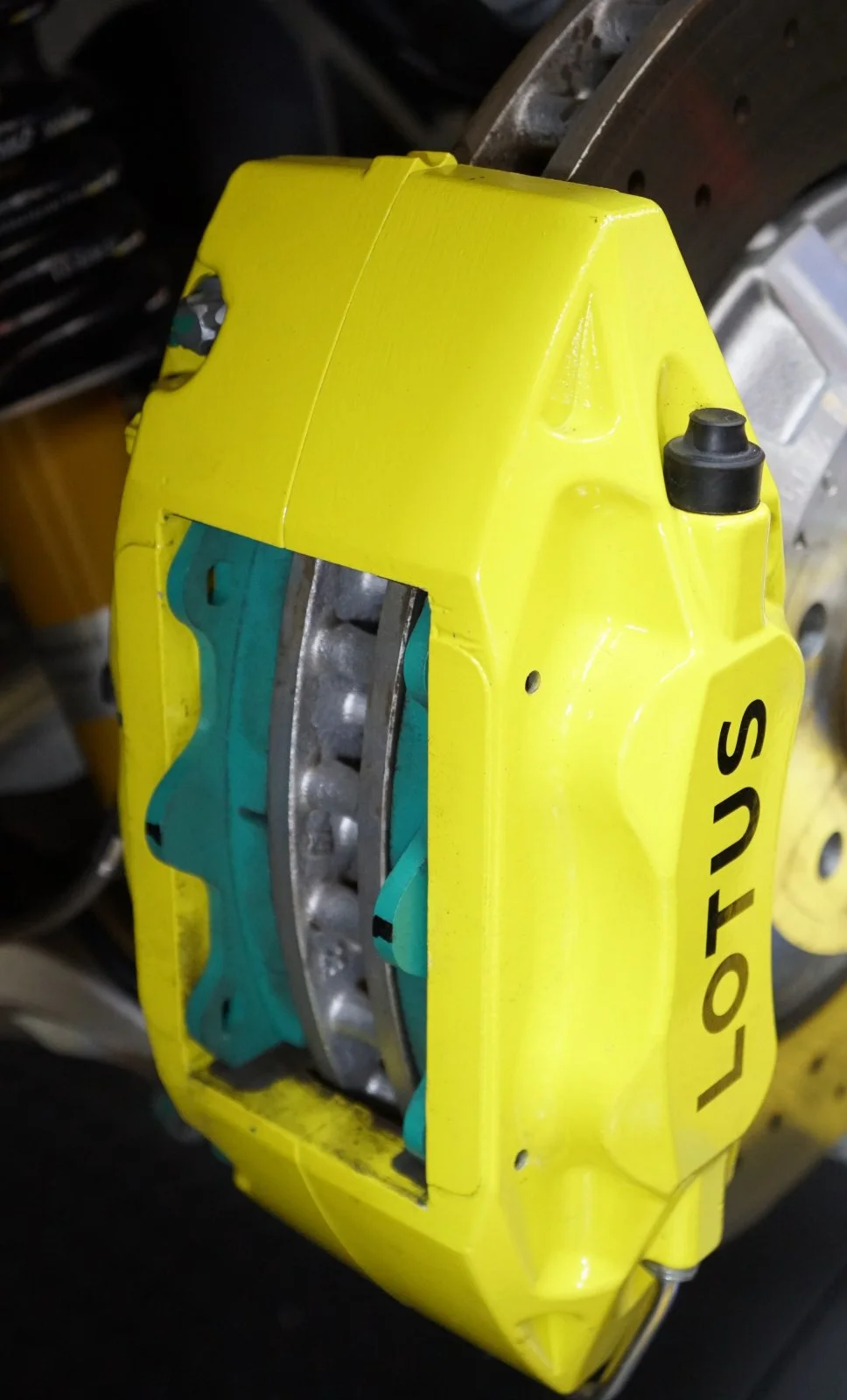

My EMIRA is an i4, and the front and rear brake pads on the V6 and i4 are the same size.

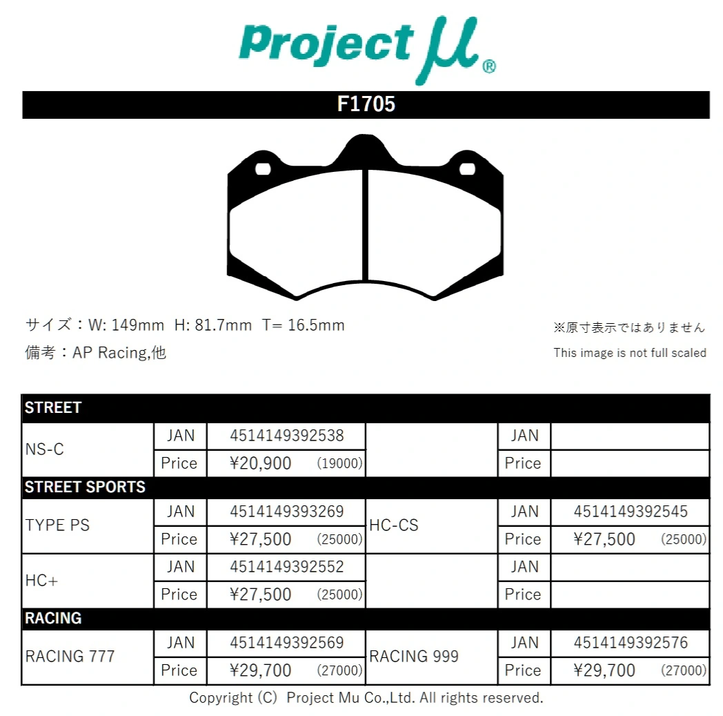

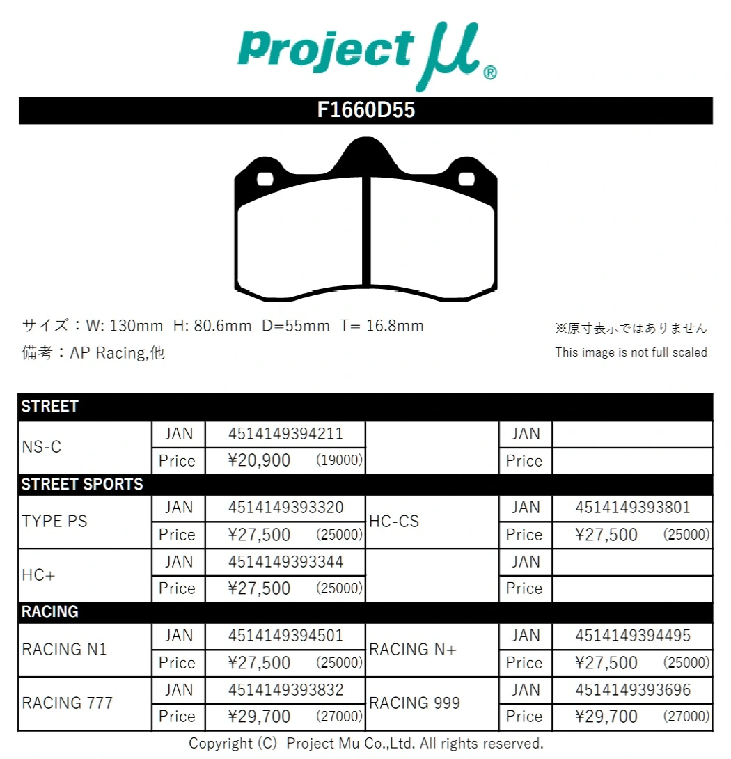

The brake pads I use are "project μ" street sports type low dust brake pads.
Since I don't drive on a circuit, I chose low dust brake pads to prevent my wheels from getting dirty.
"project μ" has good performance, is inexpensive, and is reliable.
I've only been using them for a few weeks, so I'm currently letting the brake pads break in, but there are no problems at all.
The brake pad information and part number are as follows:
※Same part number as EVORA/(400/410/GT410/GT430).
