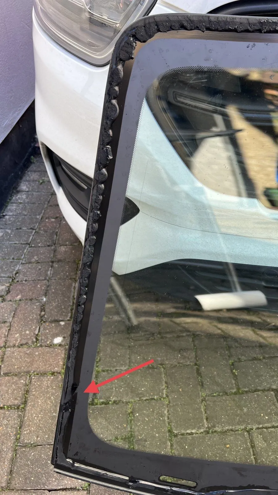

I noticed the inside of the windows fogging up today. A quick investigation found the driver’s footwell very soggy under the mat. Any suggestions as to where the water is coming in from?
I can’t believe the still do this my launch edition Evora has this issue - was coming in around window seal
There was an earlier post where someone had a cracked screen replaced and found a gap in the screen bonding/sealing bead, so there is some precedent on Emira here, top left corner if meneory serves.
That was me.
Bottom left. Could see water in the vin window.
Thankfully (!) got hit by a stone before anything consequential got inside.
