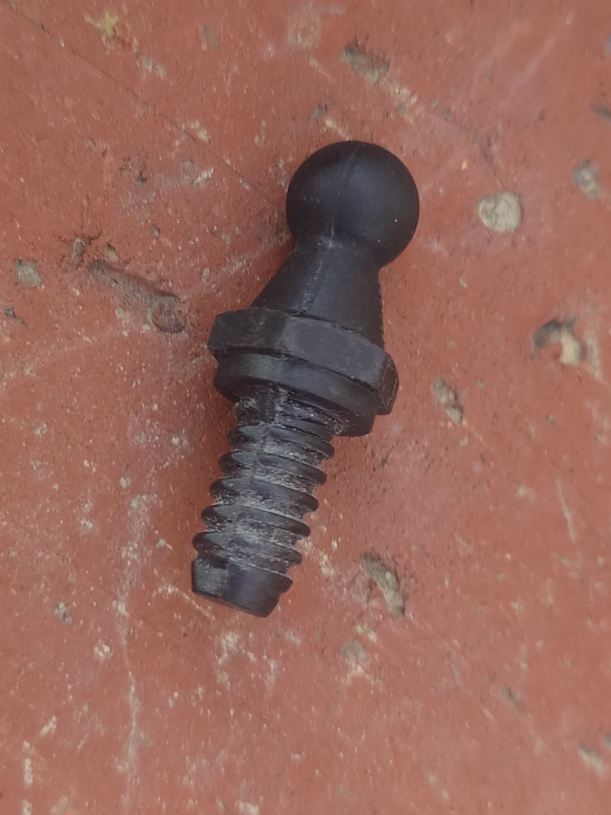

So I brilliantly lost one of the bolts for my engine cover while swapping on my CF one... Does anyone know the exact spec for them/where I can get one? TIA

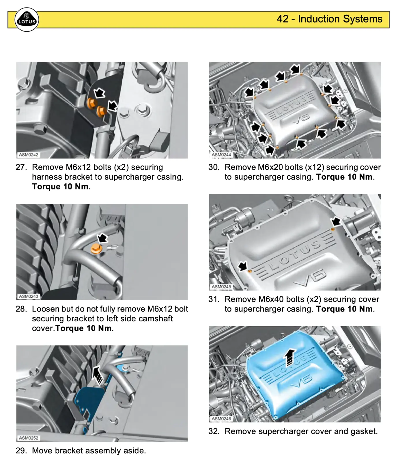

M6x20 outer ones (12) of them
M6x40 inner 2.
Torque 10 N*m
From service manual
Hopefully it didnt fall inside the supercharger. :eek: or down in the bay somewhere.
Doesnt really give the thread pitch if fine or coarse thread. Can remove another one and take to fastener place to match it.
  • #6

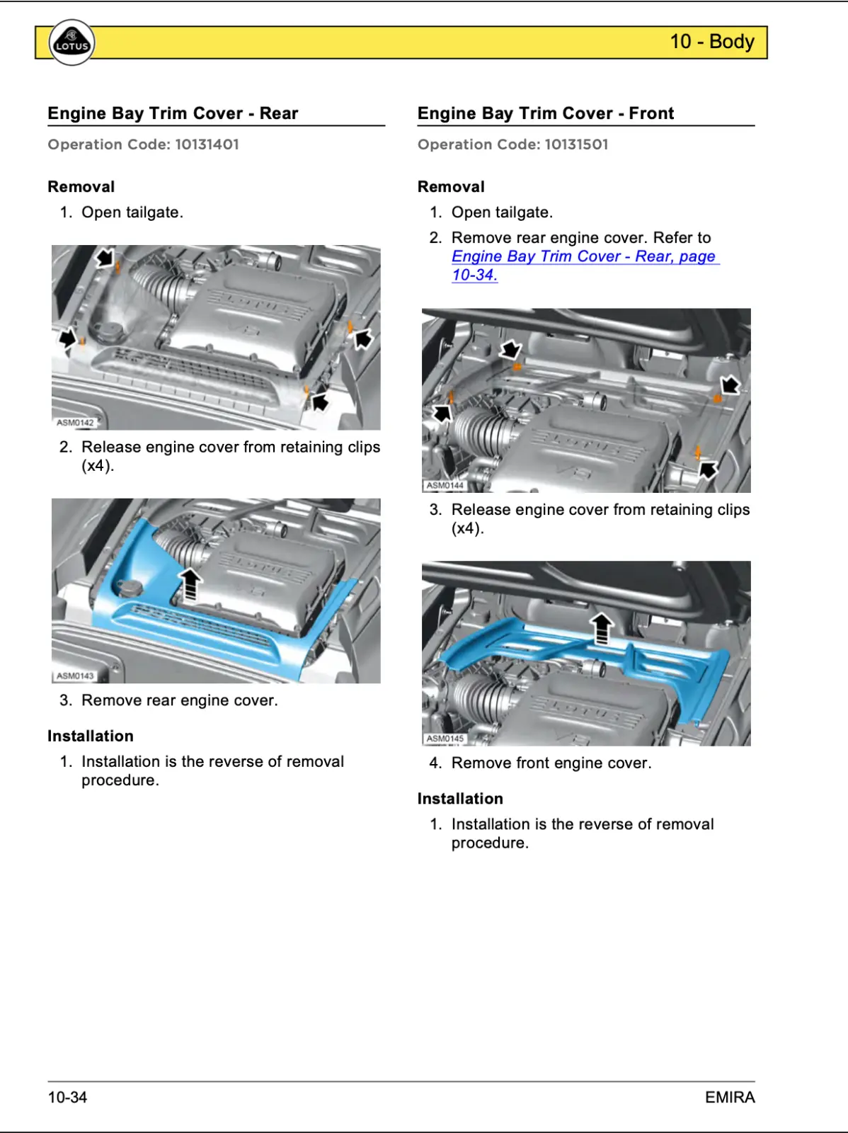

I meant the engine bay trim! LOL I'd be a lot more worried if it was actually the cover. Sorry for the confusion, but good info!
Sorry, new to the forum but where can I find information pages like these?

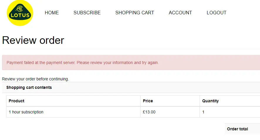

Was hoping to get this today myself. Has anyone had any issues recently with the Lotus Service site? I can't seem to get as far as the card payment page without getting this error.
Yes, I've also tried several times to subscribe and keep getting stuck with the very same frustrating message. Seems like the site doesn't even allow me to input my credit card information and I can't get beyond that page. I'm very curious to find out how other forum members have successfully subscribed and downloaded the manual. Can someone help us?.
