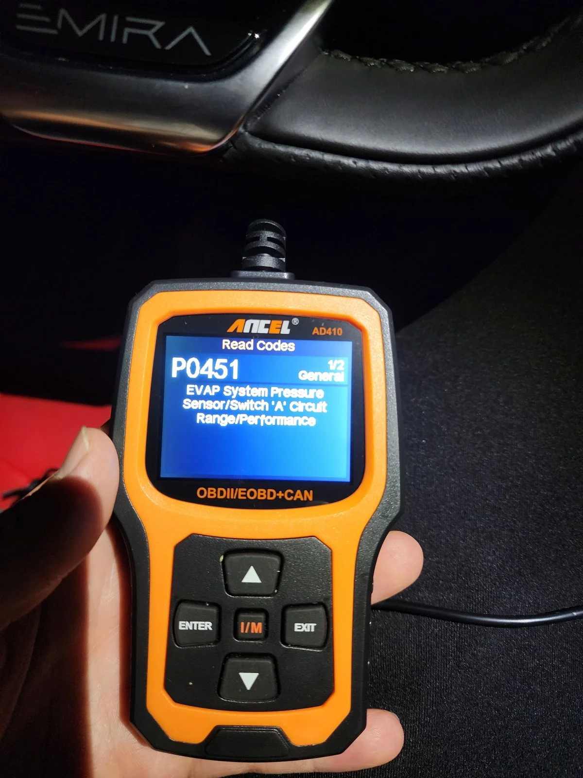

i have the same issue with my car. Code P0415 evap sensor CEL . I have installed eventuri Intake and 3rd cat delete with miltek sensor. If I have to take it to the dealer, should I put it back to stock before I put in for service? I'm just worried that after market parts would void any warranty.
Depends on if your dealer is one of the friendly or stick to the rules kind. Officially you'll at least put a "who is at fault" on the table if you keep it modified.
Various text from Lotus side suggest any modification will void all warranty - but this is gonna be hard to argue and actually put in action
I would err on the side of caution.
