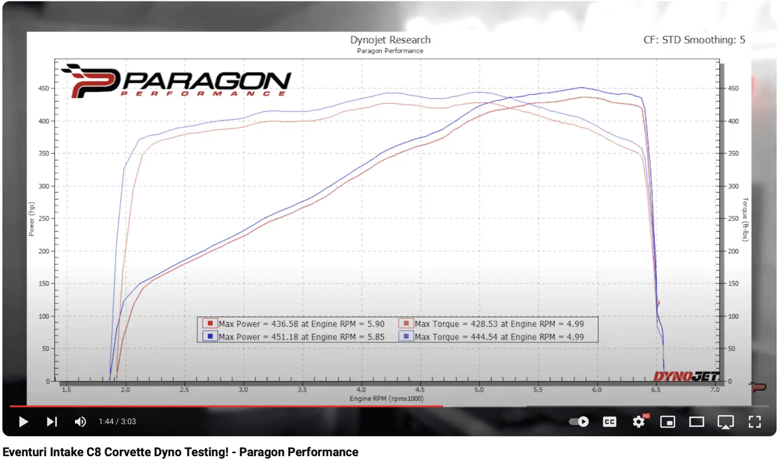

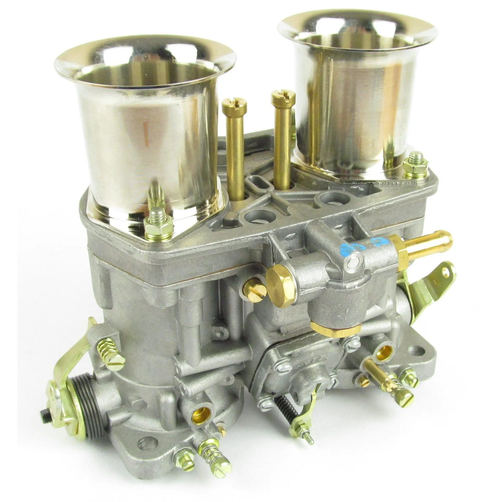

I took the time to look through their website, and also to look at videos of their products for other vehicles that were tested independently, and the performance gains are real. I understand the philosophy too, as it's been used for decades in intake and exhaust system designs. The venturi effect is to focus and improve the airflow so you get more air faster. I remember first seeing velocity intake bells on Weber carburetors way back when.
That effect is also behind the idea of long tube headers for exhaust systems, to smooth out and increase the airflow.
Air doesn't like to turn corners; it loses its velocity very quickly. Smoothing out the flow path and removing anything that would disrupt the airflow will make a noticeable difference in airflow and velocity. The intake valves are only open for a short amount of time, so being able to increase the amount of air that can make it in there before they close increases the compression, which increases the power.

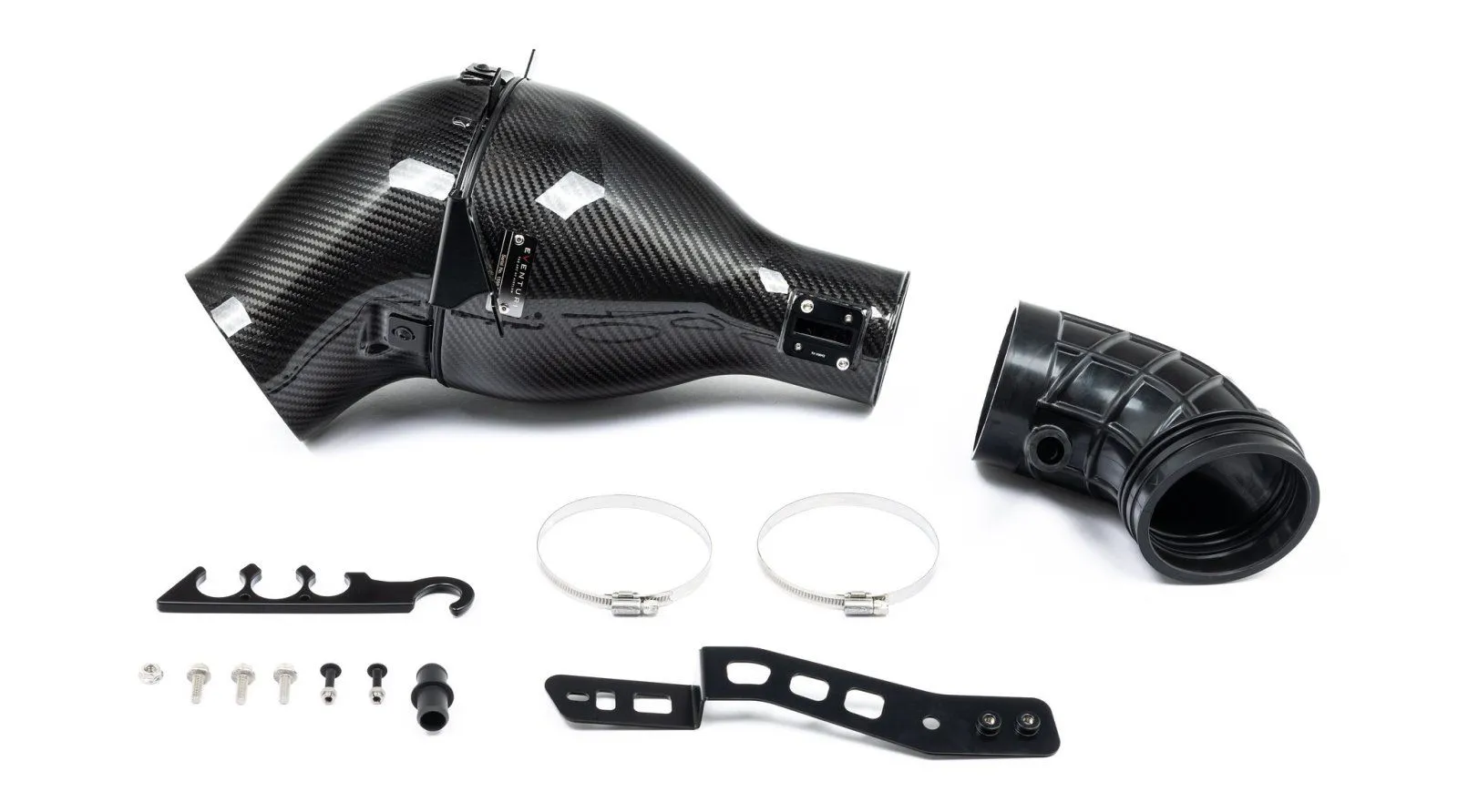

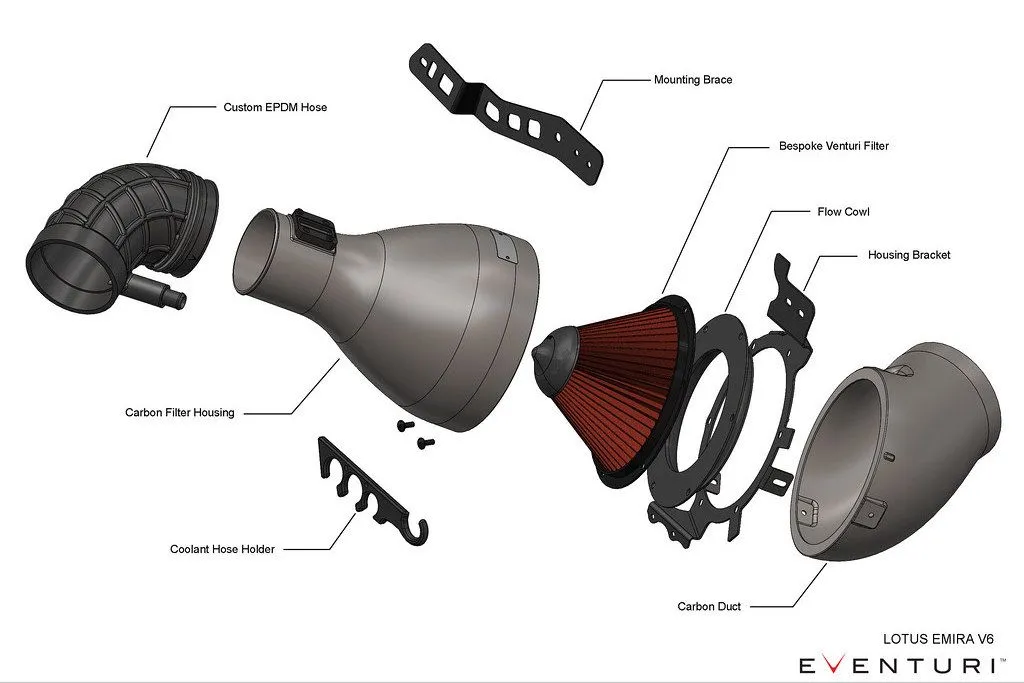

I've worked in manufacturing before, and the Eventuri intake is far from a "silly piece of overpriced plastic". The flexible EPDM hose alone would require an expensive manufacturing mold to be able to produce them. (Those molds can cost anywhere from $25k to $100k). The molding for the carbon fiber pieces which are high quality fabrications, would also require some expense to create.
The bracket connecting those two carbon fiber pieces is stainless steel; no rust concerns.

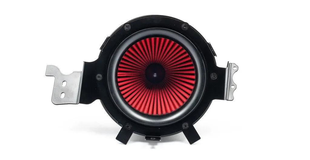

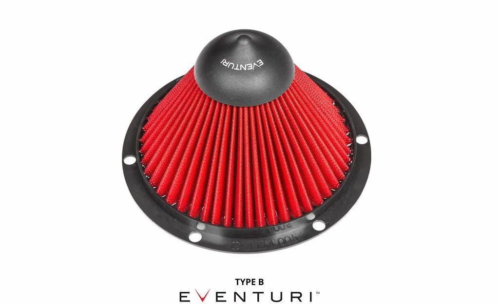

Then there's the filter itself.

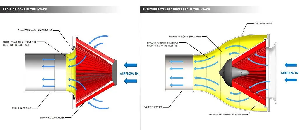

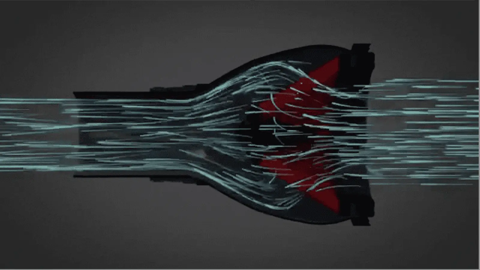

When you look at the airflow diagram, you can see how their intake smooths out the bends and makes for a less restrictive path for the air to flow through.
It also gains the venturi effect.
I don't work for them, nor have I purchased this (yet), but I appreciate the work and thought that went into it, and I don't feel it's at ALL fair to refer to it as a "silly piece of overpriced plastic".

If these aftermarket add ons were so great why wouldn’t we see high end manufacturers that are not price sensitive use something similar? Because for the most part any time an independent tester validates an aftermarket parts makers claims, they don’t work as advertised.
So all the pictures and airflow diagrams are neat to look at but don’t translate to actual results. Also air doesn’t care about channeling material. This could be made from molded abs plastic and perform identically to the overpriced carbon fiber
Until I see independent dyno comparison tests performed I’m going to continue to view aftermarket items like this with healthy skepticism

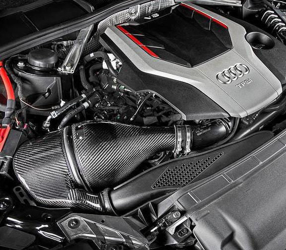

Well provided that Eventuri definitely has a unique (engineered) design element to them, their pricing isn't too crazy given that their equivalent intake for an Audi B9 S4/S5 is the same price as the Lotus one.
Personally I could never justify the pricing for my Audi, but for the Lotus it's a much higher caliper car...
