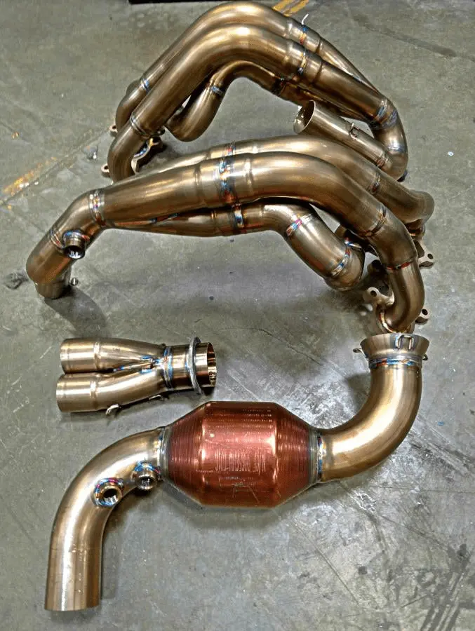

Will you be able to pass CA smog with he BOE headers and cat pipe? Won't it need a tune for that?
You will pass ecu readiness check but might fail visual if they remove the engine cover. Either way we don’t have to worry about that for 8 years. You’d likely pass a sniff test too but they stopped doing those for newer cars in California. Should run fine without a tune.
My primary motivation here from the mods listed are making sure I can track the car and preserving the stock parts. I don’t want to melt the oem cats on the car with track time or damage the stock wheels plus i’m not going to be running OEM tires.
Hi Kitkat, if you do the headers will you have to map it to stop faults coming up?
Nope, pre and post cat oxygen sensors will remain on the car, they just need the cables extended likely, will pass readiness monitors just fine.

Technically the BOE replaces the third cat with a low cell count cat -- so I'd be keeping A cat in the same position, just not the oem cat.

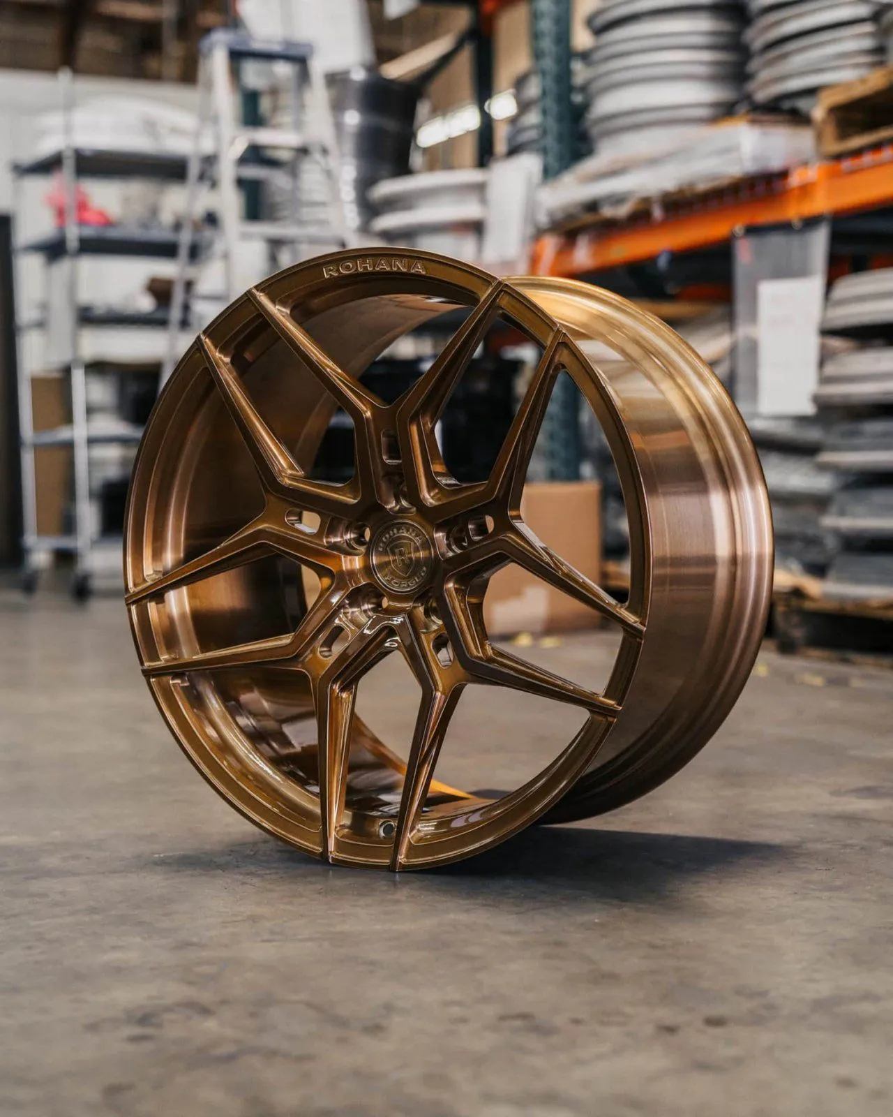

I’m looking at doing these bronze gold on my shadow gray. It will pop nicely. Unfortunately they don’t have them in the size of the Emira and so it would have to be a custom order which will cost a LOT more and take over 10 weeks. Do you guys know of another brand of wheels with the same finish that’s ready to go for the emira?
Thanks
Thanks
We can have wheels ready in about 5 weeks, same color.
Shoot us an email if interested!
