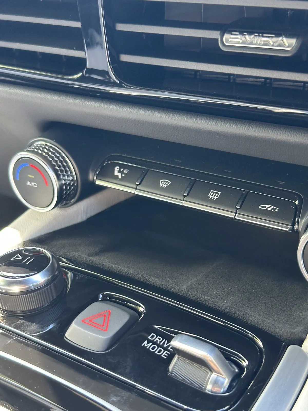

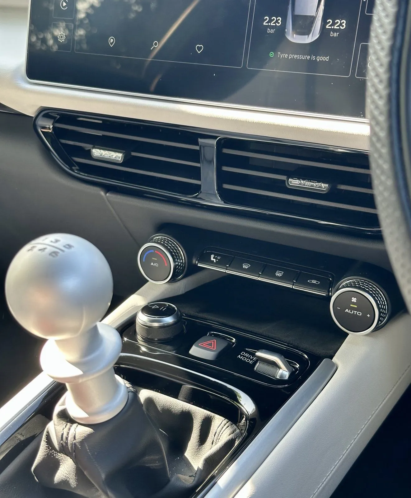

Feeding cable from USB socket to trinket tray

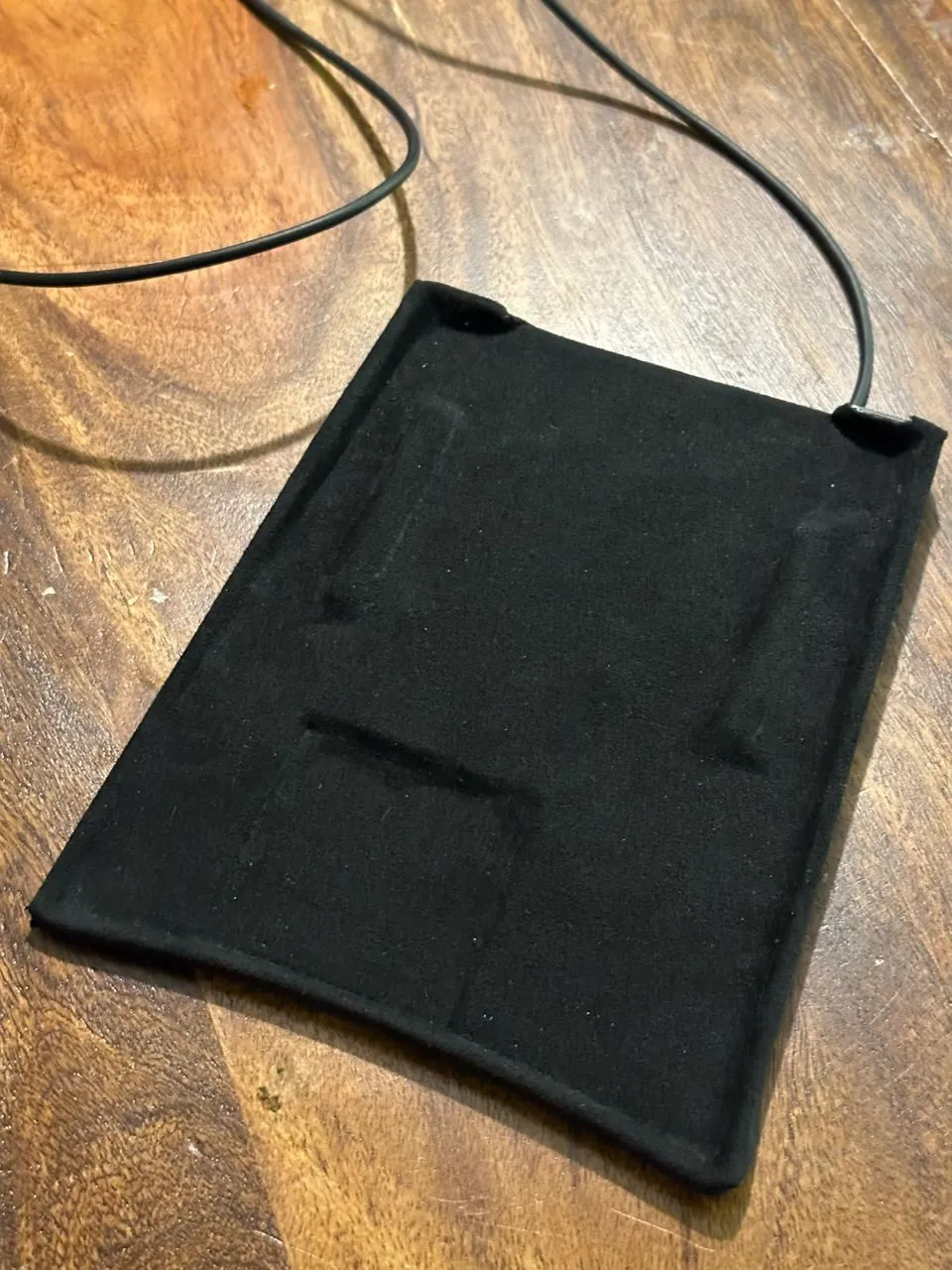

3D printed Alcantara wrapped tray for iPhone 14. , Just installed it, fit is perfect. Will post pics later when there’s daylight.

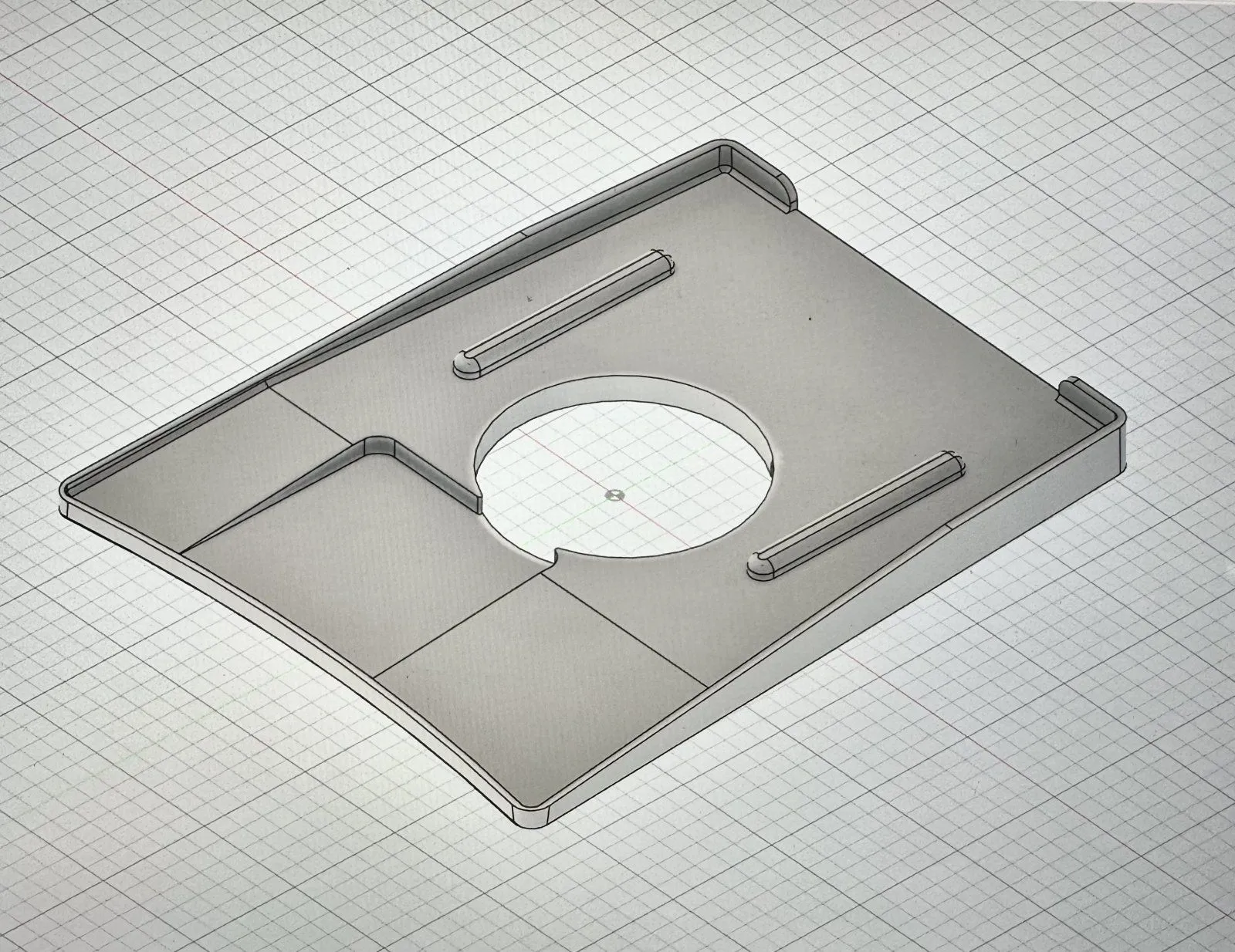

Designed my own in the end - I wanted a lip at the front and some side support for when I’m pulling some Gs in the corners :D
that's awesome, are you willing to share the stl?
Printed in PLA+, I wouldn’t use straight PLA as it’ll deform as car gets hot in the sun. ABS would be better.
Wrapped in genuine Alcantara which is surprisingly expensive even for a small cut. I used double sided carpet tape which works well enough.
Fits my iPhone 14 with a slim case perfectly. A slightly thicker case should be fine too.
DM me with your email if you’d like the stl, it’s not possible to post it here as an attachment.

it does completely replace the tray. I bought a reel of TPU to try this, but in the end was happy with the result with PLA+ and Alcantara.
I might still print the TPU version, the advantage of TPU is you can have higher sides like the OEM part which you then need to fold in to be able to push it past the buttons into the space. With a hard material you have to keep it shallow otherwise it won't get past the buttons.

Could I simply plug an Apple Magsafe charger (using a USBC to USBA adaptor) into the USB outlet under the gear lever? And if not then would anyone like to make a tray replacement for me to accommodate my case too (I use a leather folio case)? Happy to pay for it obviously.

The Emira usb plug in that underneath location needs to be swapped, or the supply end of the USB-C cable routed elsewhere.
