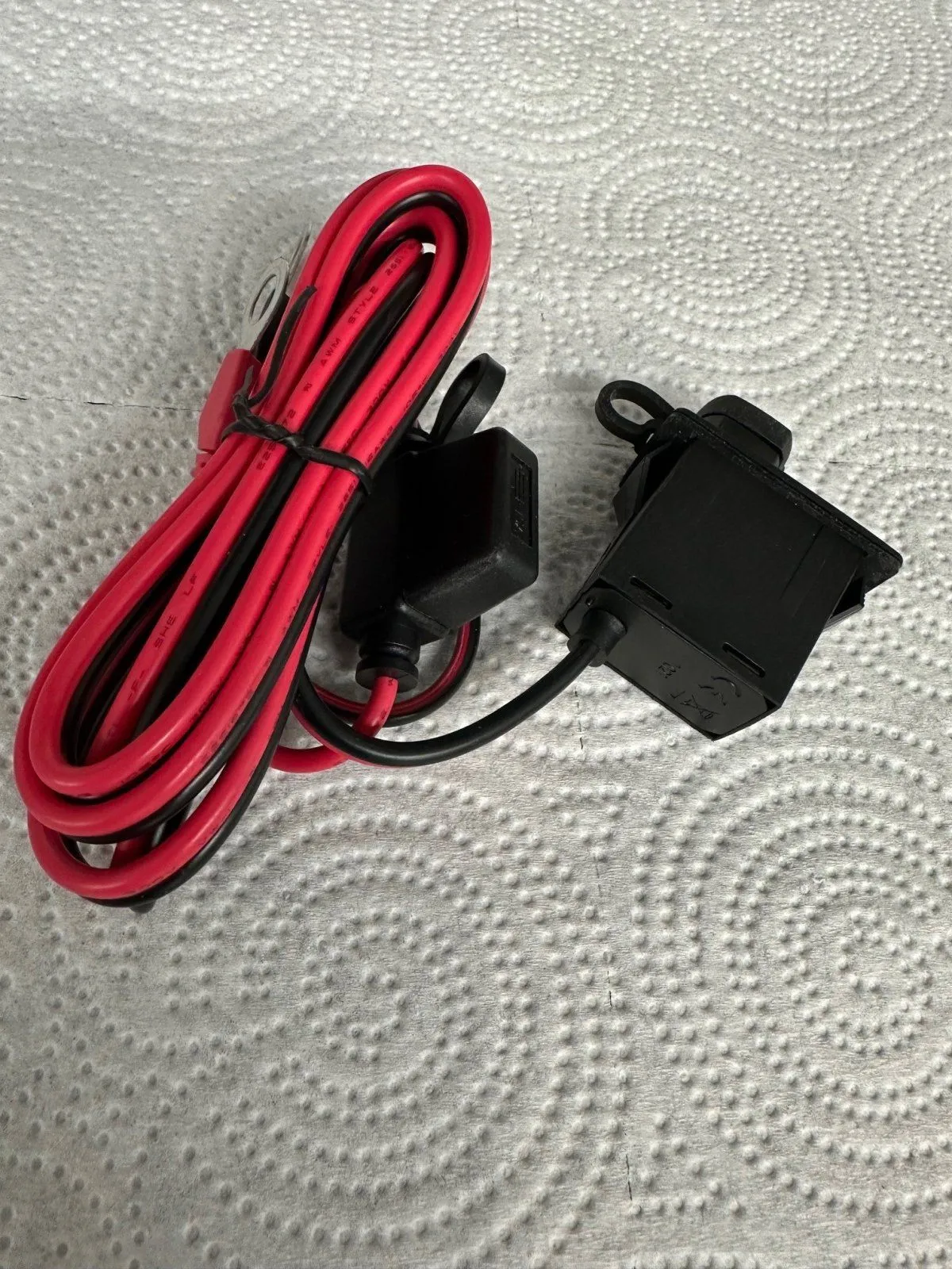

Curious to see pics of the back (Amazon only shows front). I might order one for my tractor to test out and see if it's a clean enough DIY for the Emira. It would look slick sitting flush on the battery cover or trunk liner with nothing dangling about.
That's the one, except without two meters of wire attached. So I think I need to get my own terminals and wire it up. Should be easy enough.
The plan is to attach it close enough to the battery door if not on it.

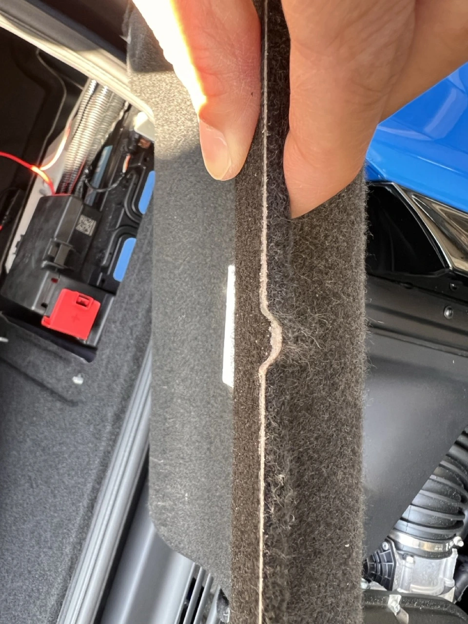

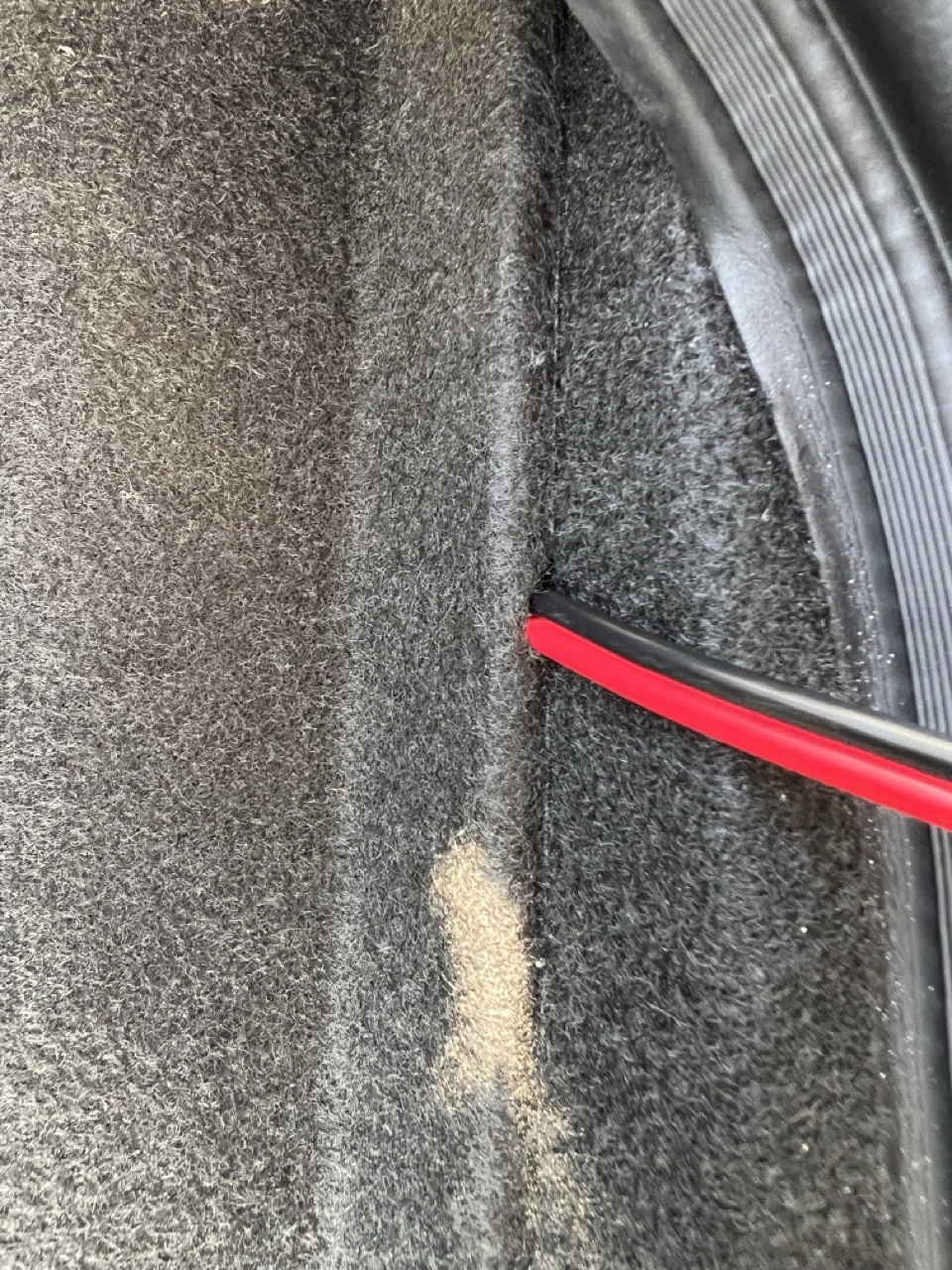

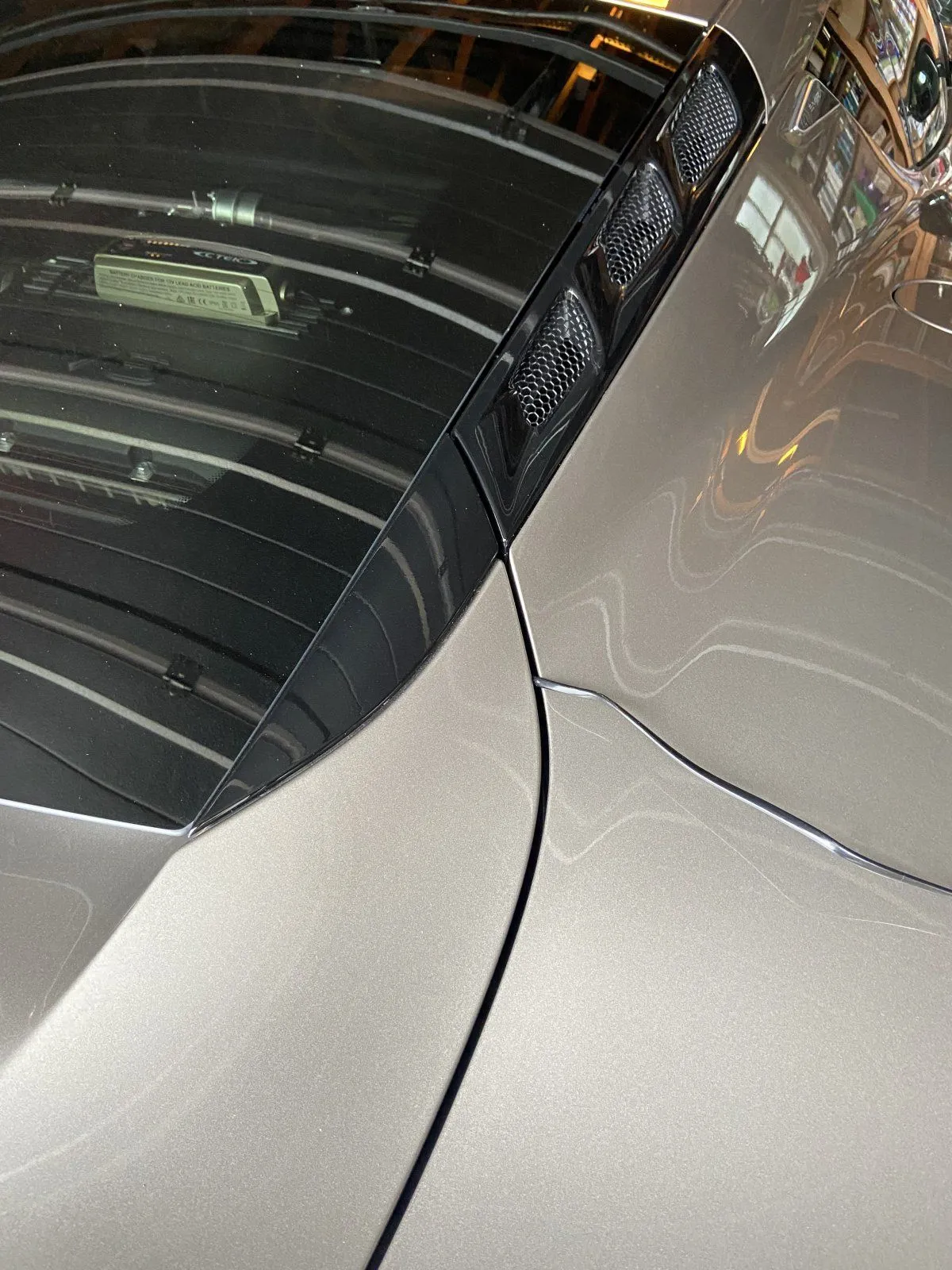

On an Emira, how is everyone fishing the wire from the battery to the outside of the car, to the trickle charger unit? My Evora's hatch panel gaps were pretty poor and left a big enough gap to run the wire out between the hatch and the quarter panel, but my Emira's gaps are much tighter, leaving no room to do it. Any ideas would be welcome!
I've found there is enough space at the side of the hatch to feed the power cable out.

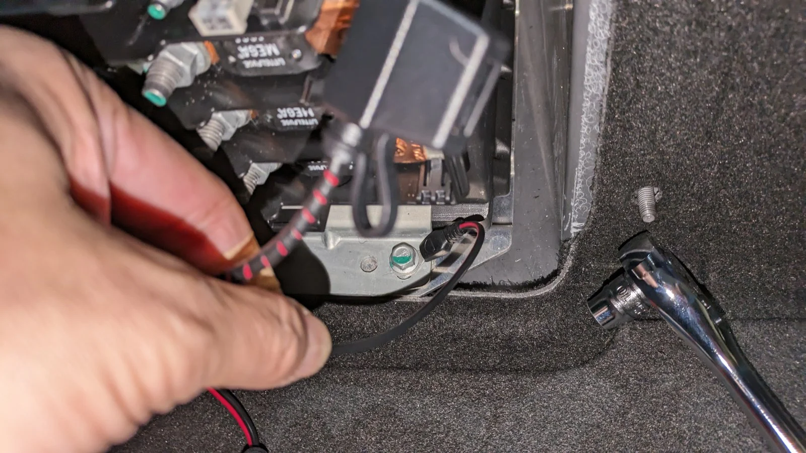

The positive terminal can stay where it's at. You'll need to find a negative attachment point that's direct to the chassis of the car. I'm curious if the two screws at the bottom of the battery tray are attached to the metal chassis. You can check with a meter. If they are attached directly to a metal part of the body, one of the two screws would be a good spot.
Old thread I know @Nova but has anyone confirmed that one of those two screws at the bottom of the battery tray works for the negative attachment point? If not, any other suggestions? Because I'm not seeing any other easy alternatives to the going straight to the negative battery post. I honestly don't want to be throwing codes, or creating a potentially dangerous situation so I'm approaching this very carefully.

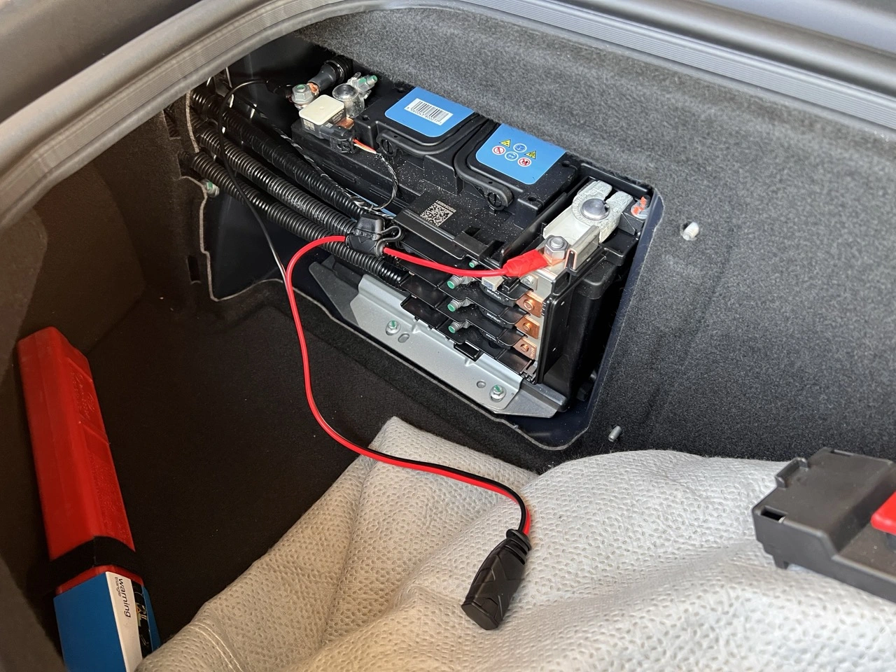

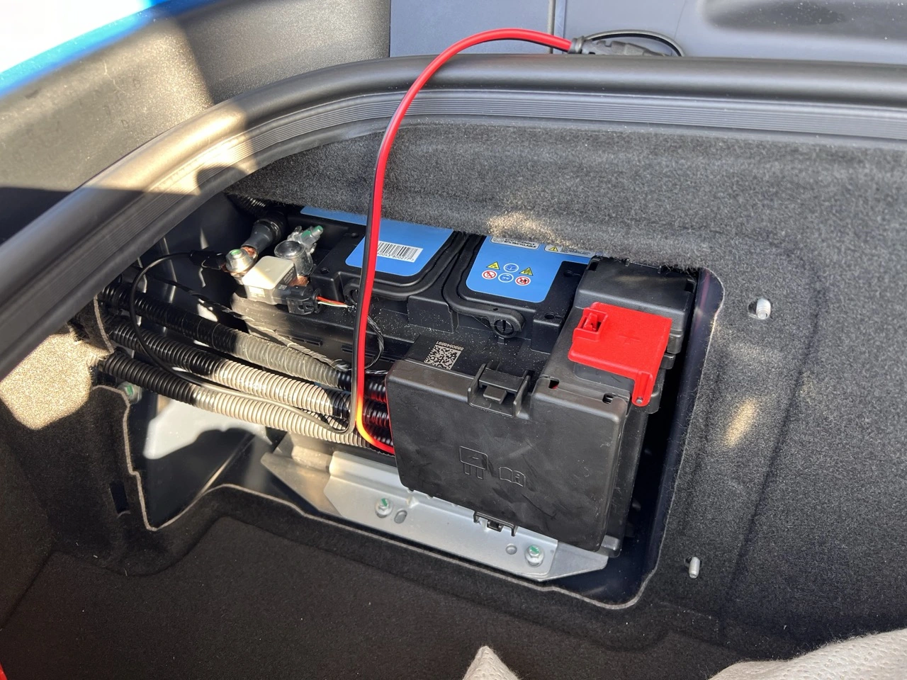

Thanks all for the do and don't from the previous thread.
Hope the following info can help other to install. Happy charing !! ;)
I've modified the battery cover case to create more space for the wire and connected with "NOCO GC008 X-Connect M10 XL Eyelet Terminal Accessory Genius Smart Battery Chargers" to the "NOCO GENIUS1, 1A Smart Car Battery Charger"

That's basically exactly what I did.. I got the larger eyelets and they worked after connecting them to the battery. I will have to make that NOTCH out of the battery cover.. Thanks for showing that. Nicely done!
