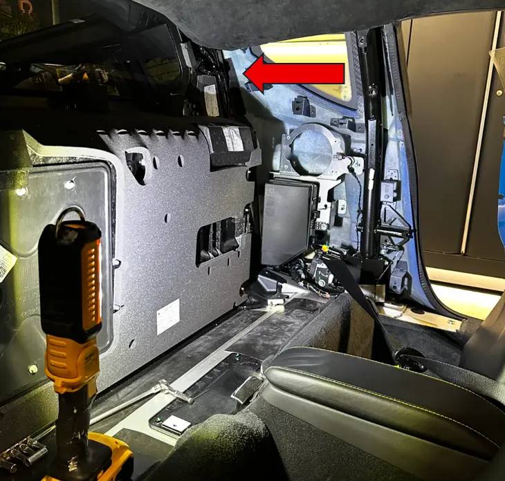

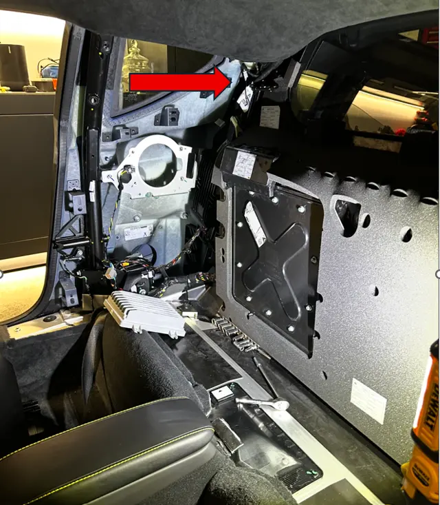

For those asking the question, there are two telemetric ariels in the car, one on the rear-left "C" pillar and one on the rear-right "C" pillar. Please excuse the photos, I went digging through my old pictures and below is the best I have:
