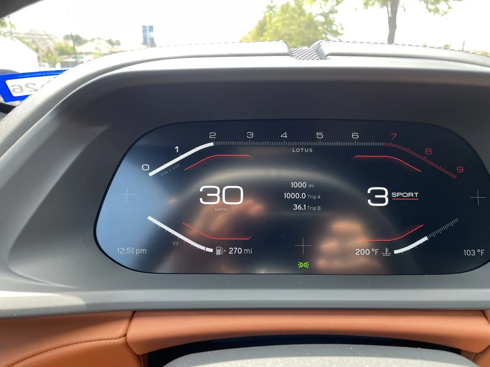

Just drove the car home last night and when stopping the whole electric system shutdown, dark, nothing working. Has anyone heard of this issue? Nothing has power.

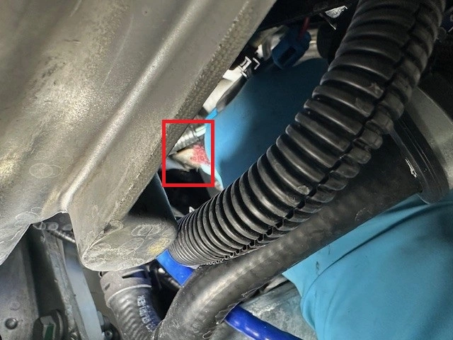

Checked the battery and is fine. The car was driving fine and when I stopped everything went dark, full electrical failure just like if the battery was not even connected. No idea how is that even possible. Just like unplugging a cord from the outlet. No warning or issues whatsoever prior to shutting off.Either a total battery failure, or one of the battery terminal connectors came loose.
Fuses? Battery fuse box is right on the front of the battery.Checked the battery and is fine. The car was driving fine and when I stopped everything went dark, full electrical failure just like if the battery was not even connected. No idea how is that even possible. Just like unplugging a cord from the outlet. No warning or issues whatsoever prior to shutting off.
