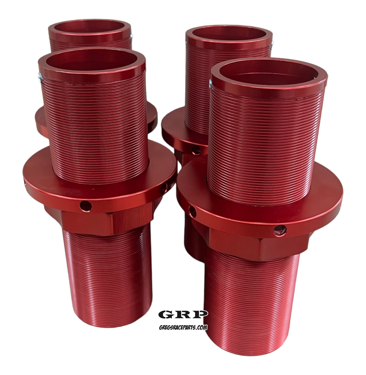

Some folks have installed them on Evoras with good results. They do what they're advertised to do, but it is a good bit of work to disassemble the strut/spring assembly to install the lowering cups. Some opt to just go with aftermarket coilovers since they're easier to swap and dial in without having to use spring compressors and a vice to take apart the stock stuff.

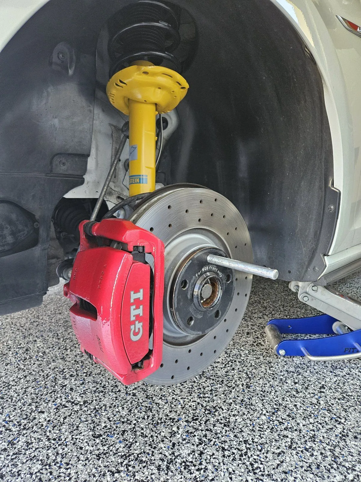

I actually installed Bilstein B8s and Eibach Pro springs (very similar to the factory Emira set up) on my daily driver MK7 GTI. It's very doable, but can be a lot of work for the average DIY mechanic. One plus to the Lotus double wishbone set up is that everything an be done from the wheel well, without having to deal with threading bolts up through top strut mounts.

There are a handful of Emira's with these installed so far, CT Carbon just installed a set on a youtubers car in the UK this weekend so I am sure there will be a video circulating here soon of that.
There was another customer who is on the forums but I dont know his handle - His is in the UAE with a yellow one (pictured on our site).
We will be installing a set on our shop car and another local Emira later this week. When doing so we will do as kuch documentation as possible and create a new how-to guide for them.
The install isnt super difficult but does require a few items like a shop vise/workbench to be able to get the eyelet off the shock shaft so keep that in mind.
First time capable DIY'r should budget about 3-4 hours for install. Having done them by myself prior I can do a set in about 2 hours now.
The install process is the exact same as the lowering cups mentioned in this thread.

The beauty of the adjustable cups though is that if you slam it and you get concerned about scraping you can just readjust them and bring them up to closer to factory height.
